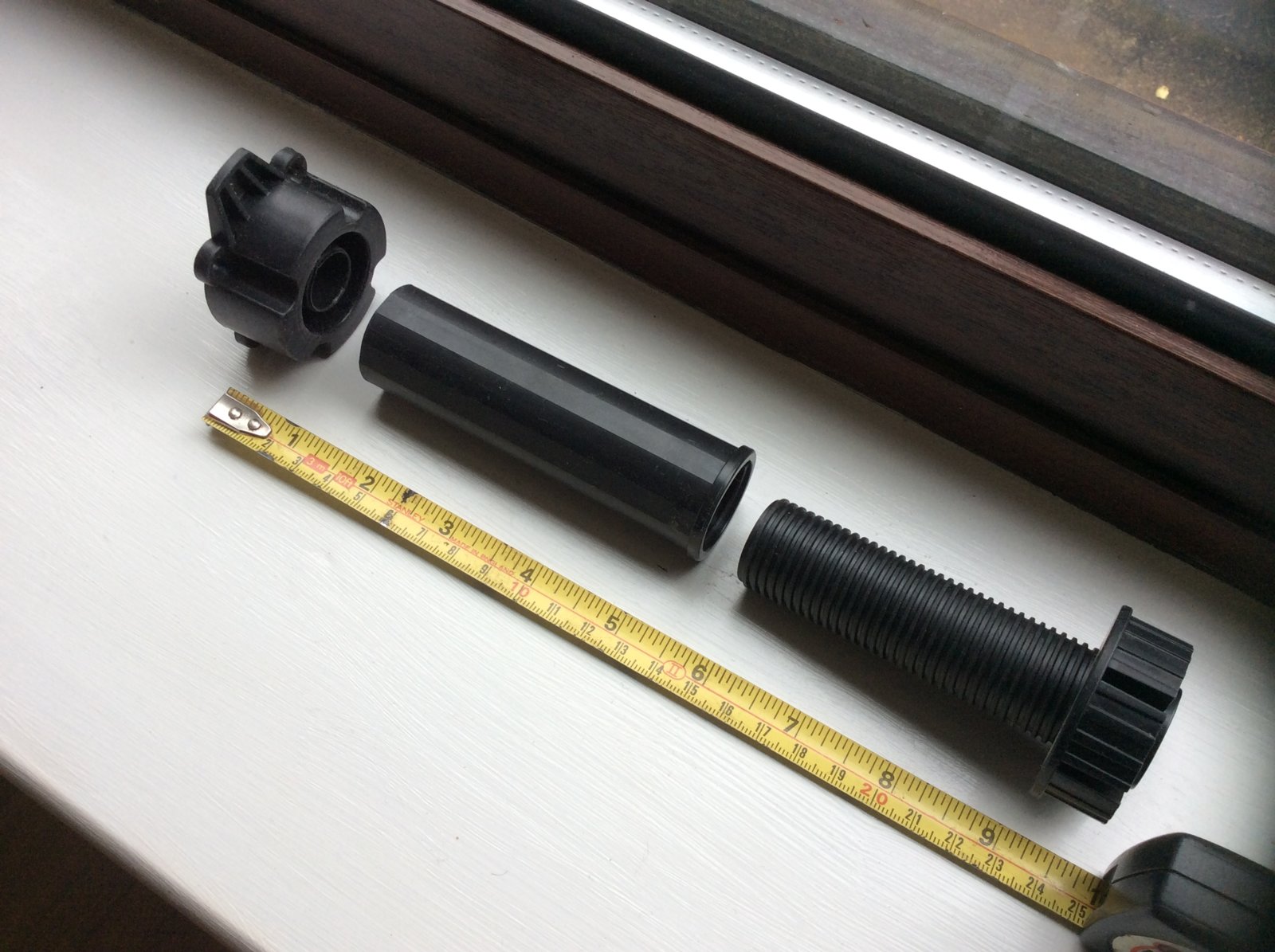

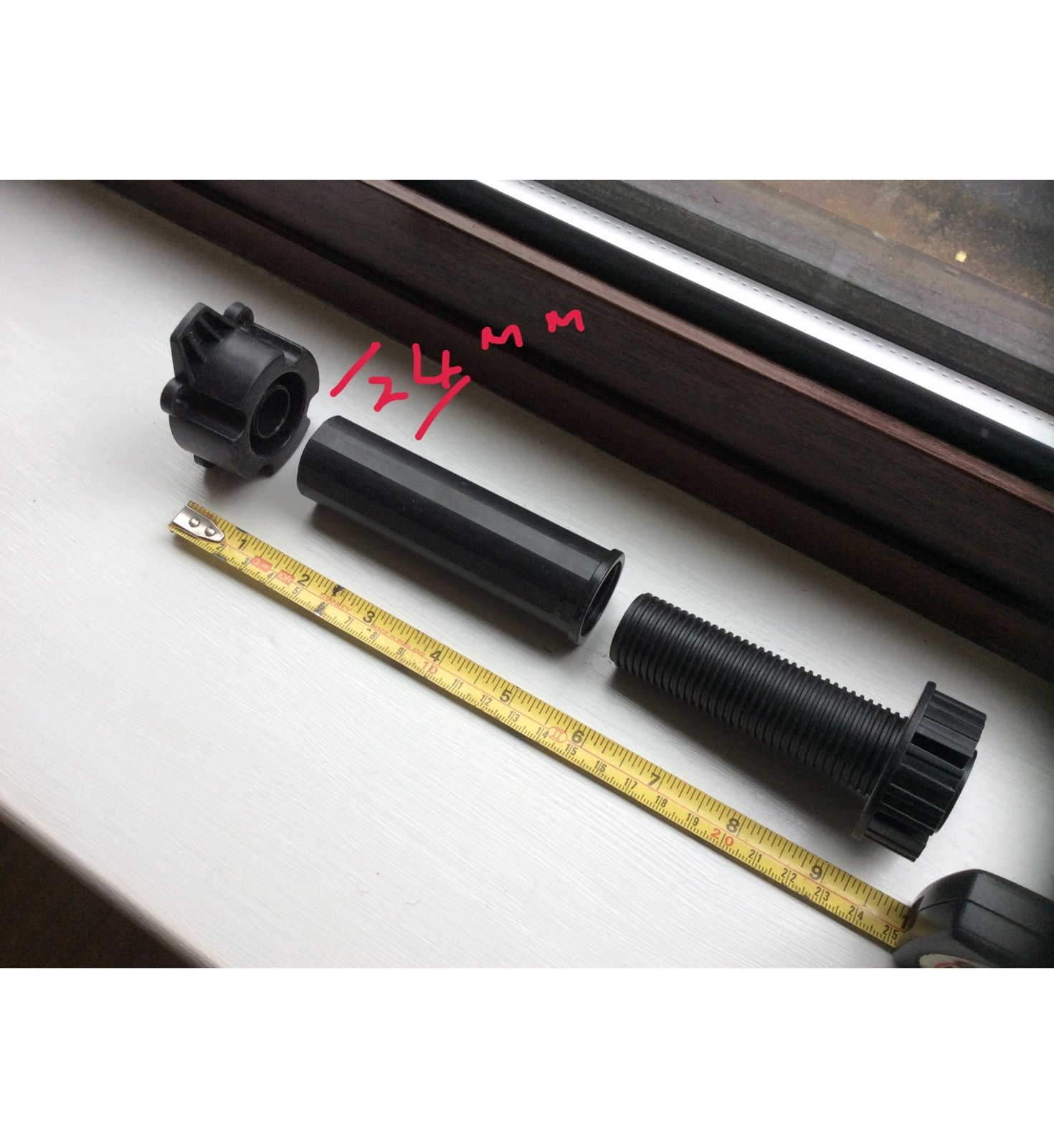

85E6497F-0CC3-477C-A38C-FD9C682241ED.jpeg Orange shed one can very easily be modified?
Those are the ones I have used before and, while not measuring specifically, they had a decent amount of adjustment.
When fully wound in the leg measures 130mm, it can then be shortened a further 24mm by sawing the outer part which doesnt involve cutting the threaded section .
A futher reduction is possible after this by cutting both parts which I would estimated to be another 50mm.
Edit: maximum extended length around 195mm so a 65mm range of adjustment .
