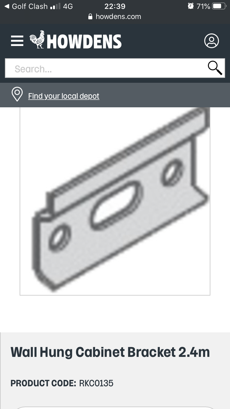

I found Howdens do a 2.4mtr one (y)
that's handy. What price?
I think the stocked size depends on the delivery van contract, and maximum parcel size.
With a longer piece you have more chance of avoiding a join in an inconvenient place, which would be weak point. My kitchen is 2600 wide.
