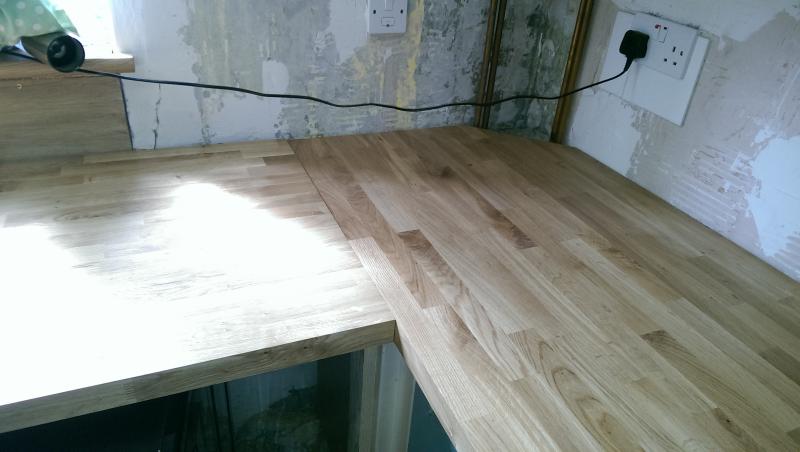

Remember that you'll still need to pull the joints together. I'd suggest putting a groove in either side of the joint (router groover or biscuit joint set) and using something like a loose plywood tongue or loose biscuits to locate vertically, sealing the edge with a small amount of clear silicone and then pulling the joint together with standard worktop dog and bone joiners.

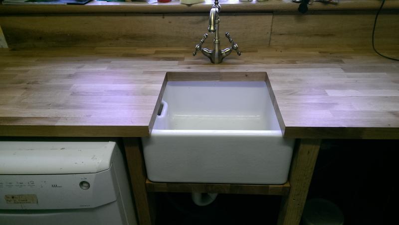

Could i make a jig for sink cutout i wonder? I'm guessing two guide rails screwed onto underside of worktop. Or am i way off there
Not a million miles. As you already have a circular saw I'd revise my statement above; set-out the cut-out on the underside, rout-out the drip groove set-in a little way from the edge using a small core box bit or a small straight bit (see drawing below), drill-out the corners, make the saw cuts in from the edge to the corners with the circular saw slightly oversize so you leave a millimetre or two to trim back, make the back cut-out (corner to corner) with the jigsaw and a fresh coarse blade being very careful that you watch for blade deflection and keep to the line and finish into the corners with a hand saw. Lastly fix your jig the underside and trim the edges with the router. All the jig is in reality is pieces of 2 x 1 planed softwood pinned in place (being underneath the damage will be hidden when you install)
I have no idea how to do grooves, and would welcome any tips, can i buy jig for this?.
Best bought-in. Needs to be packed up a few millimetres at the far end (away from the cut-out) so that you get fall towards the sink. Use with a plunge router, 30mm guide bush and appropriate sized core box bit. The jigs I've pointed to are about the cheapest out there - they are effectively "one shot" but for the more durable ones you are at £100
Drip groove? I have no idea what that is, could you clarify please.

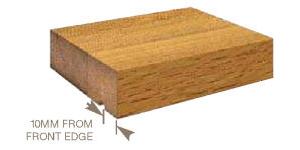

A drip groove is a small groove on the underside of a timber overhang, near to the edge, which stops water running underneath. It helps prevent rotting. Most often noticed on window sills:
Note that the use of a drip groove means that you need to have an overhand of circa 20 to 25mm over the sink opening. It's also a good idea to have a drip groove running beneath the front edge of the worktop - this is actually done on some better quality commercially available llaminate worktops such as the Duropal ones

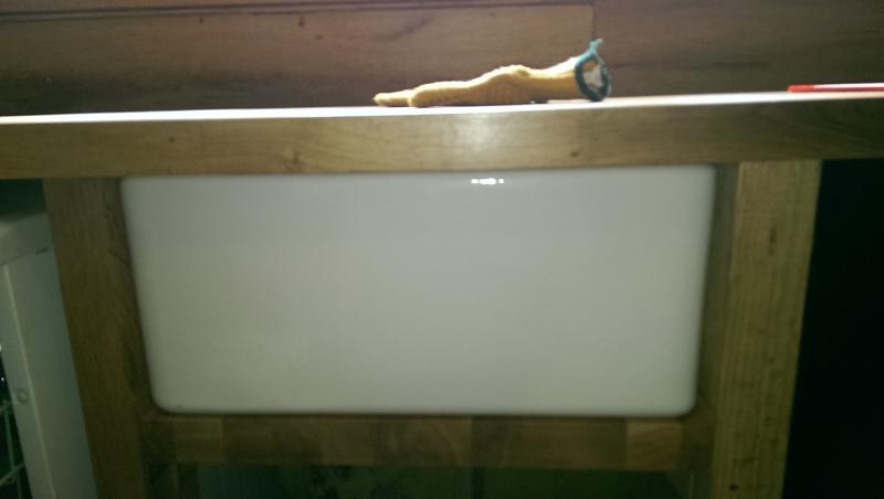

My last problem, i think, is how to deal with the sink. I would love big chunky wood underneath supporting it on show, i know it is more work and expense but was always going to be an issue. Or could knock something up and close the doors.
It is a small butler sink, but very heavy, so will need something solid in either case. Not sure wether to have side of sink open or in worktop? Hope that makes sense.

Oh my, thats a beaut. If i can get it looking anything like that i be a happy man, so will the wife. I have the problem that its a double cupboard and sink is in middle. But love the idea of using an ofcut underneath, that would give the look, with front of sink showing yet hide pipes, if i can manage to cut the cupboards.

The drip groove (on the underside) is normally very small, say 3.2mm core box cutter or even a small straight cutter - the drainer grooves are 12.7mm or so, as you say.
You can buy Belfast sink bases from kitchen manufacturers, but if re-using an old sink they won't always work, so Ive always made my own. The visible portion of worktop beneath the sink doesn't need to extend to the back, either - that bit can be supported on treated softwood if need be

Drip groove should be fine, i have some smaller 1/4 bits i will dig out. Im guessing the drip grooves will definatly need to be well oiled as will the cut sides. Is there a chance of clogging them up?

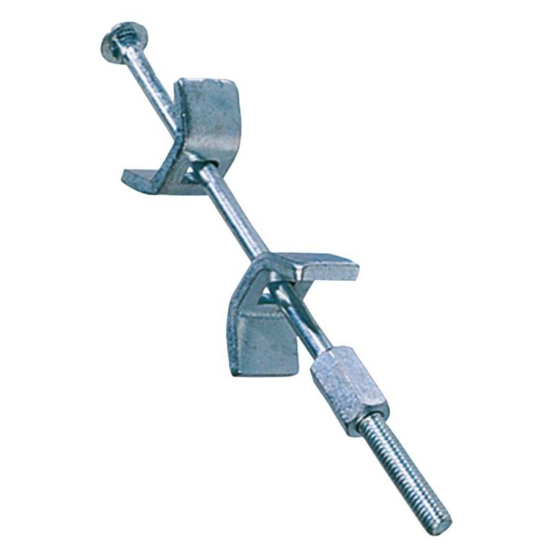

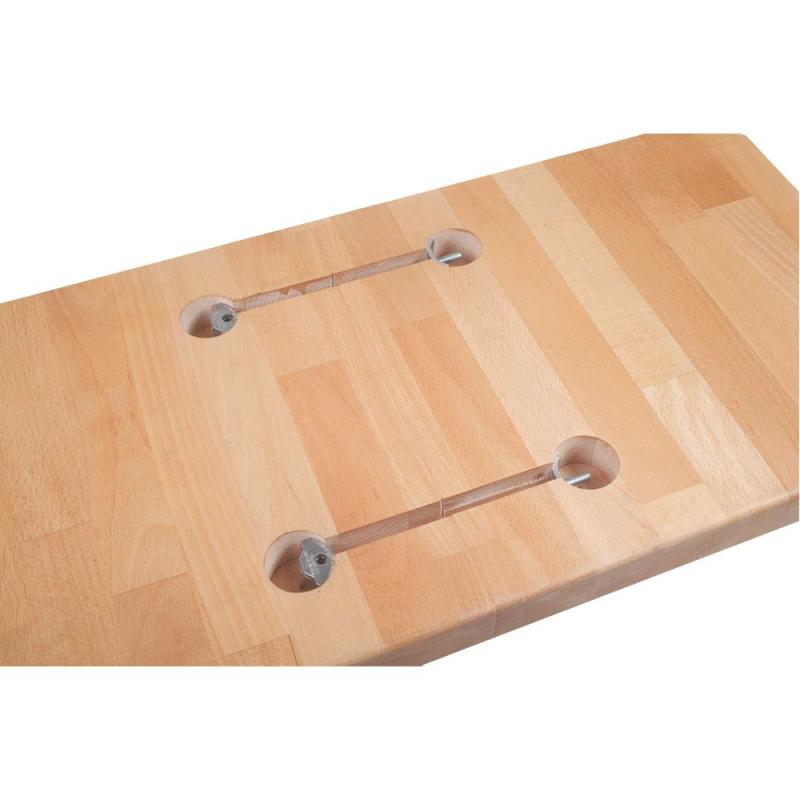

Grooves for brackets i am refering to pulling the joins of worktops together, 'dog and bone' you said? With clear silicon. You mention vertically, can a biscuit cut be done with router?
That's why I was mystified. They are properly referred to as worktop joiners, or colloquially referred to as "dog and bone" or "dog's bone" joiners because of the shape (a bit like a dog's bone?):
They are normally installed in recesses cut using the router, 1/2in cutter, 30mm guide bush and a jig - if you are buying a worktop jig then the "mushroom" cutouts on the jig are the templates for the recesses. The routing depth is generally around 11 or 12mm - just deep enough to flush the bolts. They require a 10mm or 11mm open-ended wrench to tighten them up

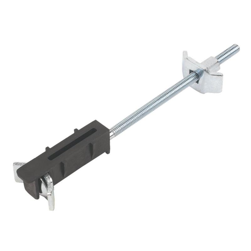

There are better bolts to do this job, such as the ZipBolt:
These require a PZD #2 screwdriver and are a lot easier and faster to use and can be balanced on the screwdriver for installation (unlike the traditional ones which are a two-handed job whilst lying on your back, beneath a worktop, with your arms at full stretch). So worthwhile for a tradesman IMHO and probably also for a less-experienced DIYER. Downside is that they cost more
Another alternative is the Unika Easi-Bolt:
Which hold themselves in the groove while you tighten them up - but they require an open ended wrench to tighten them
There are other variations on the market
The joiners look like this on the underside of the worktop when installed:

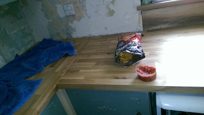

Hi all, have oiled and cut worktop lengths, and marked underneath for wortop connectors.
What I can't figure out is when I cut biscuits for vertical alignment how do I physically push all 3 workTops together With biscuits in. As the're is main span in middle, 2.7m, and one eigher side perpendicular to it. And no room to manoeuvre eigher side?
Also when cutting sink how much overlap would be adequate. Most pictures show little but need to fit drip groove in?
The joints are pulled up using the dog-bone connectors (see above) and an open-ended wrench.
What size cutter are you using for the drip groove? If you are using a 4mm core box cuter you'd need something like a 12 to 15mm overhang. It depends on your own tastes

What I meant is that there was not enough room to fit all three worktops in with required space for biscuits before pushing together. Too Tight. I ended up doing one side with biscuits and dog n bone and other just joined with 'dog n bone'.
Joints are good, sanded em earlier nice n smooth, then wiped with wet cloth Which raised the grain, should I sand again with grain raised before oiling?
As for sink, I used 15mm overhang, with 3mm bit, I wish I would have used less. It made sink smaller and does not look as aesthetically pleasing as I would have liked.
