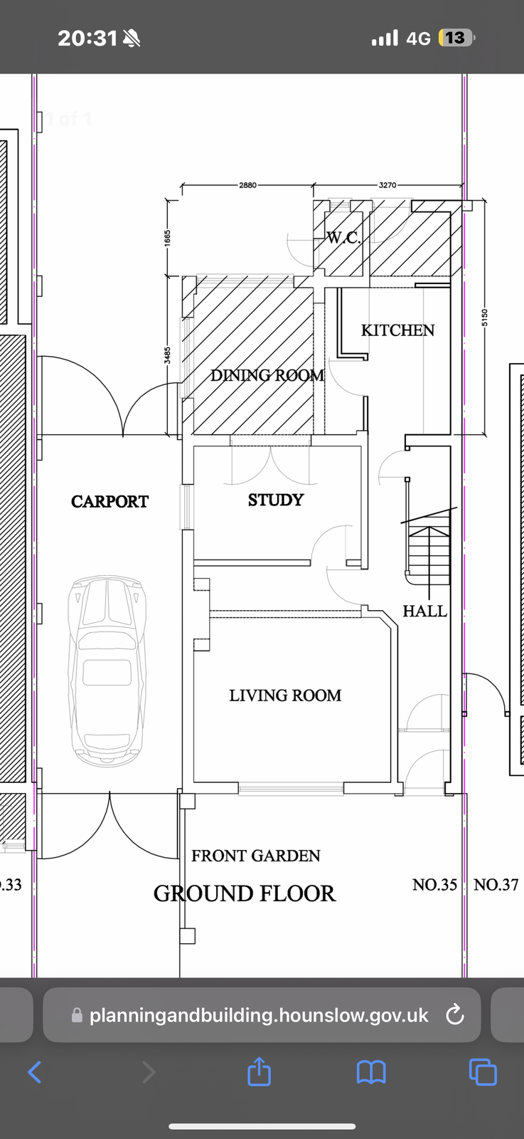

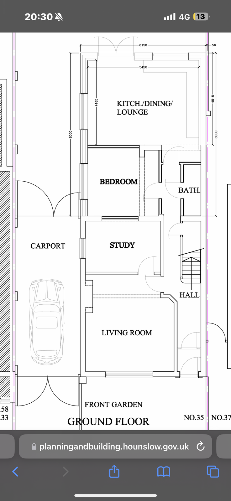

Hi Everyone,
I am here for an advice.
Rear extension wrap around in detached house got refused.
Please see attached decision letter, existing plans and proposed plans. Please advise what is achievable realistically.
Don’t want to get refused again.

You are right. It seems like he had no idea and I end up wasting money for nothing. I have contacted another architect who is going to apply 5.25 rear extension wrap around under householder application route. Fingers crossed let’s see what we get.

That looks like a pretty standard extension, and if applied for correctly would normally be approved. Subject to local planning policy that is.

Before we go down that route there is a lot of information we are not being given. The existing house has a very strange layout so I suspect the rear addition/outrigger, or parts thereof are not original.
With a proper assessment maybe it can be permitted development/larger home extension (although doubtful)?
Mind you the proposed layout is bloody awful and the drawings are quite poor so I would question the competency of the designer.
