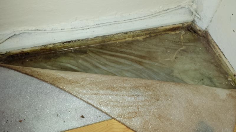

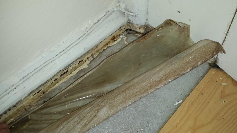

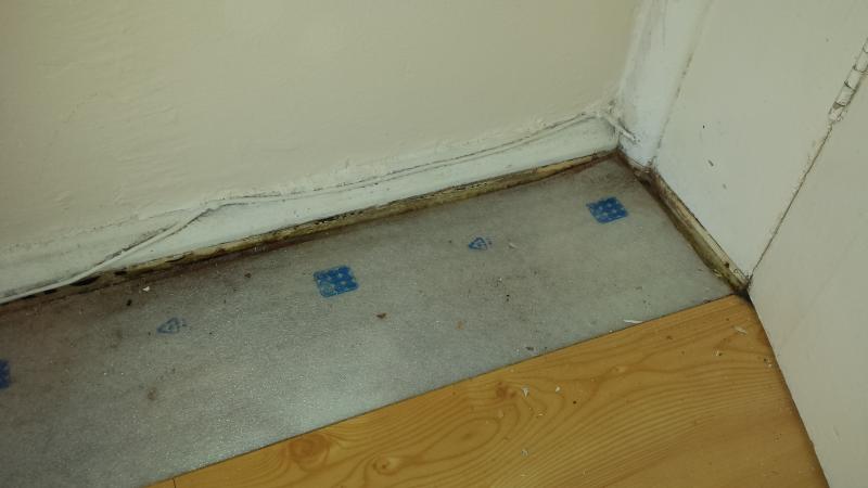

This first picture shows what was immediately below the laminate floor. This underlay is only 2mm thick.
This second picture shows the plastic sheet underneath that first layer of underlay.

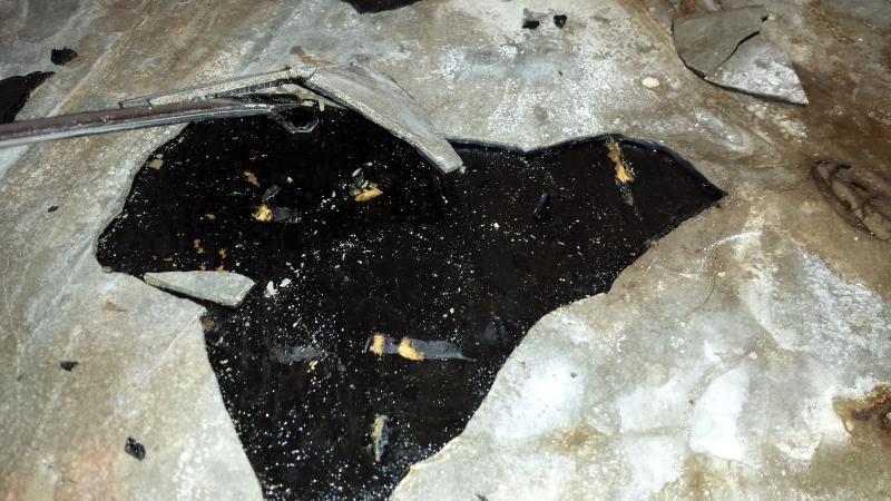

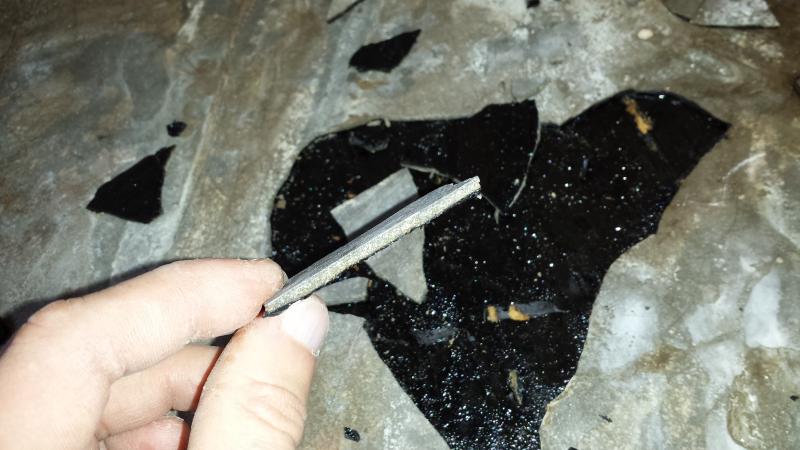

This third picture shows the floor underneath both those layers. This isn't the concrete and appears to be something 'painted?' onto the floor. It's a black tar like substance about 2mm thick.

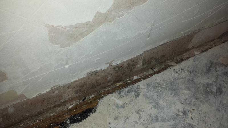

This forth picture shows a lot of water staining on that flooring. There is no obvious indication that this has come from a leak.

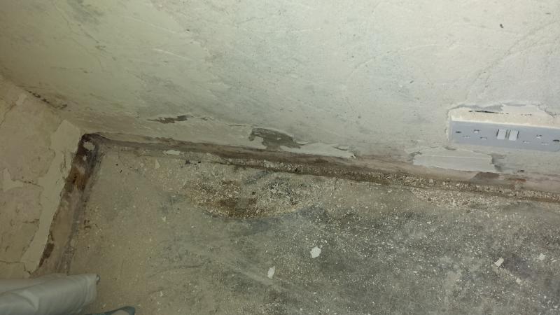

However, this final picture shows an area of the floor where some of that black tar like substance has come lose. There was moisture under that damp proof layer.
This picture helps to show what that black tar like substance looks like.
Firstly, is this the correct way to install laminate flooring? With a very thin underlay and a plastic sheet?
And secondly does anyone have any thoughts as to whether this moisture could be coming from condensation from the way the laminate has been laid?
After digging around a bit it seems there is a concrete sub floor with about a cm of screed on top which is then covered with the black tar like substance. It looks like the black tar like substance might have been applied twice because there seems to be patches of moisture that is causing a layer of the black tar like substance to come away from a much thinner layer of the same black tar like substance which covers the screed.
My earlier suggestion was to remove a length of rotted skirting and pic & post the wall and floor?
From the above pics the bitumen was most likely a liquid bitumen thats been painted on.
"Firstly, is this the correct way to install laminate flooring? With a very thin underlay and a plastic sheet?"
If the floor is level you can get away with a 'thin' underlay. The plastic sheet is not common, although have seen in used in 1980s Barratts developments.
It is unclear why they put bitumen (I am not sure if this is normal for a 1950s house) or perhaps they were trying to resolve some problems.
I have noted in the photos. The thin underlay is 'dirtier' on the underside then on the top.
There is also a 'whiteness' which I am not sure what that is. However, London does have limescale, so it could be residue.

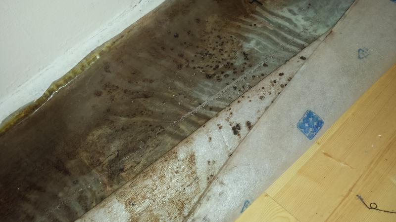

In the meantime here is one further picture that shows patches of mould in between the plastic sheet and the underlay.

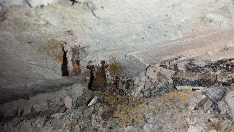

Now that the skirting boards have been taken up there seems to be a gap between the edge of the floor (screed and the bitumen solution) and the wall in which the skirting board sits. Presumably if the bitumen solution does not go all the way to the wall and the wooden skirting board does not sit on top of it any moisture under the bitumen solution layer would simply soak up through the skirting board.
The wooden skirting boards, especially the bottom edge , were very damp, and all the nails securing them in place were extremely rusty.
Gap between upper part of the floor and the wall in which the skirting board sat:
This shows the rusty skirting board nails:
Is it sensible to recover the floor in a fresh coat of bitumen solution or similar damp proof layer, and ensure it covers the floor right up to the wall so that the skirting can sit on it?
