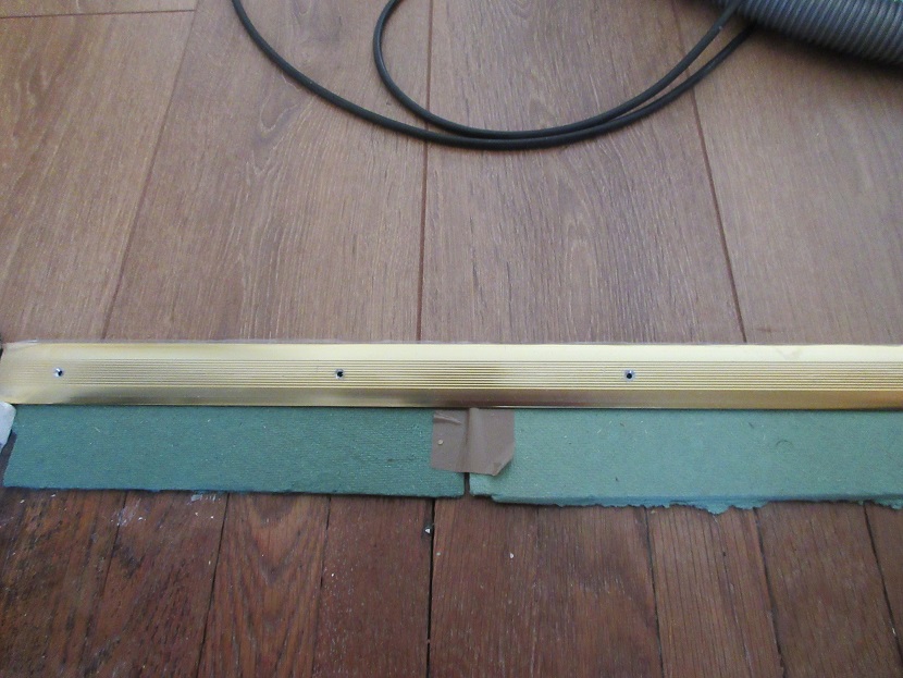

Pics to come. Is the threshold bar fitted on top of underlay or without the underlay?

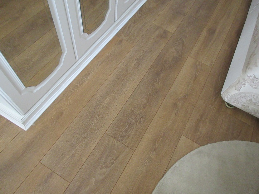

I did scribe joints on the internal corners because I find they are a little more forgiving when lining up. The externals are mitres. Followed the advice and ran the mitres on long walls away from the eye, there was only two to do for the whole room.
Not sure if I did the threshold in the right place. It's not screwed down yet as you can see in the photos, but I can't extend the floor to the door stop if it's wrong, it's too late. It made sense at the time to run the threshold where the door shuts and not between the stops. If it's wrong it's wrong I just have to learn for next time.
Trim is loosely fitted down because I'll be lifting it at a later date to paint, didn't have time yesterday would have caused too much delay, and stuff needed to go back into the room.
You've got a carpet threshold at the door, but it should be a laminate trim that'll allow the laminate to slide underneath it. Other than that, the jobs fine. The join should be under the door itself, not between the door stops, but as laminate trims can be a little high, then fitting them between the stops rather than under the door can work well.
