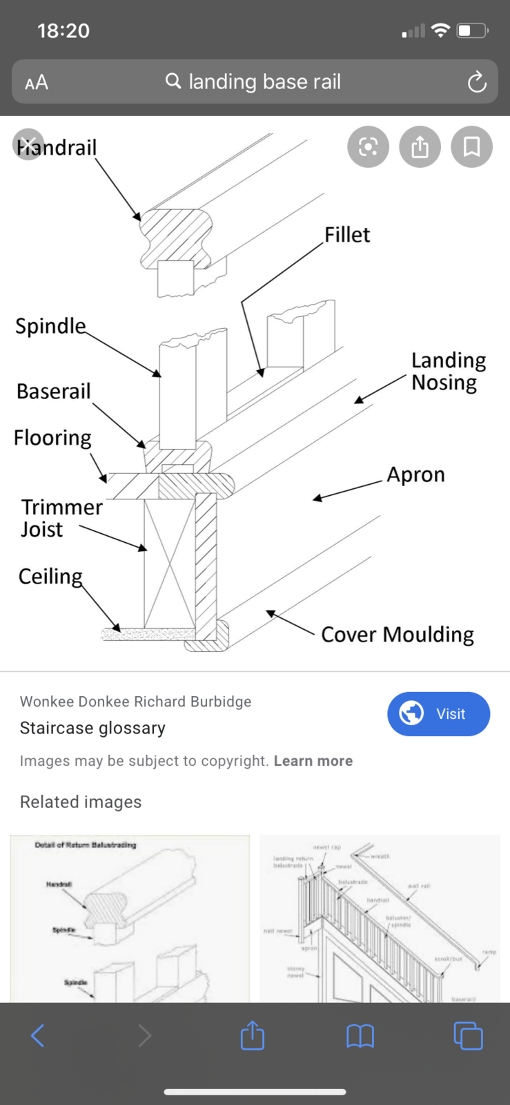

Basically I’m redoing my landing, and it’s never had any kind of landing edging before where the floor ends and stairs drop in front of it (ie where a balustrade would stop you falling down).
Obviously want to change it and have the edge finished properly. Googling around and all I can really find is this picture calling what I’m looking for “landing nosing”, but unlike all other stair parts I can’t seem to find anything to this name.
I’m hoping one of you can tell me what’s used in all properties to edge this section, and where I might buy it? Obviously it has to be the same depth as floor boards and ideally be t&g to fit but appreciate this may not be the case.
Any input and advise appreciated!
