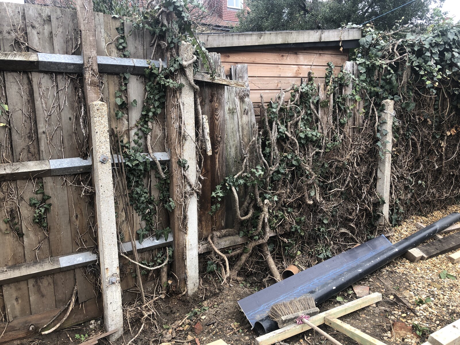

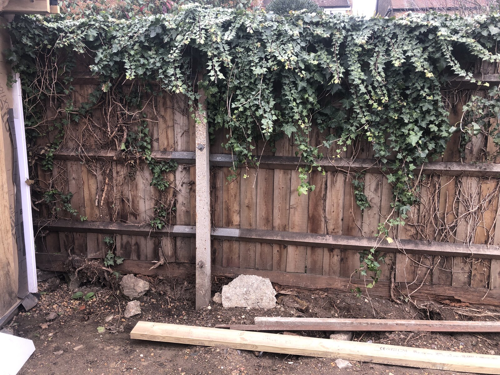

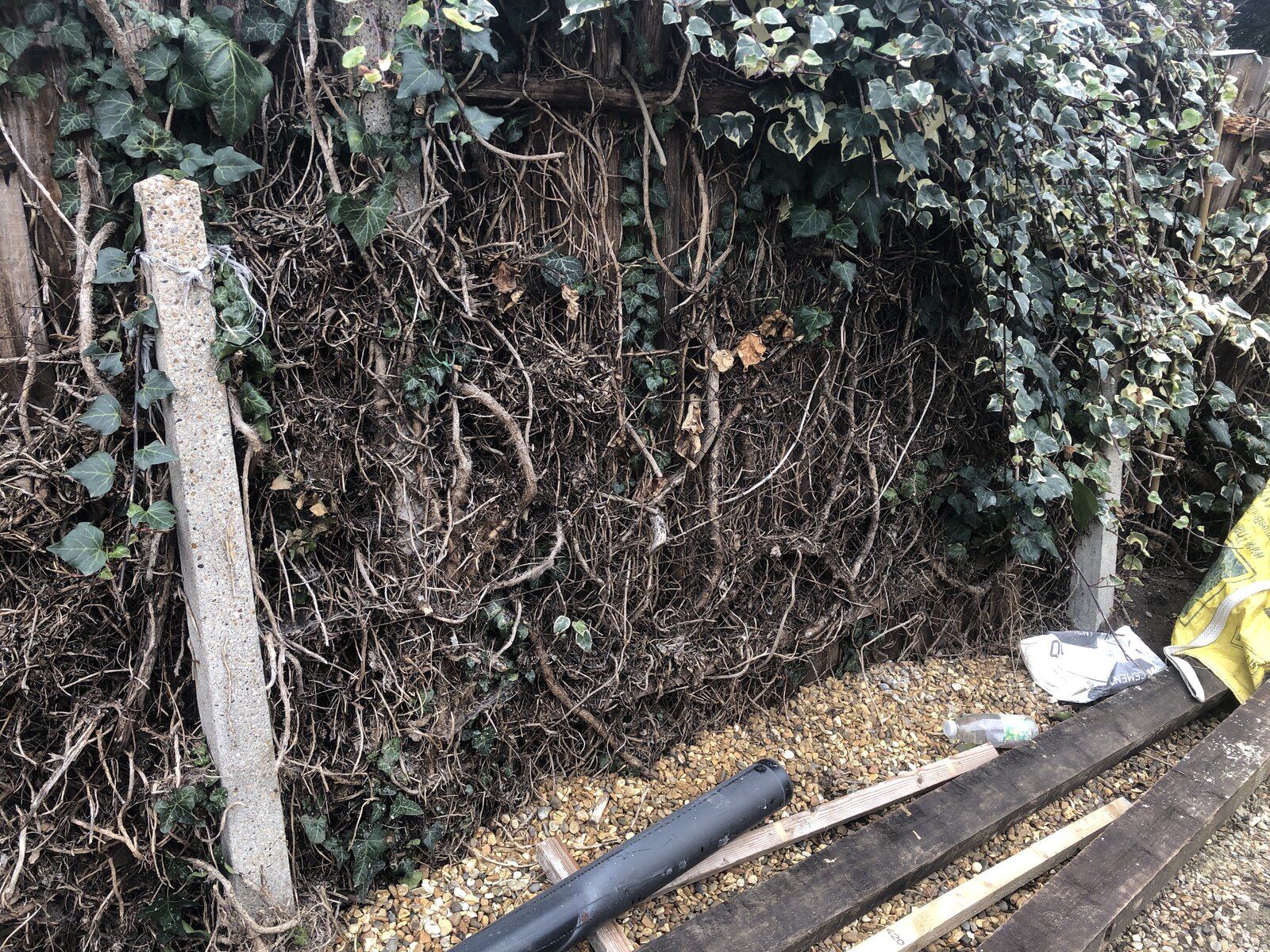

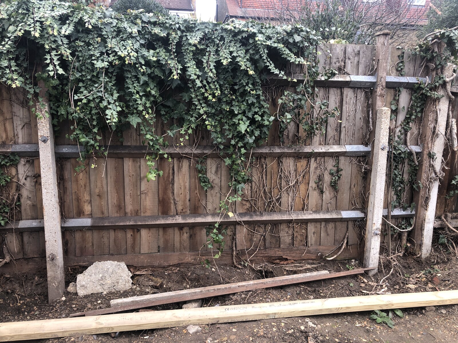

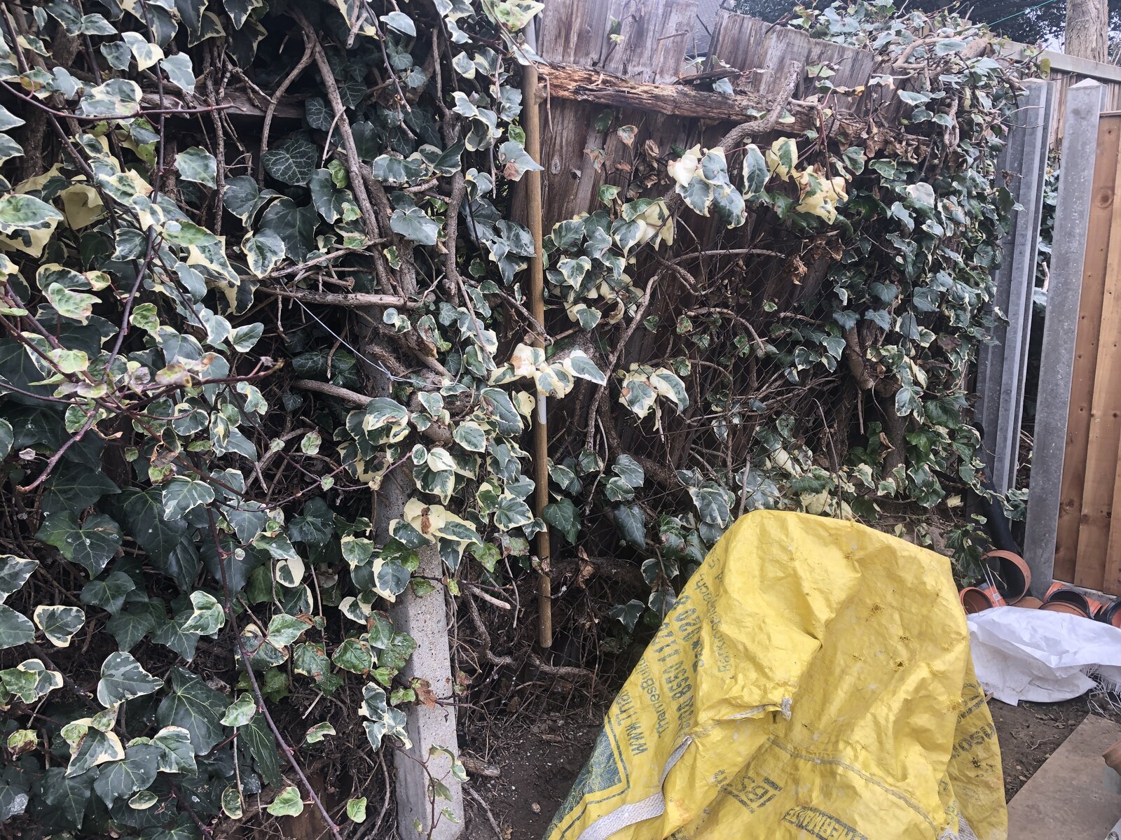

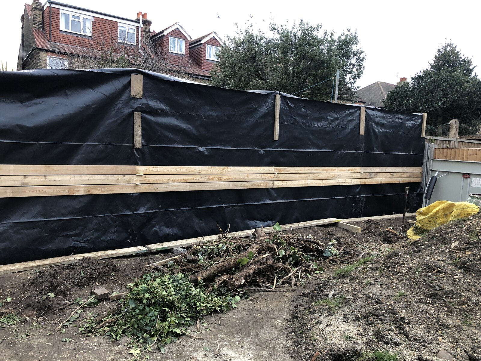

Hi all
Going to use horizontal Siberian larch fencing for the end of my garden (20mm by 95mm PAR), about 12 metres. Got fairly old concrete posts already in place, just trying to come up with how to attach the larch to these concrete posts. Was thinking of attaching timbers to the sides of the posts and then then screwing them into that? Think would need to put in one more additional post. Please see attached photos. Do you think this is a goer? Any advice greatly appreciated!
Its approx 2.7m between the posts apart from the two on the end (1.5m and 2.5m between those and adjacent posts)

Yes at 20mm thick over 2.7m it would be fairly floppy, so additional posts needed
your concrete posts look thinner than usual. might they have been for wire netting?
They have holes through them for bolts. You can bolt an upright wooden post to each, if you like (I use M8 stainless studding with C-form washers and nuts, but if you are not in a coastal area, galvanised will do if you paint it before and after fitting, and grease the threads). The wooden posts should be clear of the ground to avoid premature rot.
If you prefer, you can bolt a horizontal rail through each, and put vertical fencing boards on them. You will need an arris rail or something at the top for extra rigidity, and cats to walk along.
I use decking timbers as horizontal boarding, which are pre-treated, fairly cheap, and strong, and I have a few extra-long ones that will span three posts near the top, adding rigidity and resisting flexing in strong winds. I think they are about 4.8 metres. You can use offcuts to brace the boards together midway between each post and keep them flat.
I advise against trying to drill through the concrete posts. You will probably get spalling, and the act of drilling may start a crack.
They do the boards in 45mm thick too, but obviously dearer, double the price. Worth it for greater longevity?
most of the decking boards I've used for my fence are *edit: 25mm or 28mm* thick. Compare that to the thin rubbish used on most other garden fences. I could sit on top if I wanted.
I think the longer ones are 28mm
Think of garden decking. Far, far stronger than most fences. And the fence is vertical so will not hold damp.

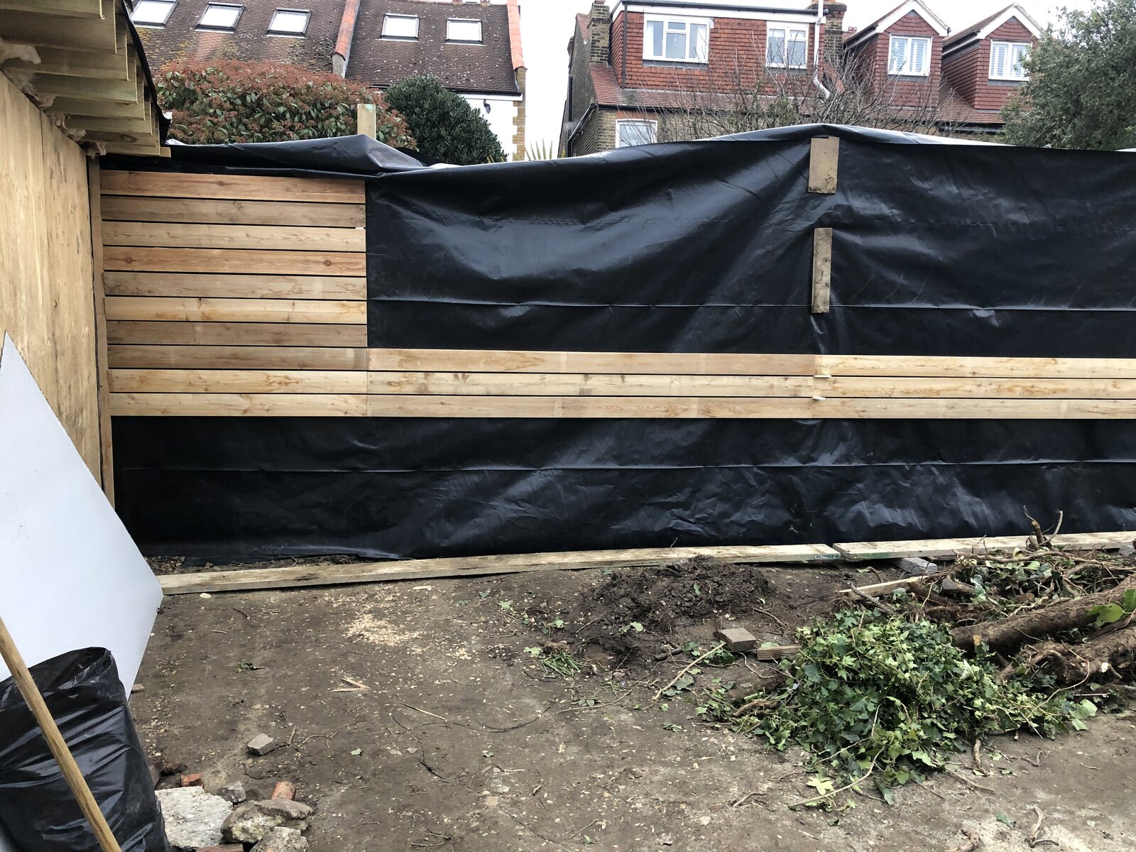

Thanks for all the advice @JohnD do you leave any gaps between the boards for expansion?
yes, though if they are very wet probably not needed.
a piece of folded cardboard will do
This is the current state of play with the fence, Ive used glycophosphate weedkiller on the ivy behind the fence from the neighbours. Not sure about the membrane idea which was left over from the concreting the extension. The idea is to stop the ivy coming through. I reckon over time with sunlight it will break down anyway. Only going up 2m, this is of course a work in progress....Any constructive opinions gratefully received....
