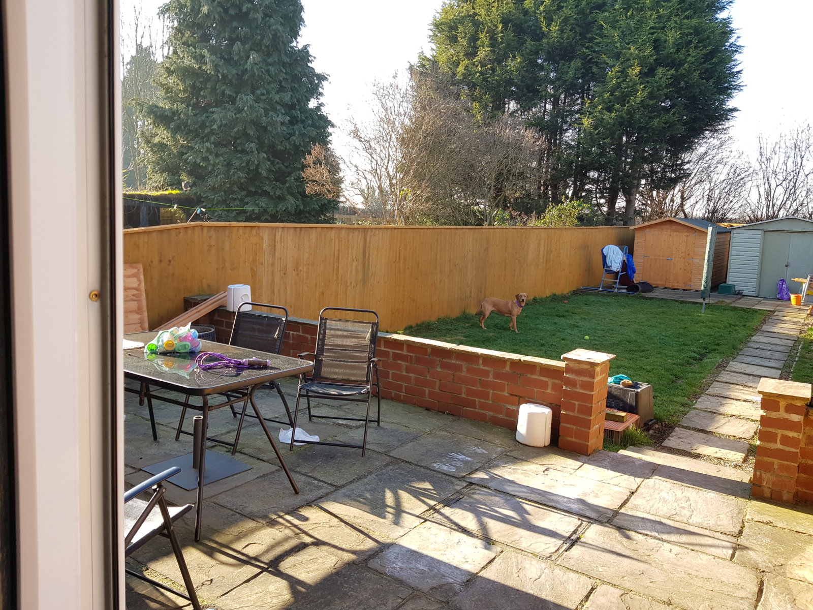

Good evening,

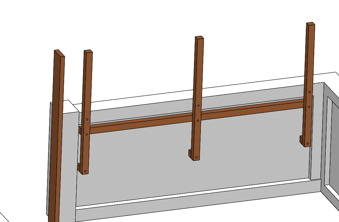

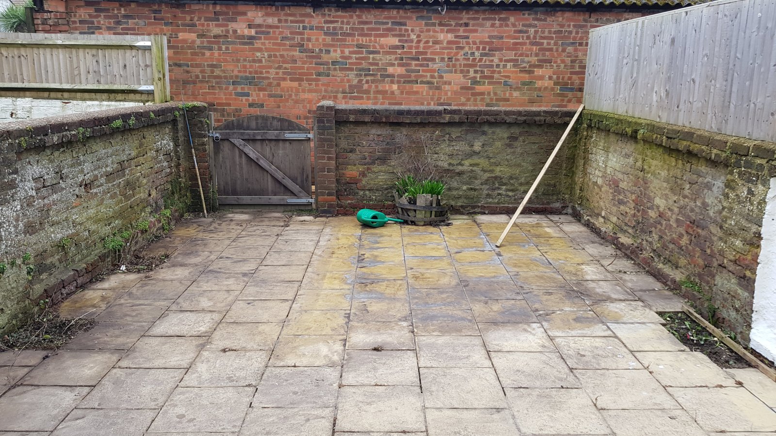

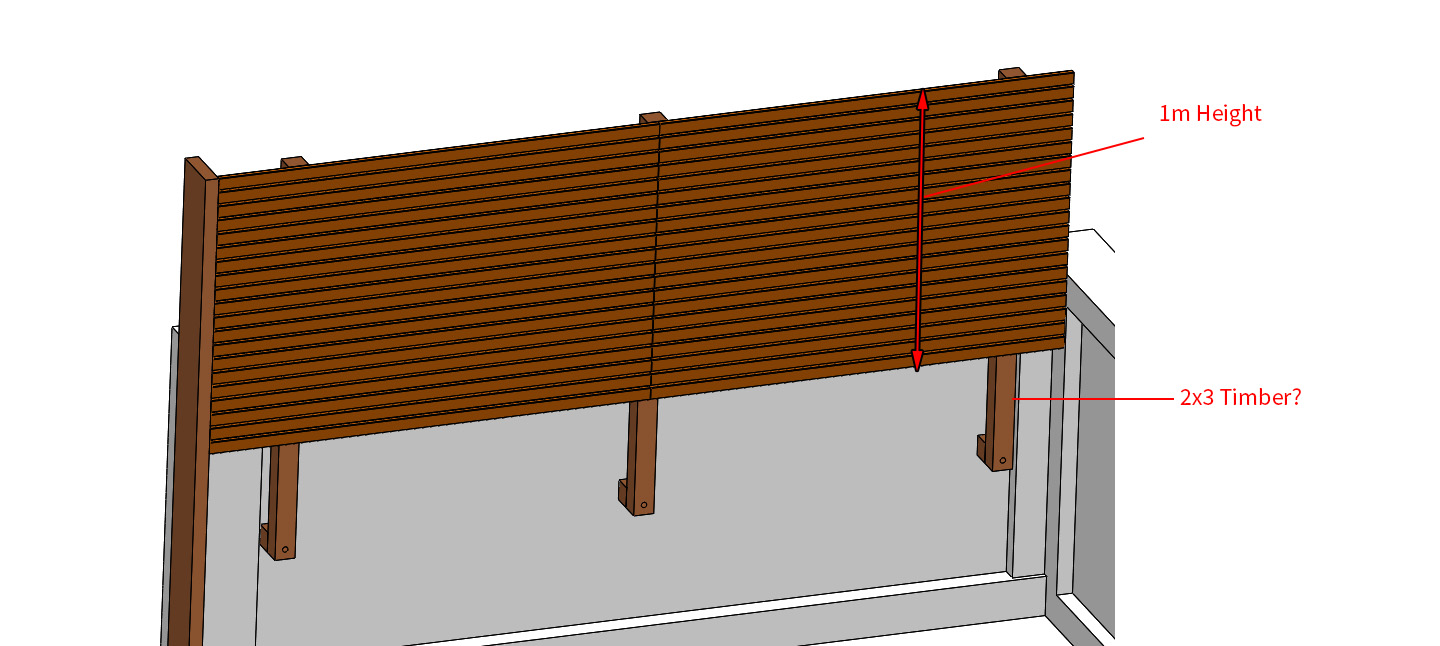

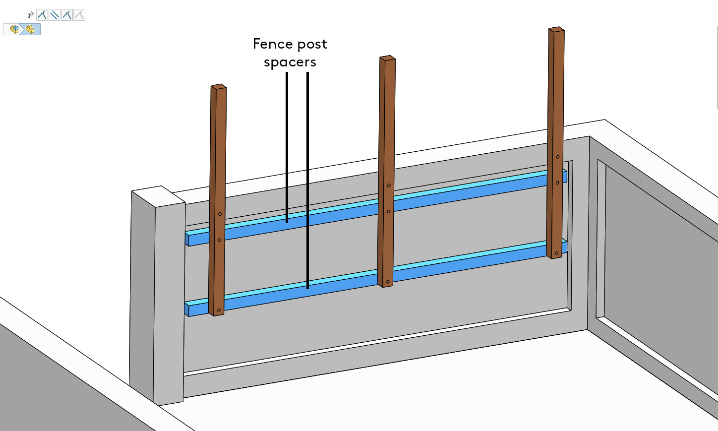

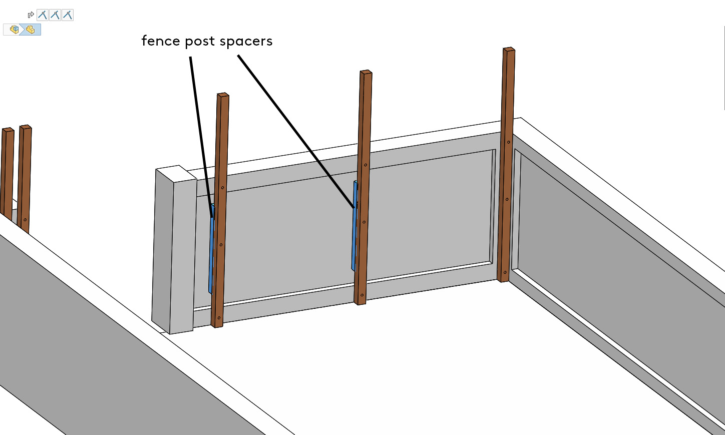

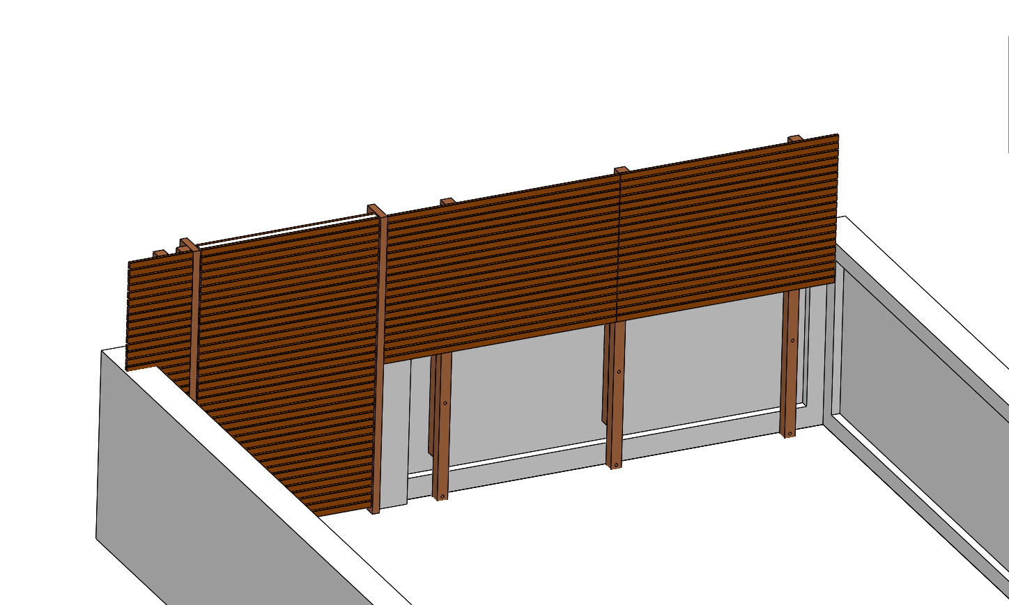

I am trying to figure out the best way to attch fence posts to this back wall.
It is quite an old looking wall, nothing is straight and with the coping and different thicknesses I am struggling to find a nice simple way to attach the fence posts.
I don't want to fix just to the top (using those metal brackets) as I don't think the wall could take it.
I think Maybe I could attach top to bottom and space the middle recessed section with something?
I have shown my thoughts attached along with what I hope to end up with.
The batten are going to be larch and just screwed to the posts.
All thoughts welcome!
Many thanks

I'd do exactly what you suggest. Ensure the packing is solid and the fixings go through any packers.
Is there no way of concreting the posts in?

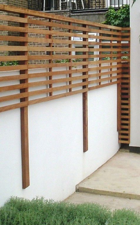

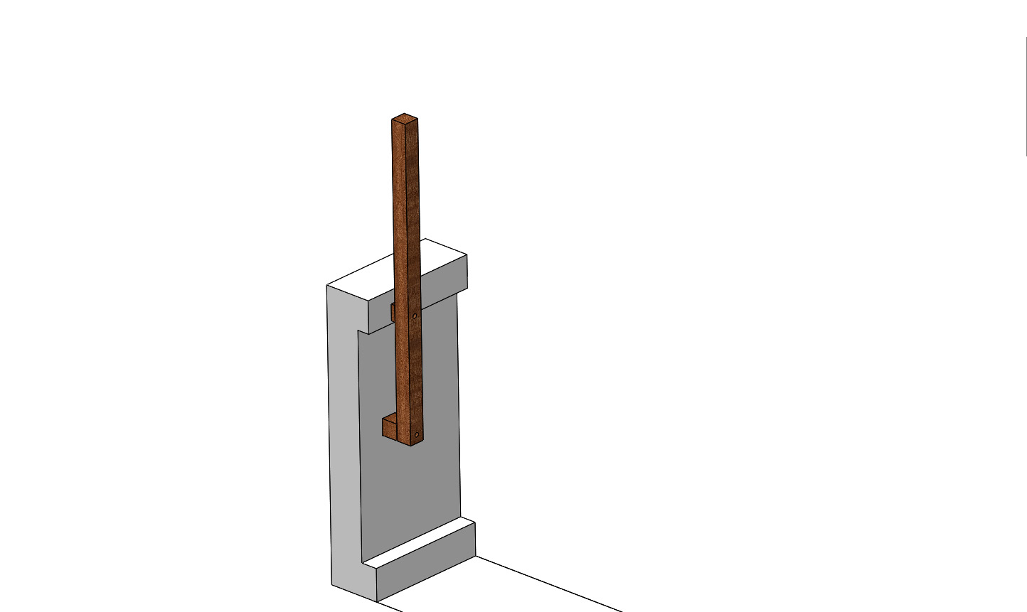

Picture 4 looks your best bet but to ve honest it would look better with full panels/ all fence imho rather than leavijg the wall there. (Unless I've got the wrong end of the stick?).
Thanks for the replies so far.

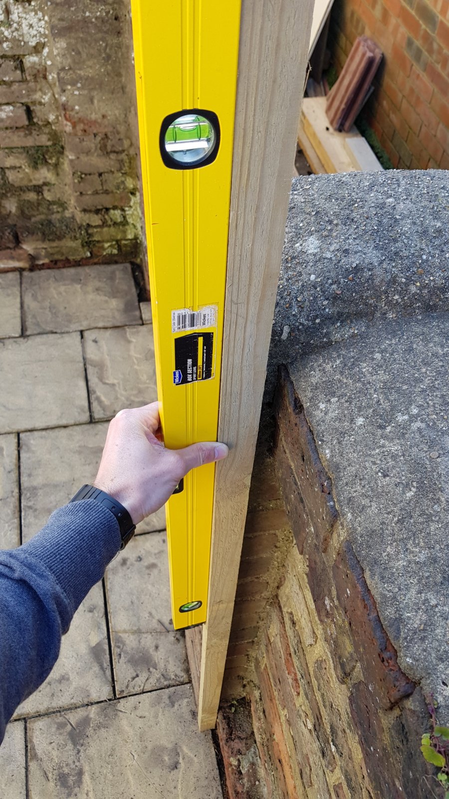

ktuludays: I have seen packers mentioned in forums a few times, but what do people tend to use for these? I think judging by how uneven the wall is I would need to pack out to over 20mm in some areas! I'll have a think about concreting - but this would be a last resort for me only as it seems really difficult for someone with very little experience (like me)

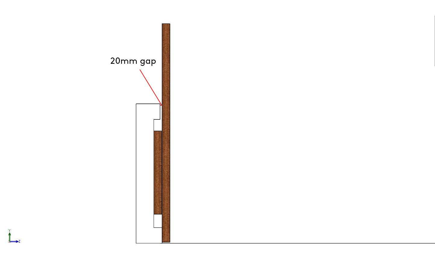

Keithmac: I was leaning towards picture 4 too, but I have just done some more measuring and it looks like the bottom section is around 20mm further out than the top section (cross section to explain attached - big gap.jpg). Would that be a problem?
I'm worried about whichever method I use, there is going to have to be some serious spacing going on! But if big spacers are often used, then I'm less worried. FYI i have never done fencing before. I have done a lot of research but have 0 experience.

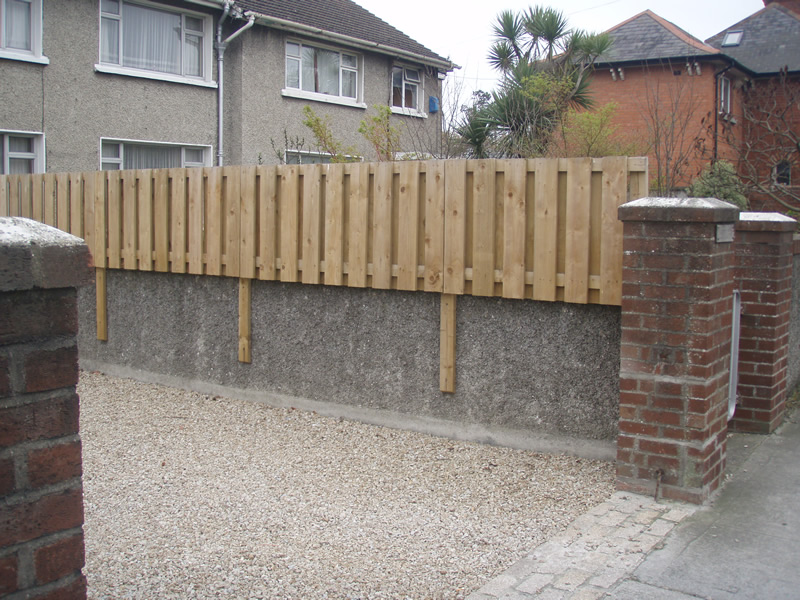

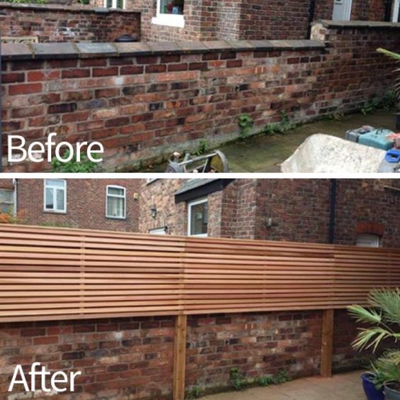

In terms of how it looks, I see your point about maybe all fencing. I have attached the look I am going for, but may bring the slats all the way down. Not sure yet. It largely depends on how messy the posts and spacing looks!

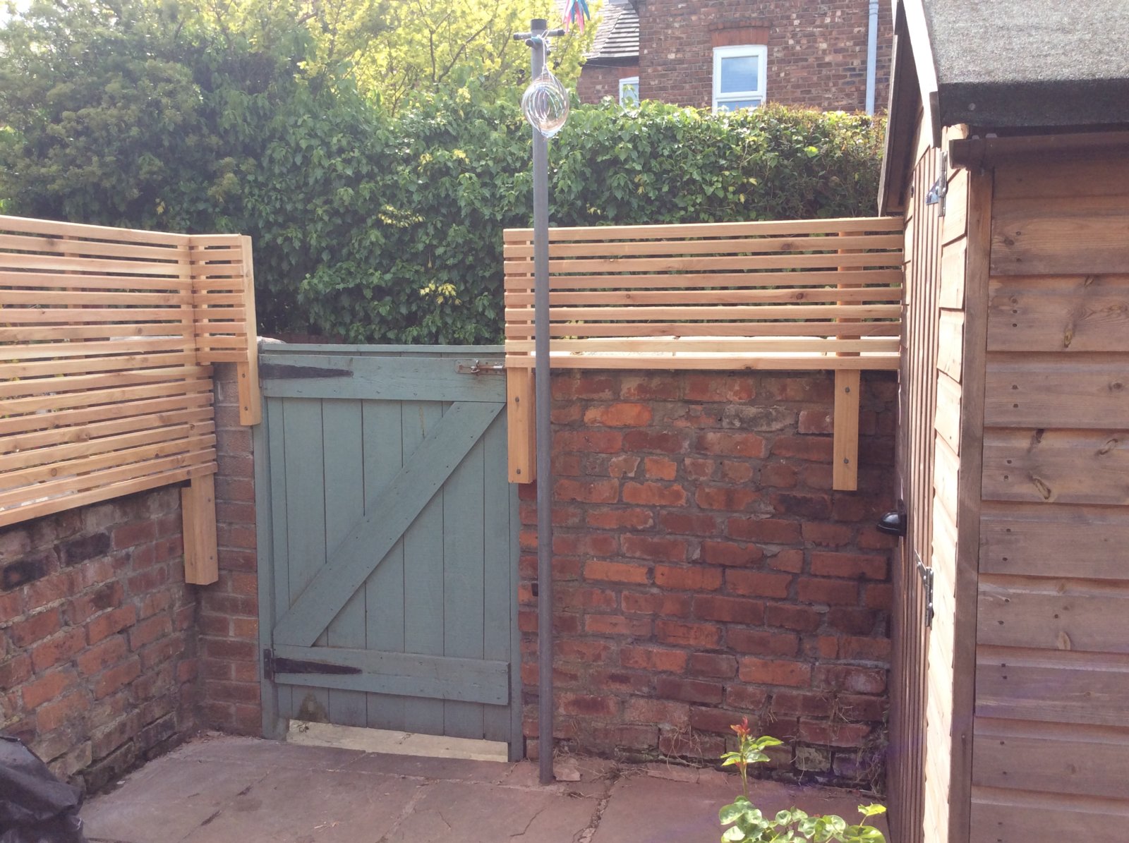

You could cut sections of a spare post to make packers of any lenght, just make sure your fixings are long enough to get through the post + packing piece.
All I'd do is make the "packers" as I go and make sure it's level.. Maybe frame fixings would be your best bet securing it to wall?.

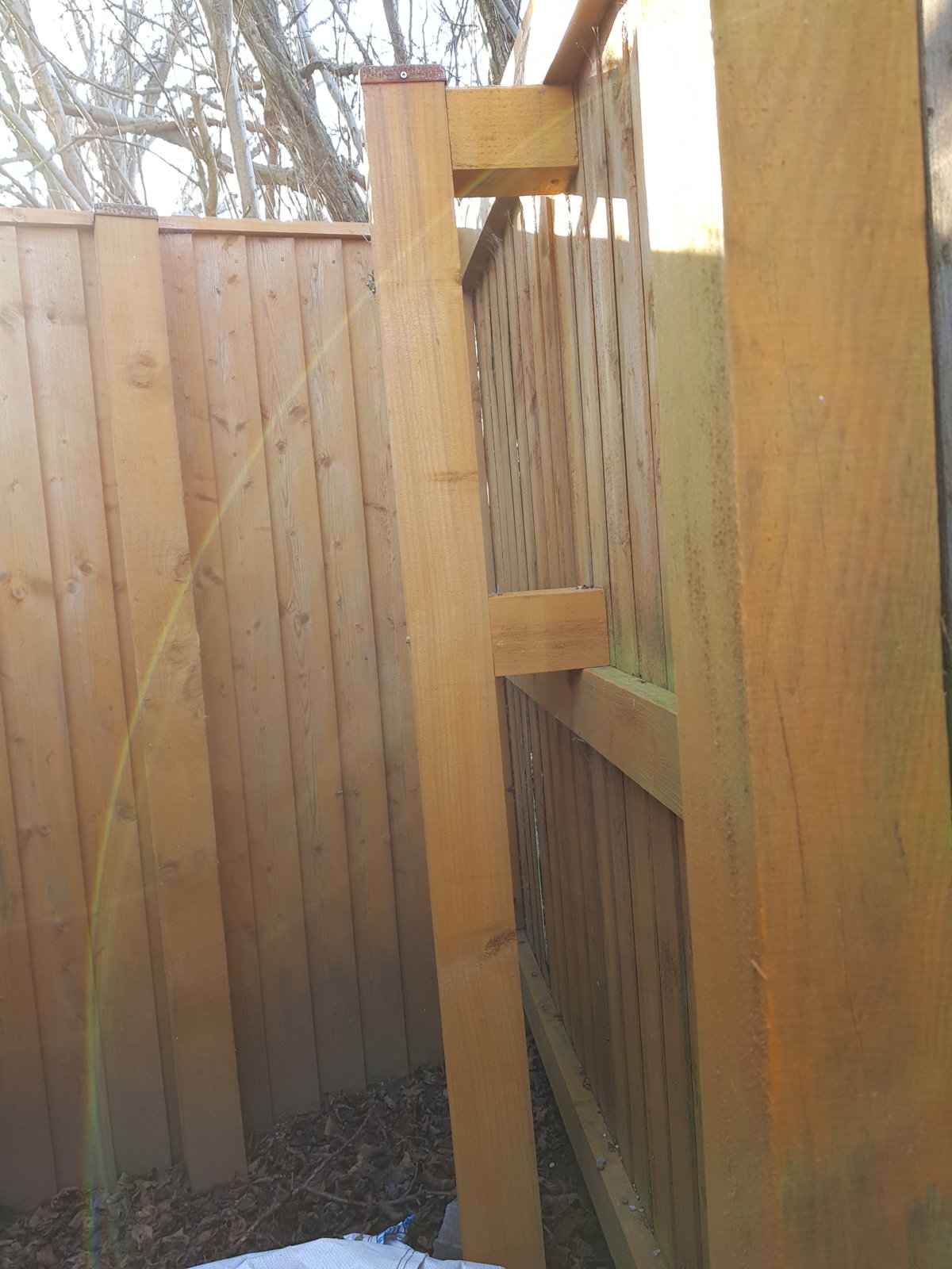

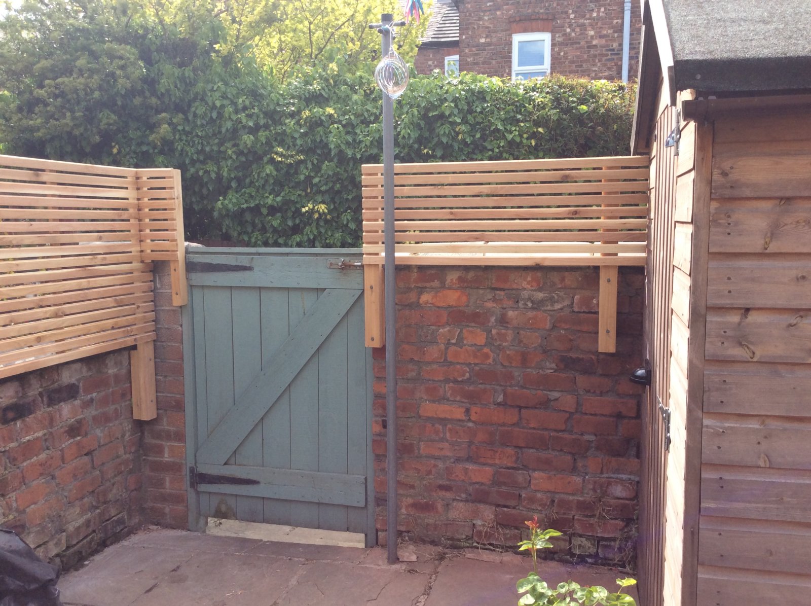

Extreme example but I couldn't pull the back fence down to re-post so had to pack the new posts (behind a shed). Same idea though..

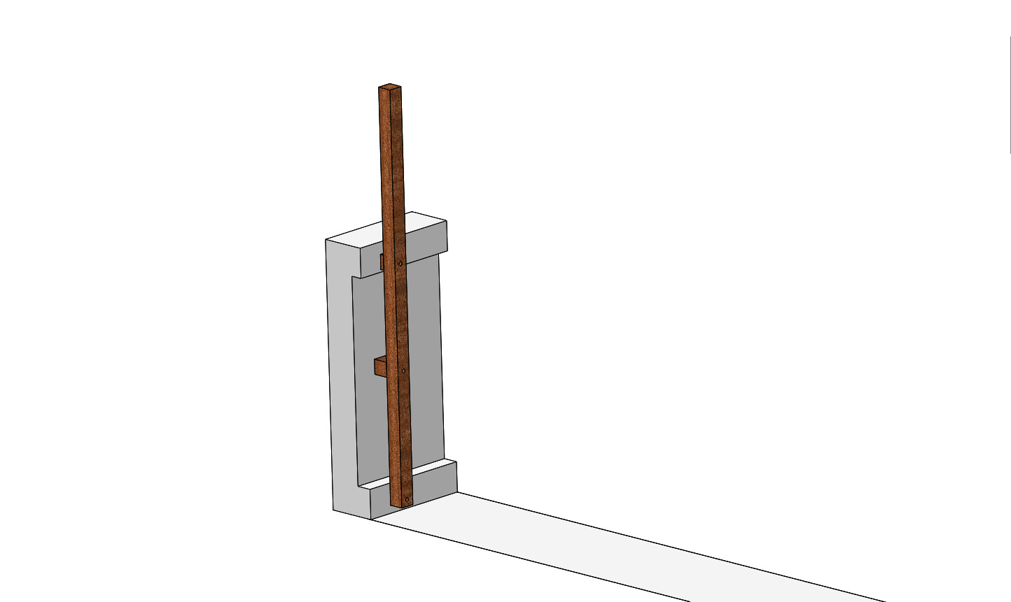

Next questions then would be - do the masonry bolts have to go all the way through the post and spacer and fix to the wall?
Or can I fix the spacers to the wall (using masonry bolrs) and then the post to the spacer using regular wood screws
Also - what are your thoughts on half height posts like the examples attached.
Aesthtically - If I could get away without the post going all the way to the ground, It would look better, but worried it would be weaker.
Thanks for your help so far!!

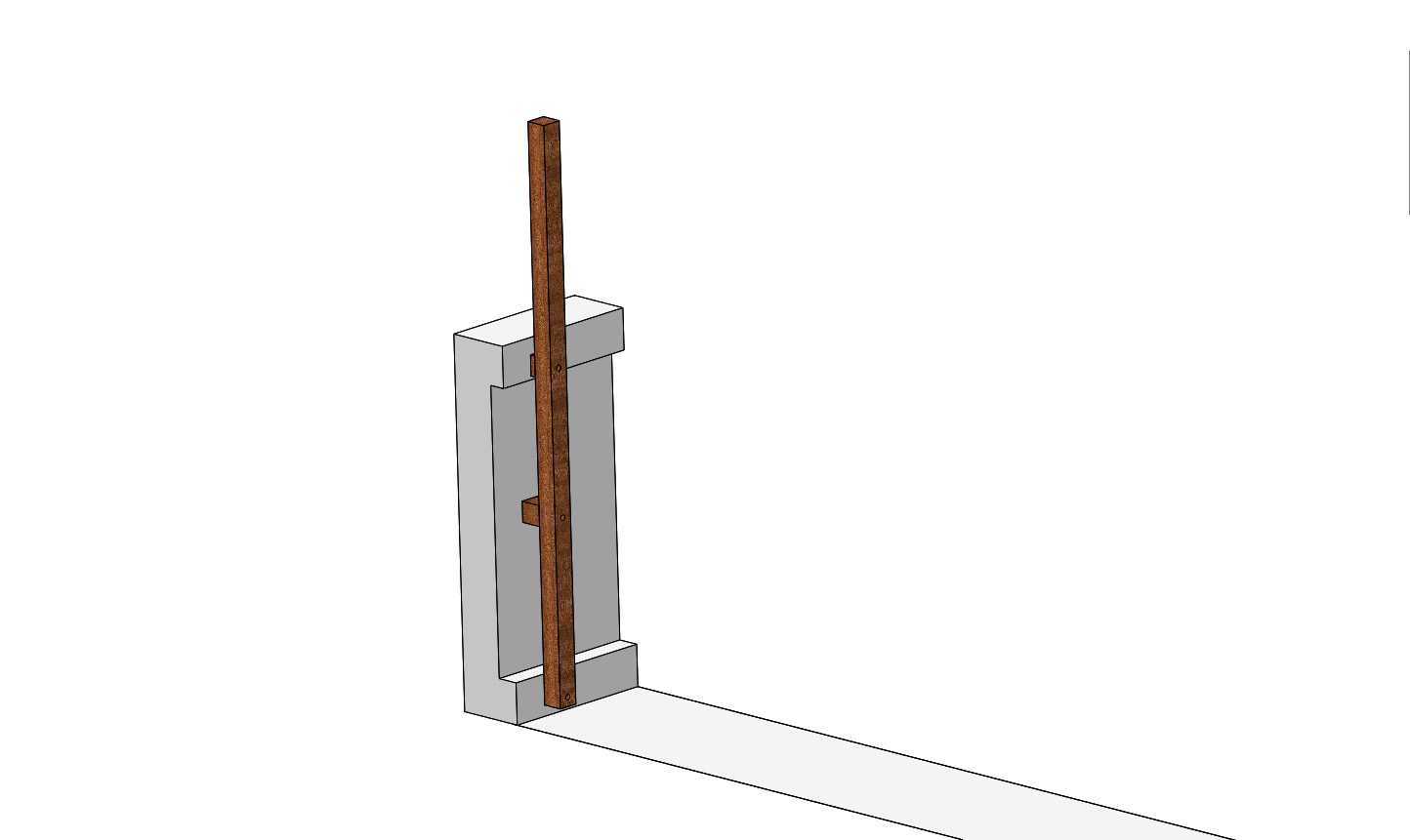

Ah sorry I attached the same picture twice. The half height post was supposed to show the post only extending half way down the wall. Kind of like this...

Depends how much wood you have to play with (how big the packers are) I would say you'd want an inch minimum of screw thread into the packer. Also depends how thick your posts are.
Could do half height posts depending on the condition of your wall, also note they've gaps in the fence to let the wind through, less stress on the fence and wall.
Ok great. I'll go with that and see what happens when the fence posts arrive at the weekend.
I'm not overly worried about wind as the fence will be slatted with gaps (so won't act too much like a sail) and plus there is no wind on that back wall really as it is very sheltered area.

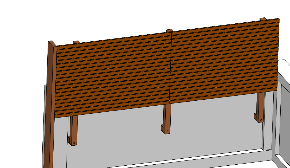

So currently going with this as attached. The horizontal batten I was thinking could help me keep the posts in a straight line.

Good afternoon,
Does anyone think using 2x3 for these posts instead of 3x3 would be ok?
I have a load of 2x3 I can use and it 'looks' strong enough. But without having done a fence before it is hard to tell.
The fence is slatted, with 10mm gaps in between 40x22 battens.

in windy weather, they will be strong enough to crack the wall and push it over.
Hi JohnD.
Thanks for the reply, so you think they will be strong enough at 2x3? Or are you suggesting that fixing them to the wall is a bad idea altogether?
I was hoping with how sheltered the area is and with slats wind wouldn't be as much of an issue :S
fixing a 3-foot lever to a wall is a good way to demolish it.
If you can put the posts in the ground, on the leeward side, not fixed to the wall, the wall will probably be OK
