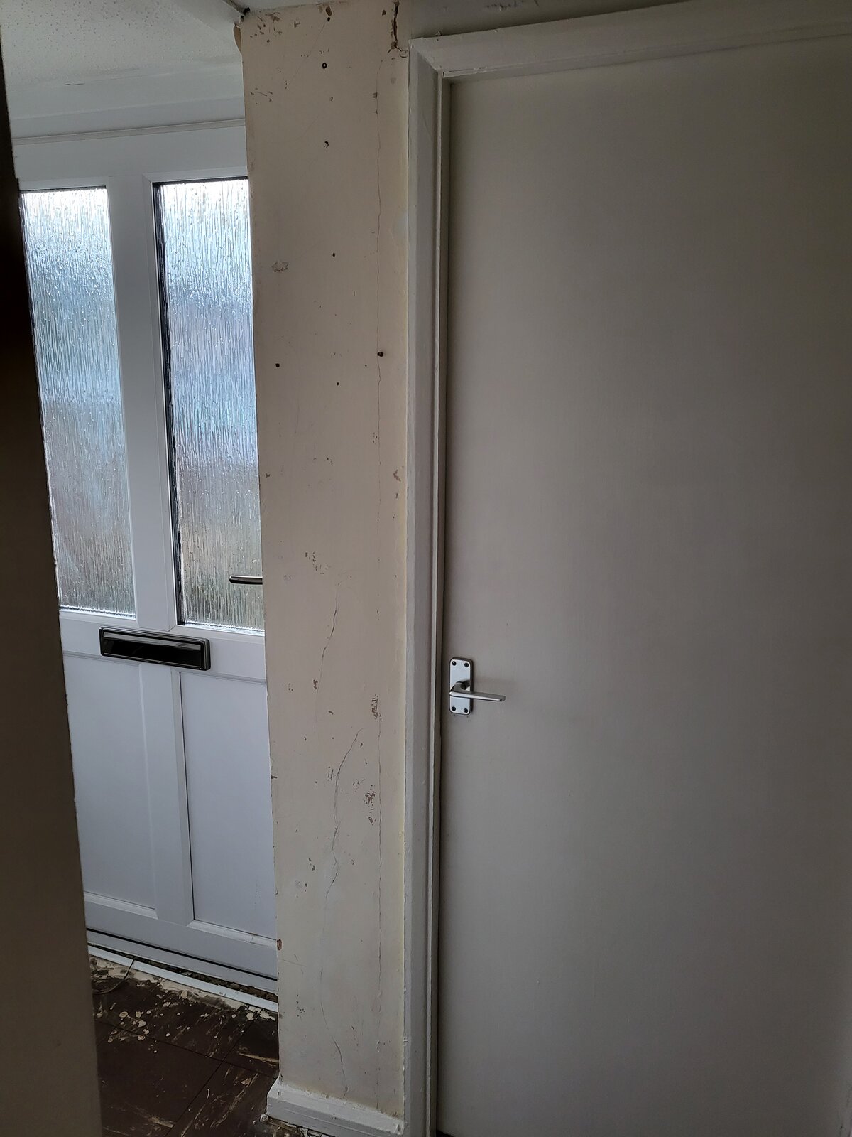

Hey all,
First time renovator here, looking for some advice on something i found when removing wallpaper. Images below, but essentially these cracks look pretty big and I'm wondering:
- Would it be possible to fill these with something like Tupret and then sand it back and paint over it?
- Or, are they too big and would likely still show so should be plastered over?
- OR, should I be worried that the house is going to collapse? (Hopefully not this one!)
Thanks in advance for any help or guidance.

I would gun in some Toupret Fibacryl. Let it shrink back and then fill with a filler of your choice a day or two later.
