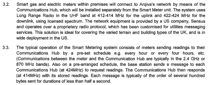

If this is to be believed, (from here) primarily in the 412-425 MHz range (a very popular part fo the UHF spectrum!), but with communication between meters and hub at an appreciably higher frequency ....
Anyone know the frequency the UHF hubs work on?
Comms hub WANs are labelled as 420 MHz usually but Variant 450 MHz in the areas affected by Fylingdales radar.
Actually uplink is 412-414 and downlink 422-424 MHz licensed bands... The base sends on 424 MHz and requests the comms hub to send readings and it sends them back to the base station on 414 MHz. (From an Arqiva planning application).
Fylingales meter Comms Hubs use 454 MHz on one leg, if the interweb is to be believed. If you are interested I'm sure you can find out more
That is consistent with what I reported in post #10 above.
