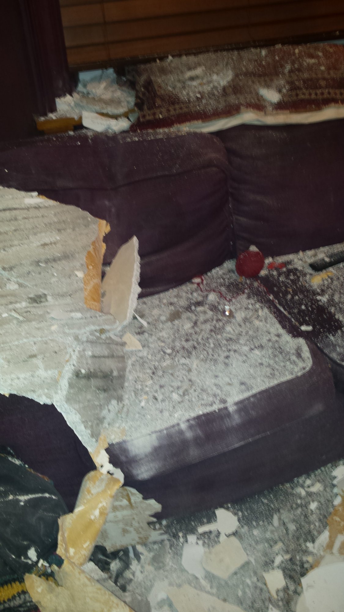

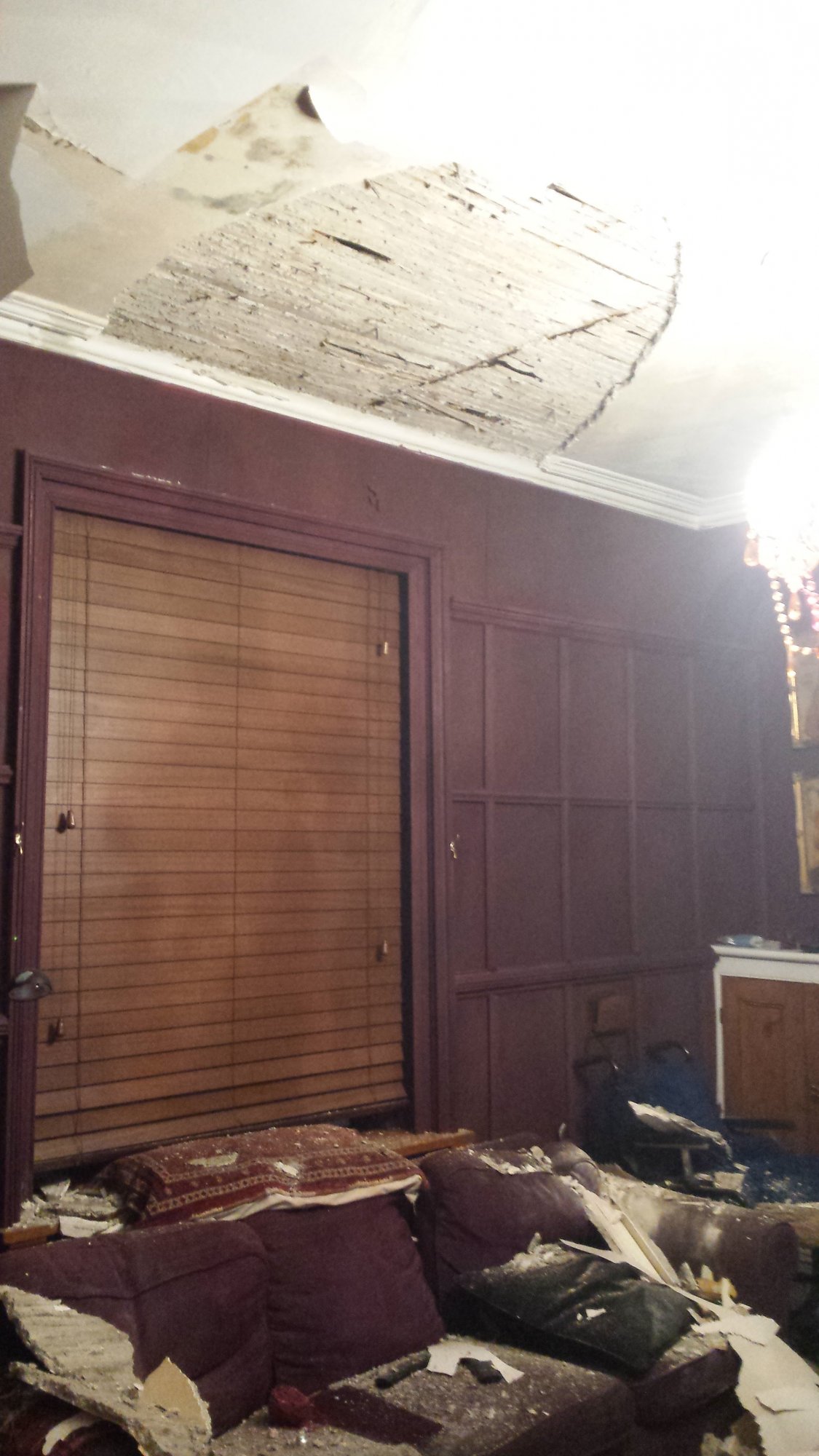

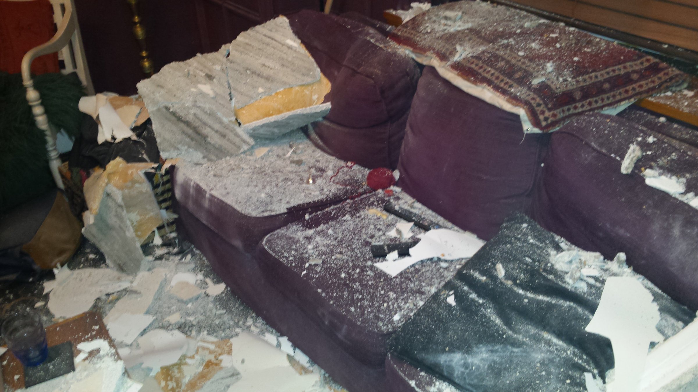

As the title of the thread says the effing roof just fell in narrowly missing my wife who is seriously not amused.
Checked it out and there is no water around it's bone dry, 150+ years old, the rest of the ceiling seems sound enough but I guess it should all be replaced to be sure.
Anyone have any idea if buildings insurance will cover this?
My gut feeling is that as there is no obvious cause other than age (wear and tear) I'm in **** creek.

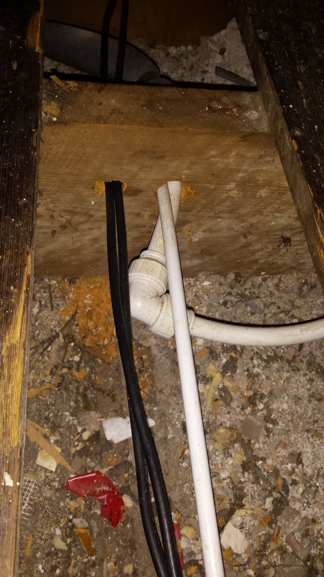

Why not post pics from the room below the ceiling and the room or loft above.
What section (size) are the joists, and what span?
Any tanks or storage items in the loft?

The first indication was small grains of grit falling, then a 'noise' and the fall, my wife was sitting on the sofa and just moved in time. When one of my kids came home they did notice a small bit of grit falling but didn't mention it until after the event.

Presumably you will want to keep the plaster lath ceiling in your 150yrs+ house? I would, not only do original features add value to an old house but you retain the sense of living with the continuity of 150yrs.
Check the remainder of the ceiling for any movement - gently push it up but first remove all paper. Any sagging areas or hairline cracks can be screwed up to the joists.
Check the bedroom floor for any movement.
The missing patch can have the plaster roughly squared off, and all the exposed laths securely fixed to the joists.
The plaster keys between the laths are easily pushed up.
The laths can be damped down - a weak mix of PVA & water will work - and re-plastered to a level plane with the rest of the ceiling.
The whole ceiling can then be PVA'd and skimmed. Or the patch alone can be skimmed into the rest of the ceiling.
You have traditional run-in-place plaster of paris coving, and any experienced plasterer can quickly run a fresh profile in.
Thank's for all the advice, I think it'll all have to come down as there is another iffy looking crack. I'll try and save the coving and perhaps get my teenage kids to strip it out this halfterm which should hopefully reduce the cost.
Then pic the crack and post it - have you removed all the ceiling paper?
I've seen lots of hopeless looking lath and plaster cases that were saved. If it appears more serious than at first thought then before doing anything else start looking for the cause because without remedial action even if you board the ceiling more cracks could appear.

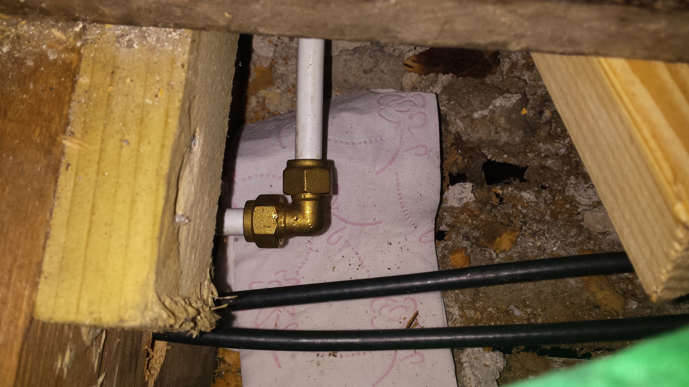

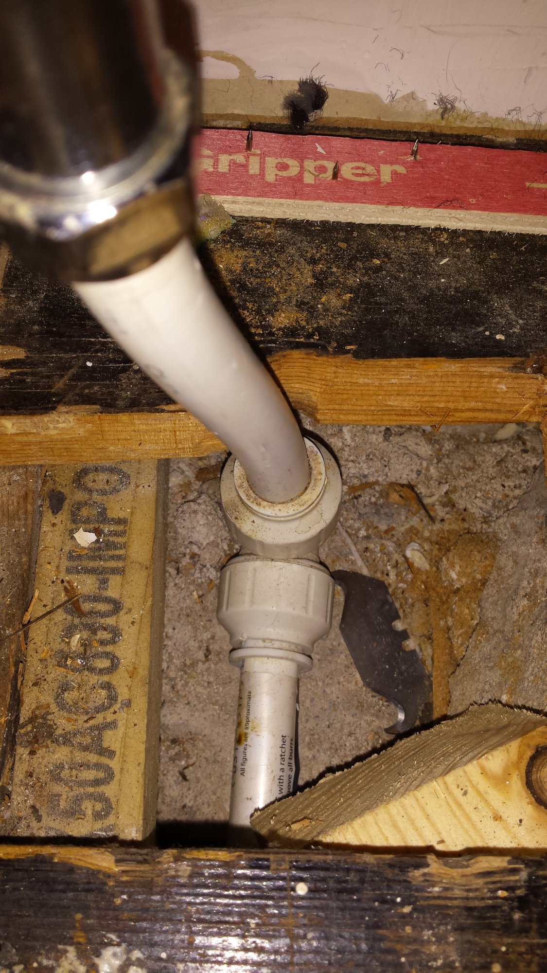

Your pics are fine but they are not keyed to locations in the floor.
Joist span and section are important so is the hefty notch(s?) i see.
Why have what look like repair timbers been screwed to the joists in the c/heating pics - is this the ground floor or are we still in the damaged ceiling?
Even if you consider all is lost then you still dont have to remove anything - you can board over the whole area and screw to the joists.
They are not repair timbers just supports where the floorboards have been cut mid-joist, the house was a student let for a while.
The only notches are where the c/h pipe & aerial leads go through.
The pic with the brass elbow is actually within a window recess set into the 2' wide stone eternal wall. I know about simply screwing boards up sandwiching the remaining ceiling and keeping it up. There's a lot to be said for doing that especially saving the mess.
