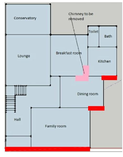

I have redrawn my picture and added it here = I don't think my first picture explained it well enough
Yes your proposal is a side extension. But it is also a front extension. An extension can be both a side and a front extension.
Under the rules you cannot build anything in front of a principle elevation wall, or in other words any of the walls highlighted red in this pic:
That rule is one of those which are more restrictive than the pre-2008 rules.
Previously, you could not extend beyond the nearest wall (in plan) to the highway. Now you can't extend beyond any wall forming part of the front elevation.

I've talked to my plan drawer - who says we would not be going forward of the principle elevation.
I'm wondering if this is because the 'front wall' which has a bay and porch is 2 stories where as the dining room is only one story high. Would that make a difference?
(sorry for the many questions.)
He does not understand planning law then, plain and simple. Scary!

Yes, I see what you mean about L shaped properties - and all the walls facing the highway,
I was just pondering whether 'height of wall' made a difference.. as the man who came to site and is involved in extensions in this area - applying for planning etc - thought it would be permitted development- although he suggested Lawful development certificate for peace of mind
