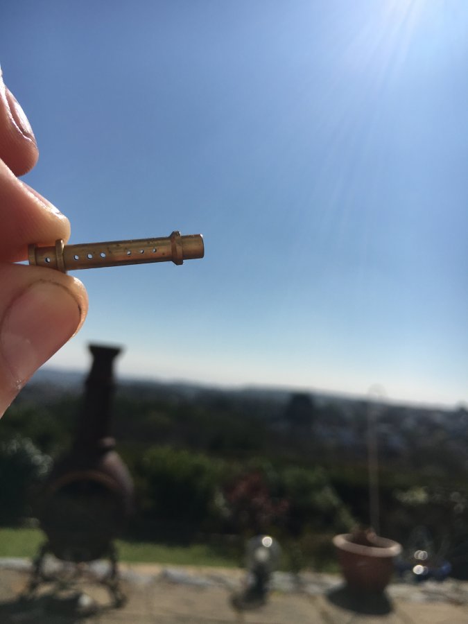

So - float chamber off, check the needle valve for cleanliness once the float pin has been withdrawn. Then, undo the main jet, and try to extract the emulsion tube which is brass and just above the main jet. This must be clean, and the cross drillings are very tiny!

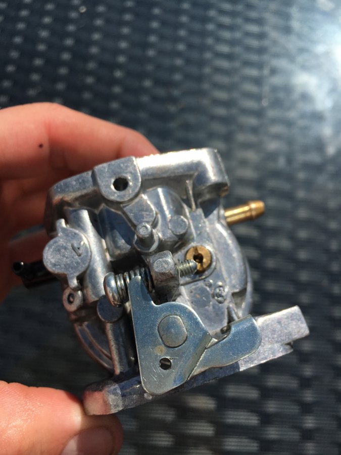

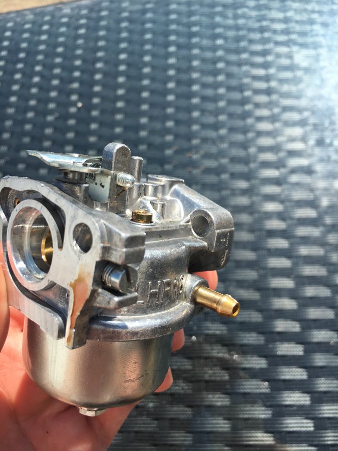

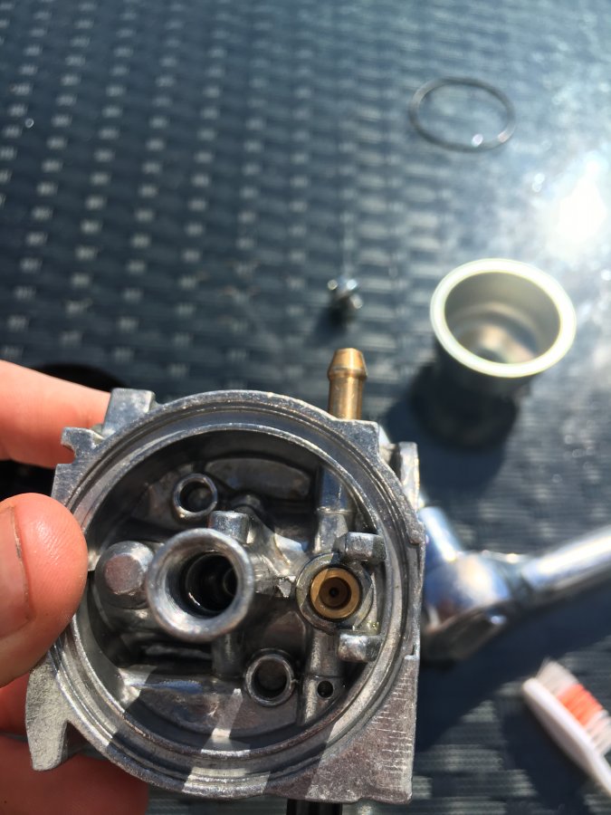

Here's some pics

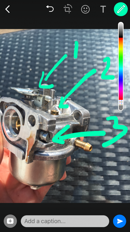

I've labelled this picture to try and make things easier. I'm quite confident I've got everything as clean as possible but could do with some clarification on how to position all the parts I've labelled. Thanks!
1) idle screw?
2) is this the pilot jet that needs 1.25 anti-clockwise turns from closed?
3) not sure
Pic 1 shows the mechanical tick over screw, partially covering the brass pilot jet. ...unscrew the jet for cleaning. Pic 2 shows the spring loaded idle mixture screw, typically 11/4 turns out from fully in. Pic 3 shows the emulsion tube, only fits one way! Pic 4 shows the needle jet that lets the fuel through. Final pic, shows the tick over speed screw, 2 is the idle jet in brass and 3 is the idle mixture screw. Hope this helps!
John :)
