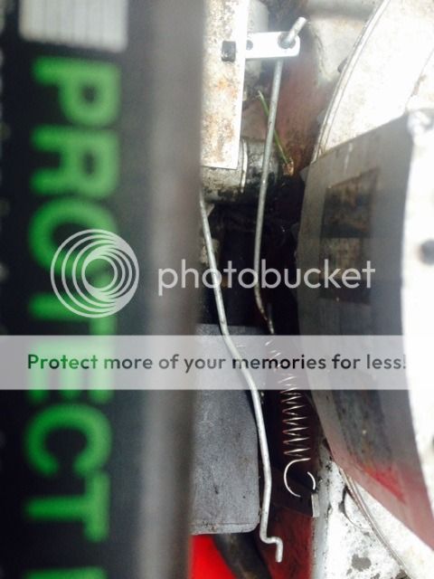

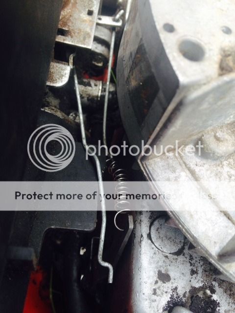

hi there all this is the setup
can i make up a rig to use the throttle differently. the metal bar controls the throttle but connected to the spring part the throttles wide open
A bit of a bodge, that one.....for sure that spring doesn't look right!
With the engine off, the carb throttle should be open, but only lightly held there.
What's happened to the left of the two rods?
John :)
But, would you not be better to look at the videos to find what the linkage setup should look like and copy that? You will not be able to "buy" the correct linkage setup, because its to much a balance between the pull of the governor linkage coming out of the engine and the pull from the throttle cable.
hi john sorry i should have made it clear. no matter how i connect the left rod i either get idle or full chat.
almost pulling my hair out. i found this on the web. noticed that someone has bent the rod on mine in the past. no wonder it had enough travel and was on full chat was probably 10mm further forward then it should be
http://www.outdoorking.com/forum/up.../full-2772-14500-tecumseh_van148_governor.jpg
bent the arm back and slotted it in the top. with no choke its at idle so result with all connected. problem is the spring is weak so throttle adjustment is pretty difficult but (it works :D )
just need to find the correct spring now
