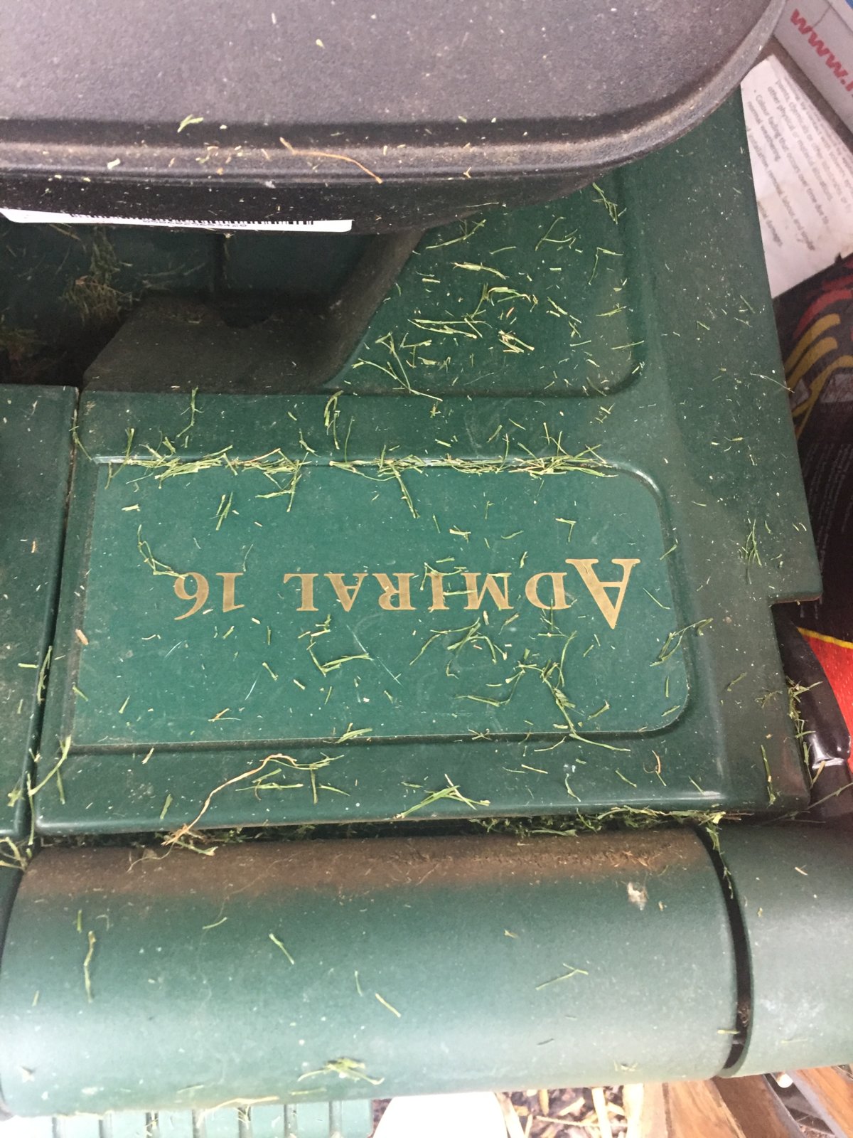

I have a Admiral 16 Petrol Mower that I picked up from a car boot sale last year. I've been using it for over a year and am very happy with it.
I wanted to service it this year and had the following in mind: replace blade, drain and refill with new oil, replace air filter, replace spark plug. Should I include anything else?

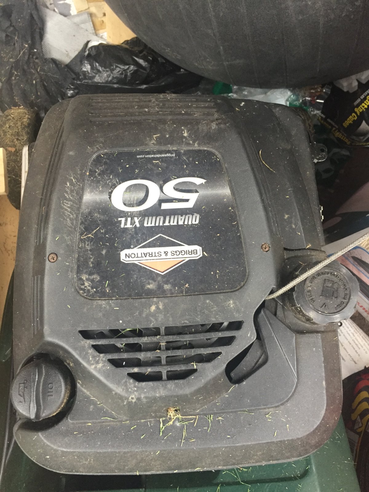

More importantly, when I phone lawn mower suppliers for parts they advise me that Admiral 16 is too old and they don't have any parts. It may be an old mower but it runs as Briggs and Stratton Quantum XTL 50 engine and hence isn't that more relevant when looking for air filter and spark plugs?

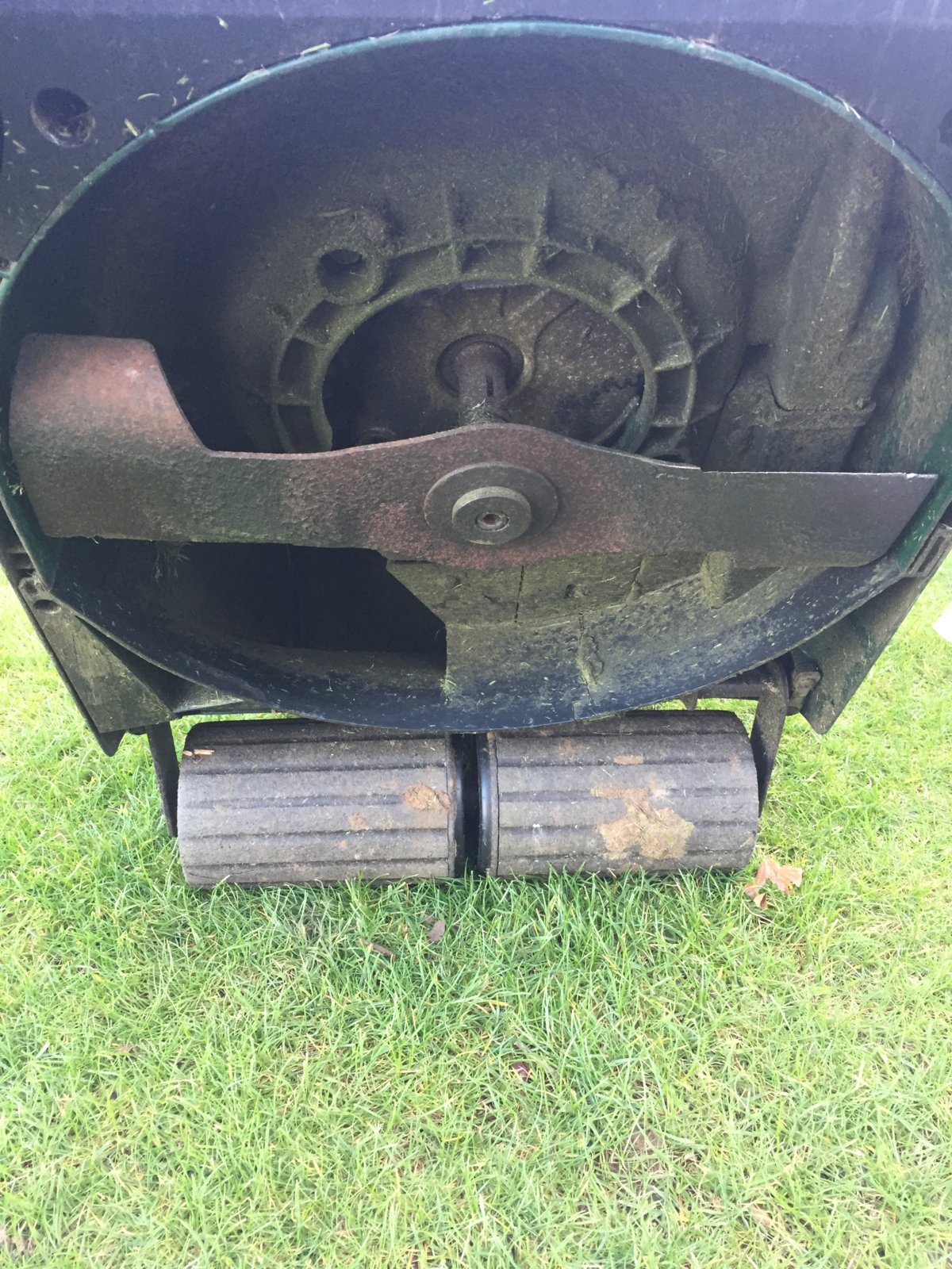

A further question please: my blade looks like this. Any ideas on what I need as a replacement or whether I am likely to find a replacement before I start to remove this.
I'd certainly go with litl's suggestion! Your blade is obsolete but there are a couple about. From here it doesn't even look like it will need balancing.
www.abbeygardensales.co.uk have them for £39.99. The part number is BQF016T49293.
Word of warning.....the blade looks to be secured with an allen bolt in a counterbored hole? Make sure you can shift it first - the correct key is vital and its probably imperial. I use an impact wrench to shock them out (usual RH thread).
