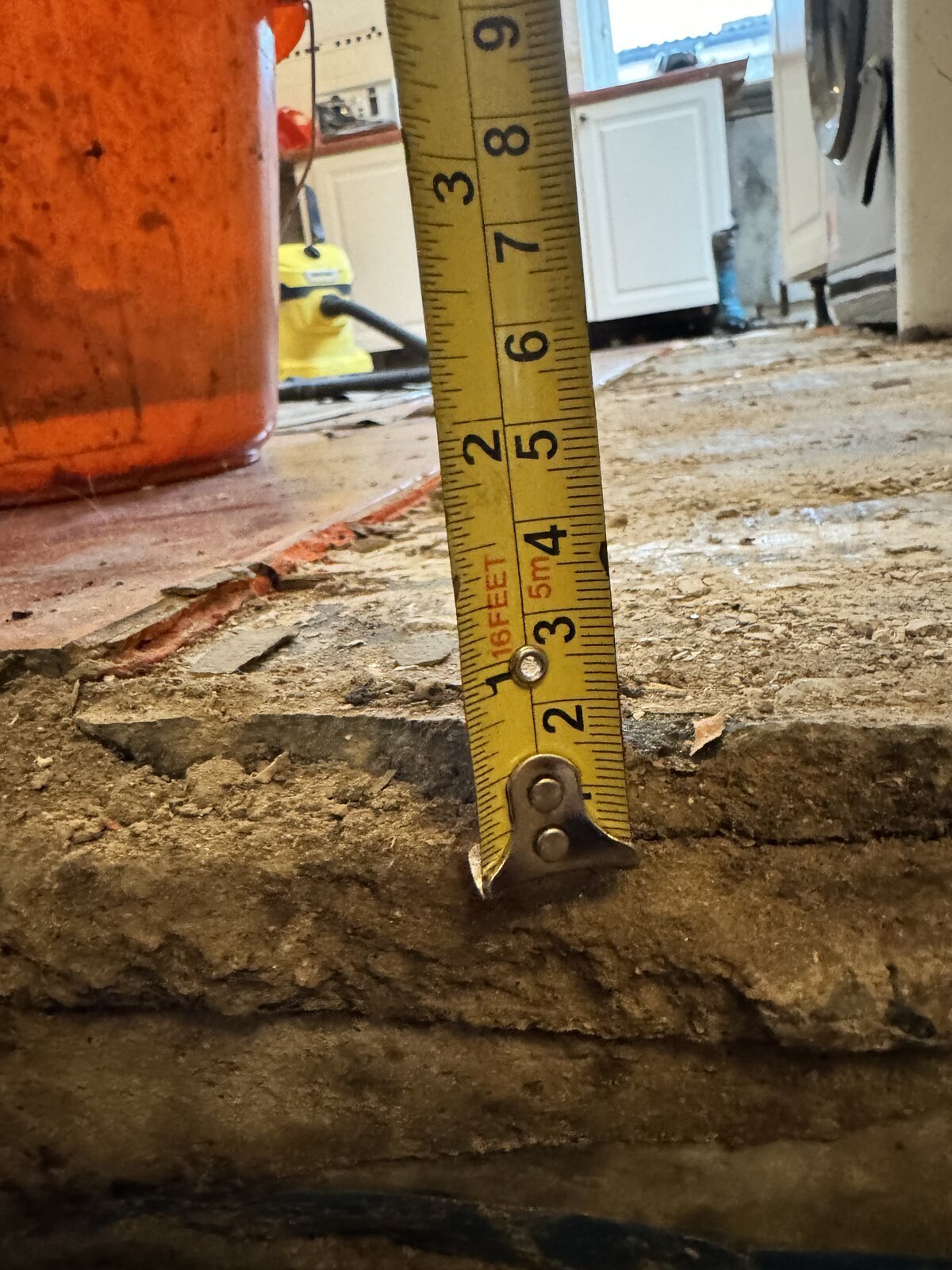

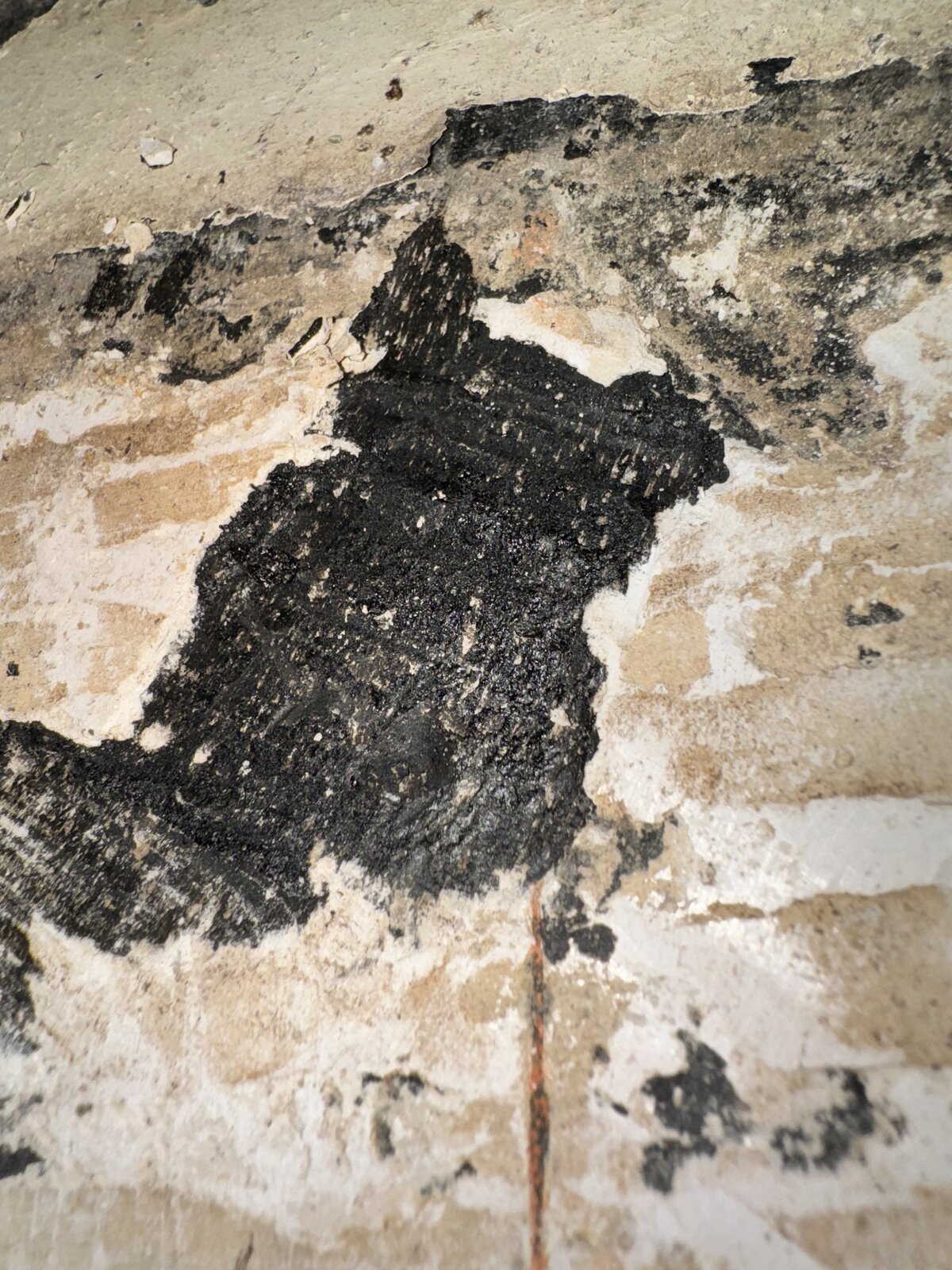

My issue is upon taking the tiles up to begin work I’ve come across this asphalt like substance which I’m presuming is the original DPC/DPM from when the house was built in 1908.
I will obviously have to carve this up to lay the pipe and I don’t want to cause any damp problems in future.

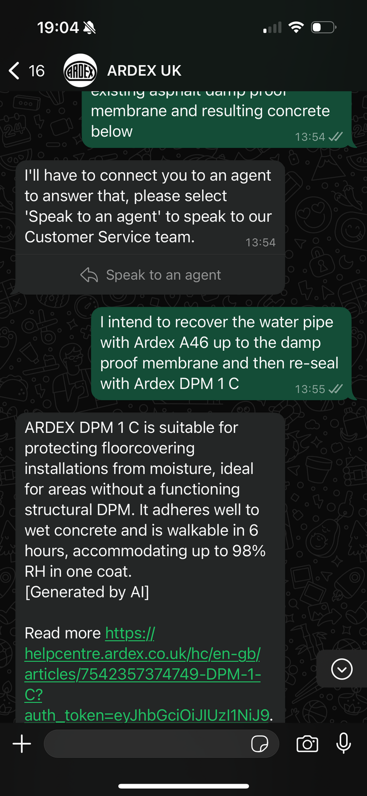

I’ve researched around and some people have previously suggested laying Ardex A46 and then revealing with Ardex DPM 1 C.

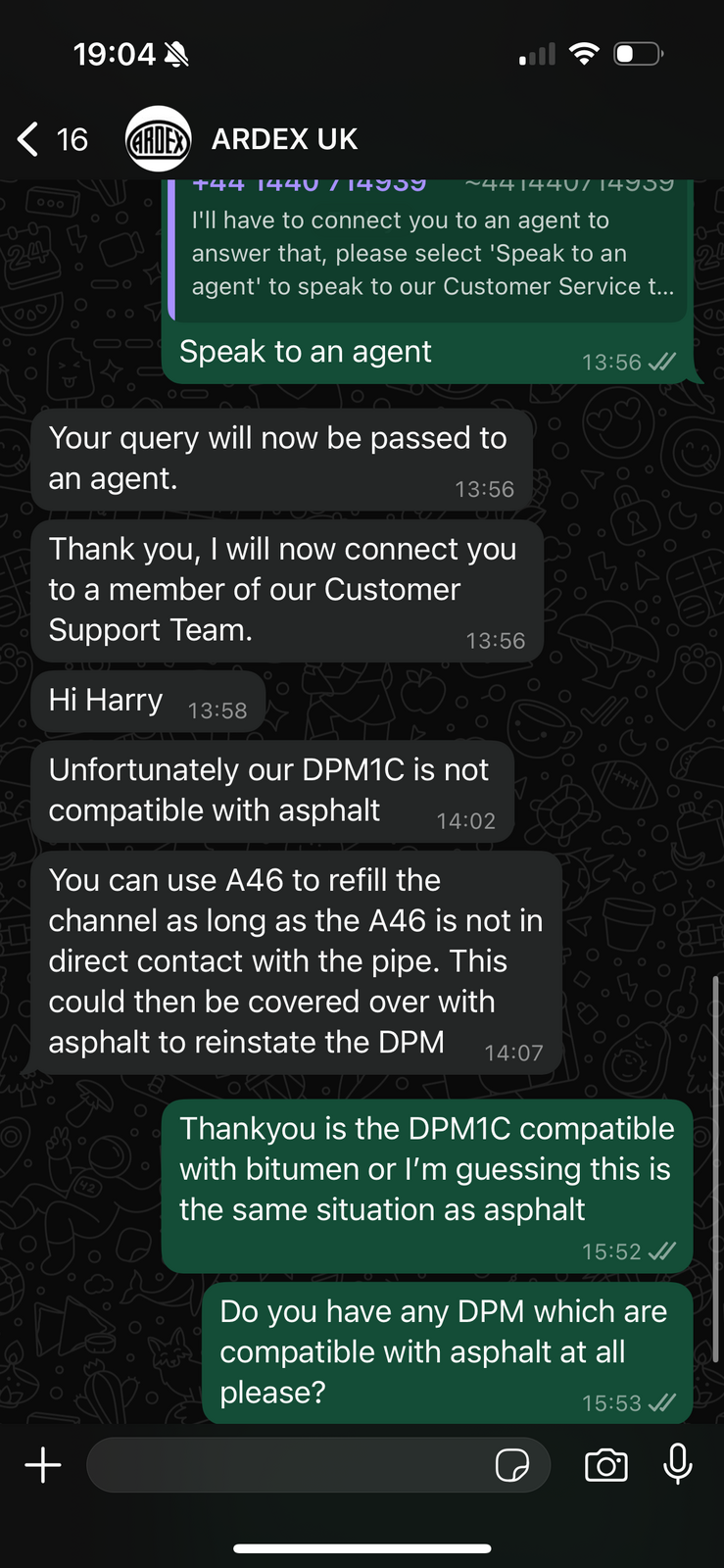

However after a chat today with Ardex (see attached screenshots) it seems that Ardex DPM 1 C is not compatible with asphalt.
What do you guys think is my best solution to maintaining this DPC/DPM, I’ve done some initial research around everbuild black jack but no idea if this is any good?

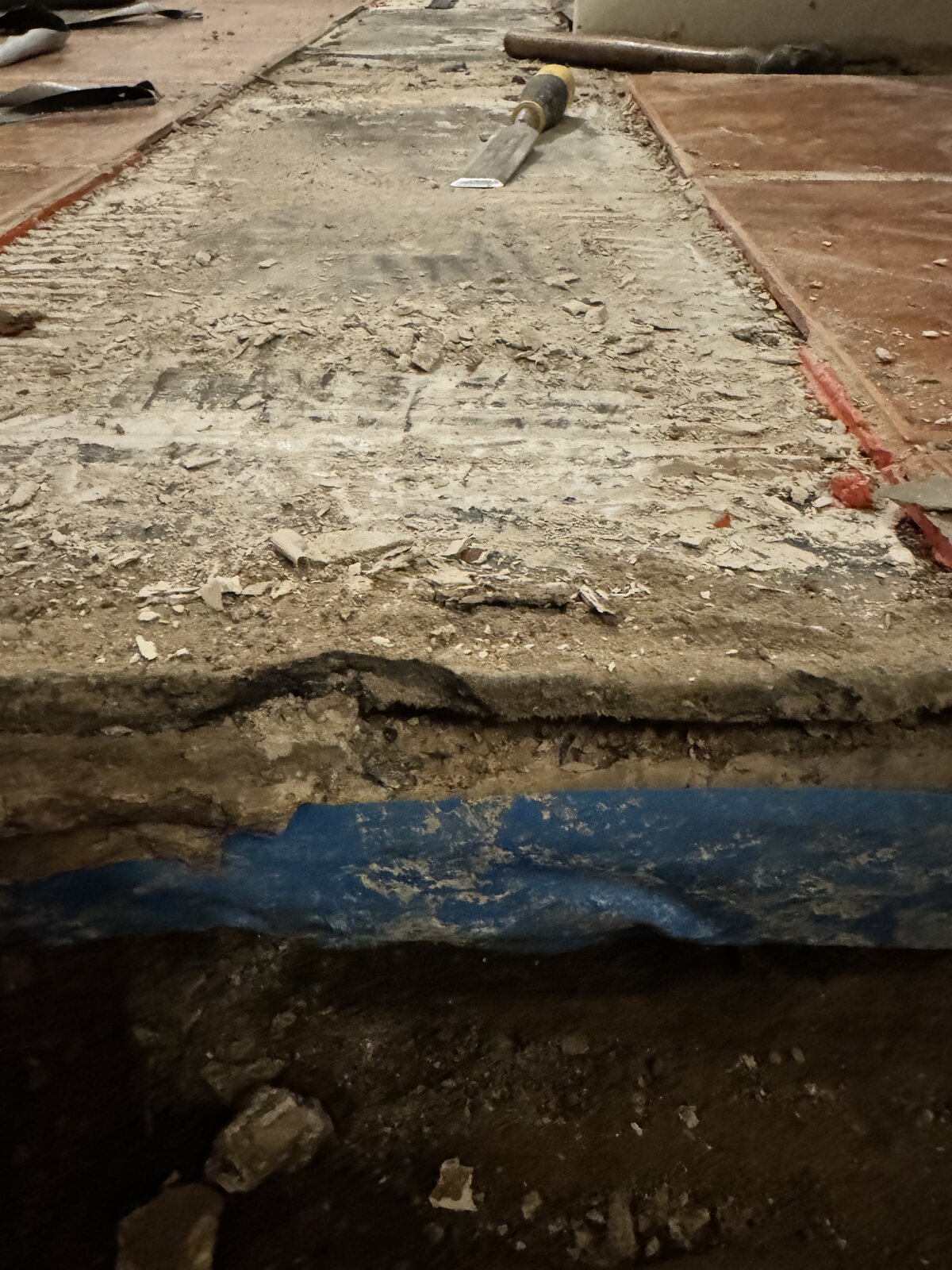

I’m aware there’s a blue plastic DPM there but not sure if it runs under all the concrete yet.

How thick is the asphalt ? It’s hard to tell in the picture. If you scratch it it should show black.
It should be 15-20mm thick. If it’s old mastic adhesive it would be 2-3mm thickness.

Hi Daz, thanks for jumping in here I’ve read quite a few of your posts on similar issues previously which were very useful and you introduced me to Ardex haha.
I’ve attached a photo here, the asphalt is about 15mm - definitely more than 2-3mm.
It’s all pretty solid currently but not sure what condition it’ll be once I’ve ran the breaker through it.
It’s actually from one of your posts I got the idea of using Ardex NA and then Ardex DPM1C but I was a bit put off when I messaged Ardex yesterday (screenshots attached) which suggested DPM1C wasn’t compliant with asphalt (where I will obviously have to overlap between the NA and existing Asphalt.

Cut the hole out. Fill in with a46 rapid.
Screed floor with ardex na at 3-5mm
Dpm 1c
P4 primer
Ardex CL or NA on top
Done it hundreds of times over the last 30 years.
