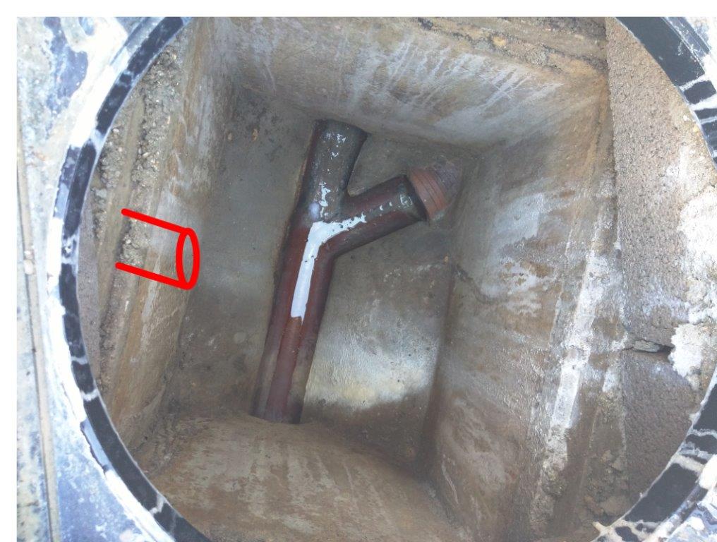

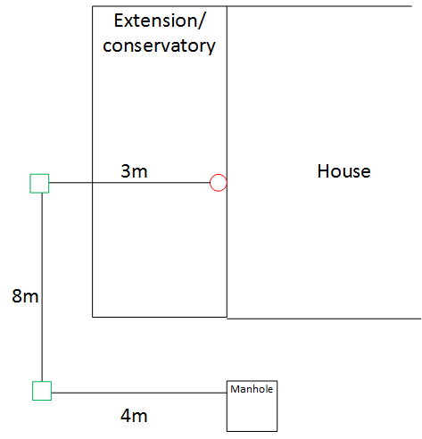

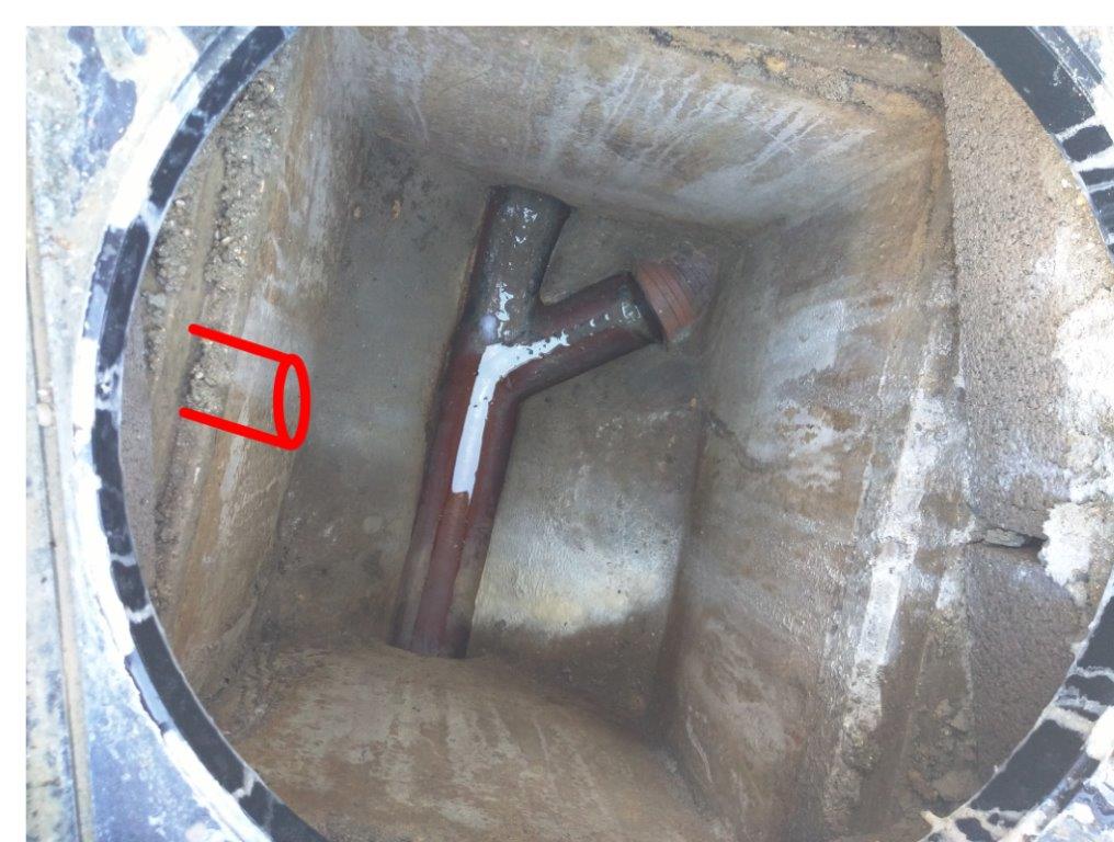

We would like to convert part of our conservatory into a utility room, which means digging a new drain. The drain will need to take waste from a sink, and washing machine, but no toilet/shower.
Plan so far is to dig a trench as per the diagram below, to an existing manhole. Piccie of manhole attached.
Fall will be 1:40
Plan to then fill trench as follows
1. 100 mm of pea gravel < 15mm
2. 110mm plastic soil pipe
3. 100 mm of pea gravel from top of pipe
4. backfill
My questions are
1. Do I need to provide rodding access at each change in direction (green boxes). If so, do I get a bend with an access port like this? http://www.wickes.co.uk/Wickes-110mm-87-5-Deg-Access-Bend/p/133866. How do I get access to the access port from the surface?
2. The washing machine will probably connect to a combined trap on the sink, so there will only be 1 40mm waste pipe going into this new drain. How do I bring the 110mm up above ground (red box) and connect the 40mm pipe to it?
3. How best to do the additional connection into the manhole. The pipe will come from the left. Can the pipe enter the chamber just above the benching on the left hand side?

Why are you doing such a convoluted route instead of just straight down the extension and out the front?
The changes of direction will need ridding access via a mini chamber.
For the existing manhole you'll need to look at this and remember you've a foul manhole: http://www.pavingexpert.com/drain05.htm . Is that a dead leg at the top of the picture?
Hi Mfarrow. The direct route would be through the existing kitchen, so more disruption.
The top feed into the manhole is from the Kitchen - sink, dishwasher, washing machine.
The right hand side feed into the manhole is from 2 bathrooms - showers, sinks, toilets.

If there's a huge difference in the invert levels of the new & existing drains? You could always fit a 'drop shaft' or drop manhole as we'd call it, on the existing manhole. The straight route would be 100 times better as stated.
