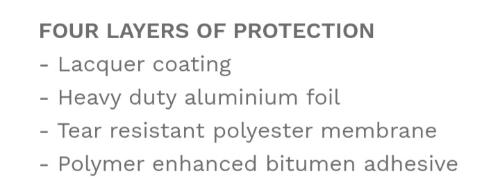

'flashing tapes'(like Flashband) have a similar construction, and maybe are just a bit thinner - or is there some other fundamental difference?
According to Bostik:
And a thickness of 1.3mm.
Ubiflex has a thickness of between 2.3 and 3.5mm
The fundamental difference to me - floppy and sticky Vs stiff, (relatively) self supporting and unsticky! :)
According to Bostik: .... And a thickness of 1.3mm. .... Ubiflex has a thickness of between 2.3 and 3.5mm

Not sure that the aluminium layer in flashband would take kindly to being mortared over, and that's the layer that would give the UV resistance to stop the sun destroying the rest of it
It's a while since I last handled, or had to hand, any Flashband, but isn't the aluminium layer below the 'rest of it' which may need to be protected from UV? I'm not sure what sort of 'not taking kindly' you are thinking of. However, even if the aluminium were exposed, and there were some chemical problem with mortar, one could presumably use some sort of sealant/mastic instead?
