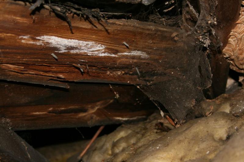

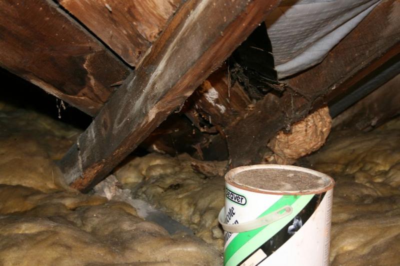

Replaced the boiler this spring, and now I've got a leaking lead valley :(
From the inside, you can see the bottom foot or so of board is visibly rotten (~12ft- 13ft length), and there is a small amount of water ingress. Outside, the lead has been gone over several times with bitumen and generally isn't in particularly decent shape.
There are also couple of tiles which require repointing at the same time.

Ought to have some inside piccies too? I can't feel or see anything rotten other than the obvious board (The stuff on the rafters is surface crap only, although I can't see/ feel the tops of them)
I'd get those rafters treated by a specialist while they are exposed.

Treated for what?
I've got a dry rot guarantee somewhere dating from the 1980s when the roof was replaced if that's what you mean?
Access isn't bad, if a little narrow. I'll try and get a picture at some stage tomorrow.
Cheers
Get the rot guy's back to check.
Probably just wet rot from the leak, but does not look healthy to me..

With regards to the stuff on the rafter, it's all surface crap as far as I can tell, plus some detritus from wasps nests. (The one at the right of the picture is the second I've had up here, both killed appropriately)
Sounds like you've had a pretty reasonable price at £850+vat - and using code 5 lead, all the better.
Companys that are able to offer insurance backed guarantees would normally charge around £25 for this (sometimes included in the quote).
It's a pretty simple thing to give the timbers a quick coat of Cuprinol or something similar when they're exposed during the work - certainly wouldn't do any harm! Unless they have gone too soft due to the wet rot, then you'd need to replace.
