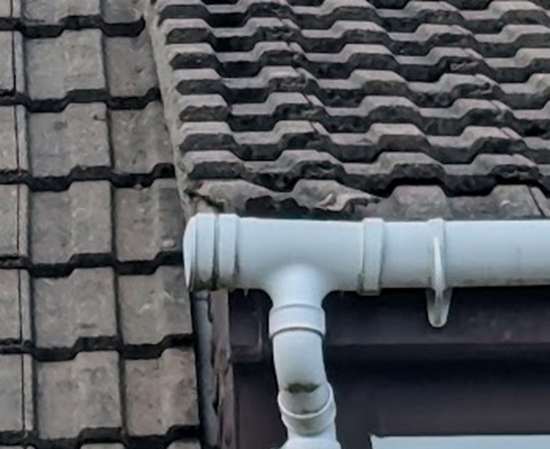

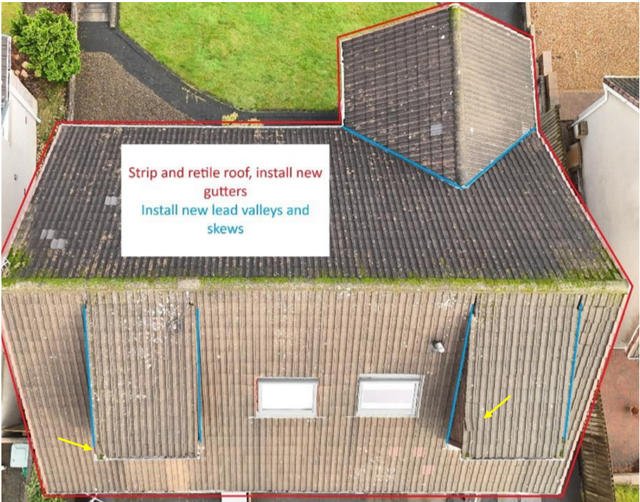

Sure, here’s a photo from a drone survey done by some roofers. I’ve add a couple of yellow arrows to highlight two tiles that are loose on the dormer windows.
Here’s a better look at the loose tile shown by the left arrow

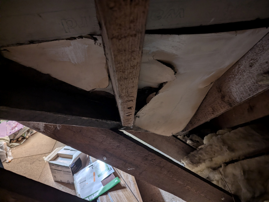

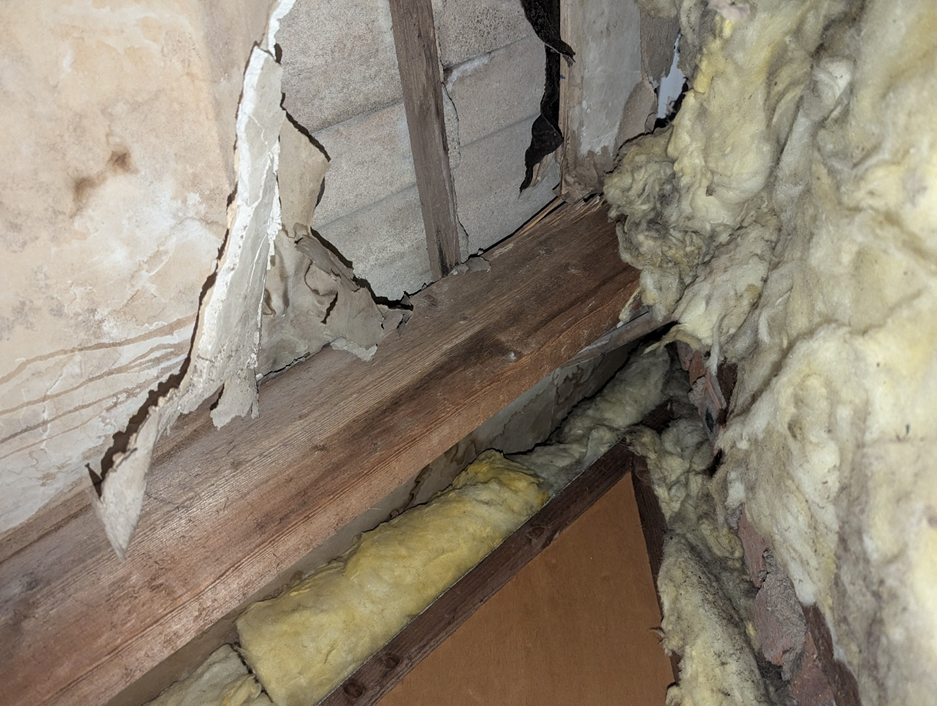

Here’s a couple of photos of broken internal boards, also missing membrane layers with tiles exposed internally. First photo is by the valley at the front of house (top of drone photo). Second is under a velux window at the back.
