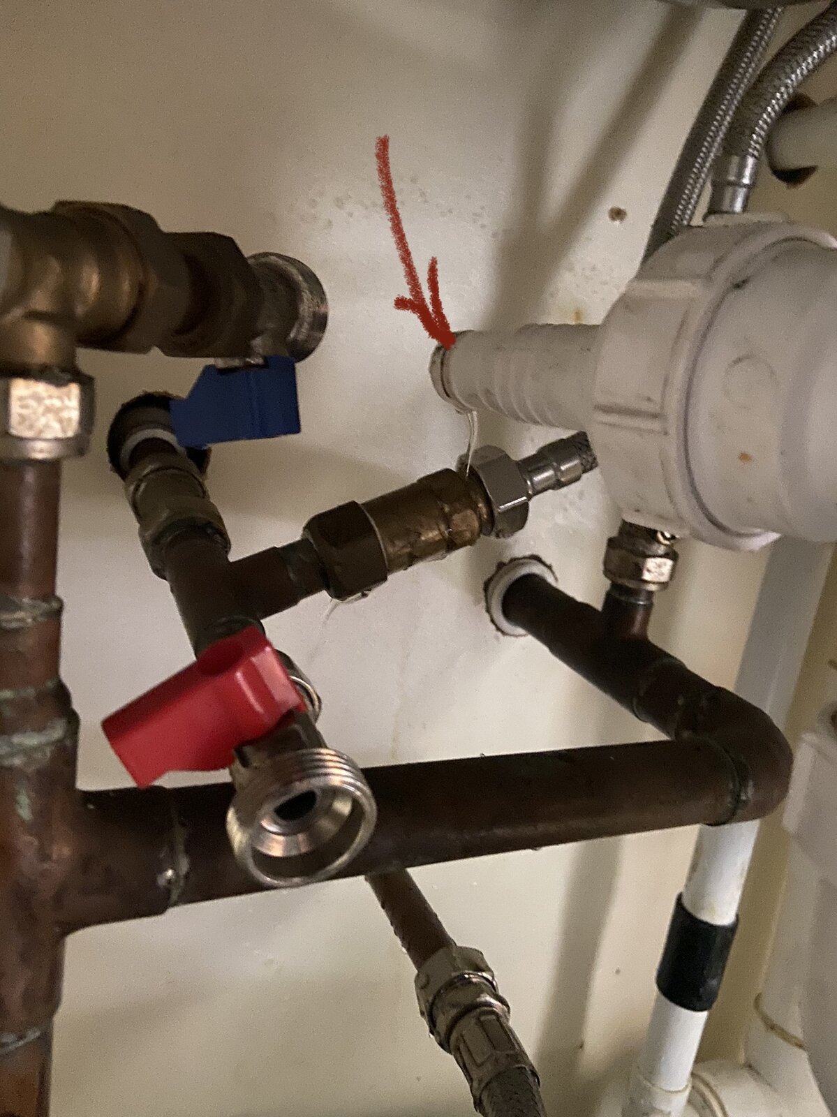

Hi we sold our washing machine but now when we use our sink we have a leak. Any idea what we need to stop it?
thank you.

Yep, that's where the washing machine drain connected to.....either block the hole up with something (cork, silicone) or you can buy connectors which have the end blanked.
John :)
And while you are at it, buy and fit a blanking caps to to the open ends of the valves with blue and red handles respectively, e.g. Screwfix 39553. If either valve gets knocked, you will have a flood.
