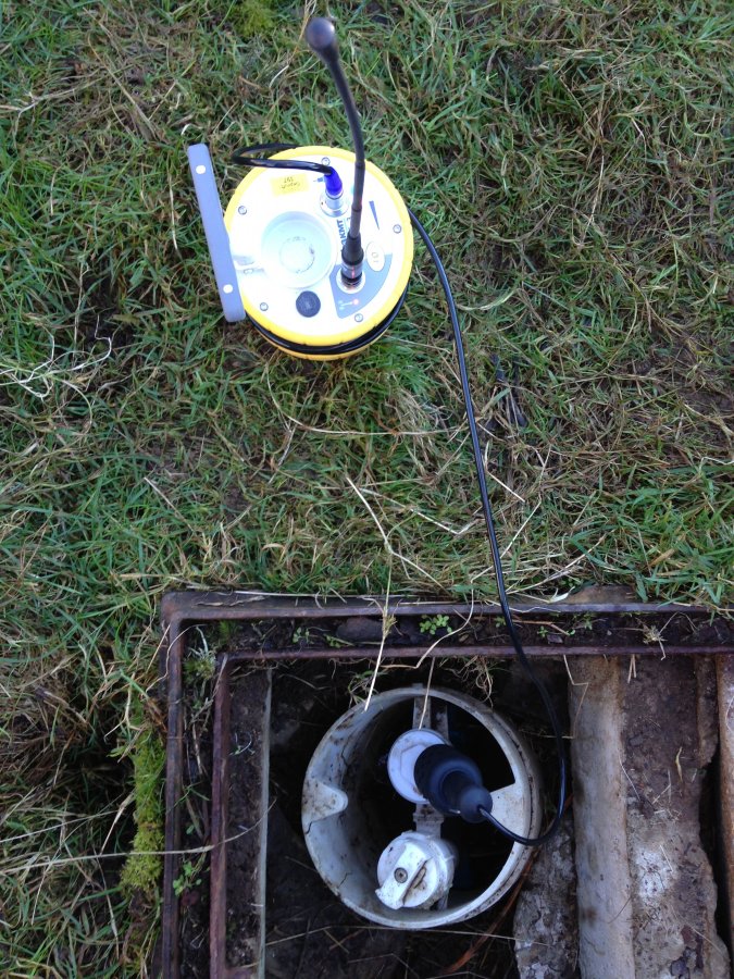

11tons!!!! The equipment you mention sounds very much like the Correlator I used yesterday. You input the size, material and length of the pipe and then put upto 8 sensors on any accessible sections.
When it starts to listen to the pipe it shows something similar to the earth quake measures (can't think what they are called this early), and the area most disrupted should be your leak. It Told me that on a 350mtr pipe that the leak is 200m from sensor 1 and 150m from sensor 2. That was £6000 but then finding the pipe was another story. Also the leak was a litre ever 30 minutes which didn't help.

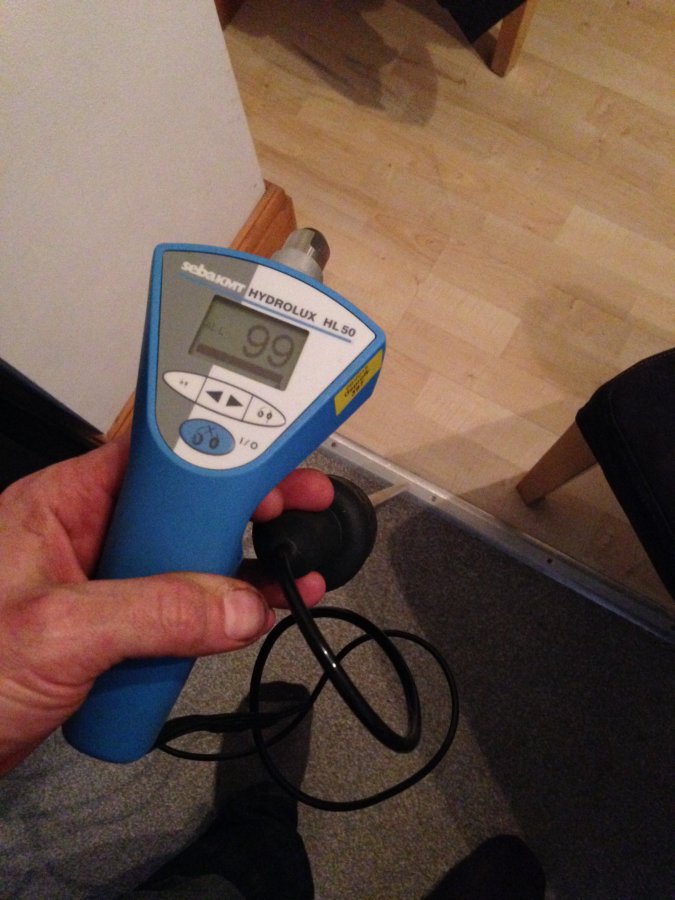

This is the Correlator:
And the digital listening stick:

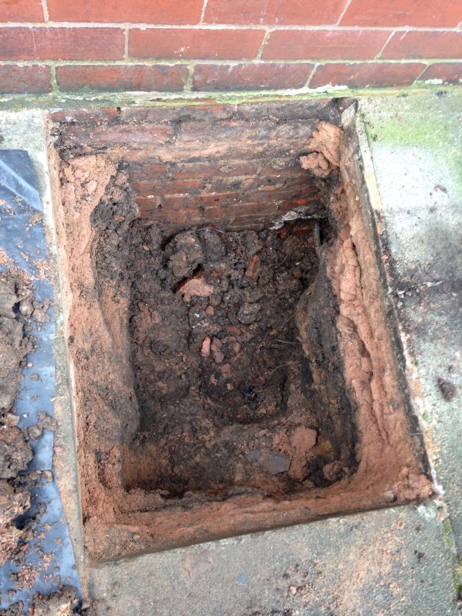

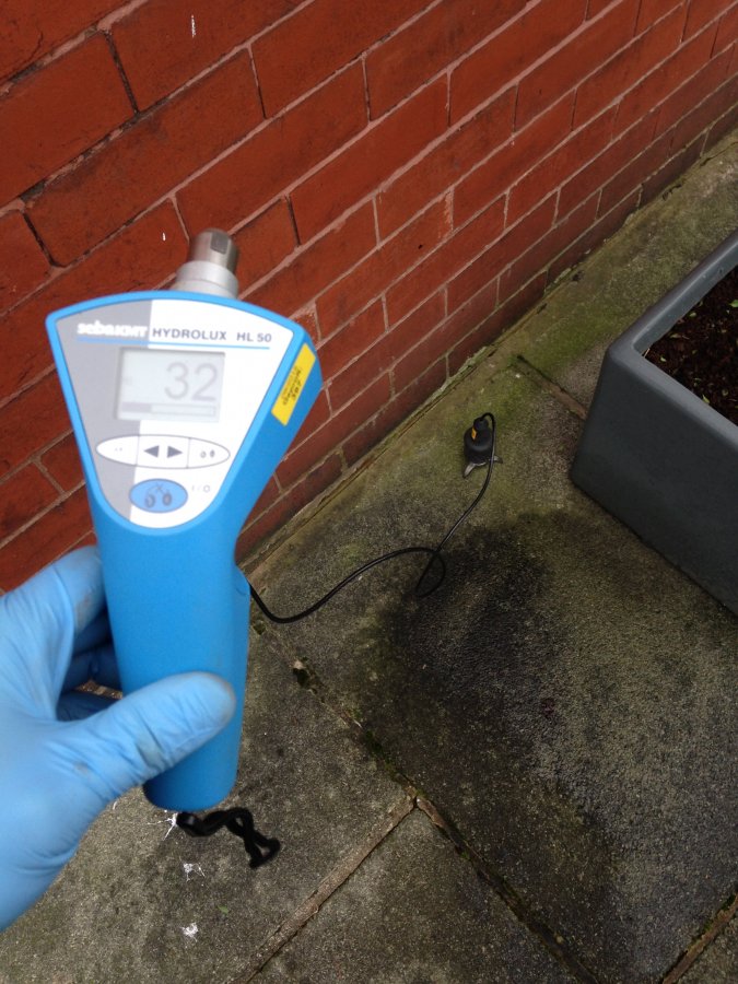

Well, first job with the fancy listener today.
First I tried with my normal retro listening stick and could hear f all. I could hear the leak pretty clear with the Seba one so had s dig and found the leak :)
Well almost, I'm a foot to the side so will have to lift another slab but I'm impressed with it so far.

Yes, I wear some wireless headphones and can either attach a rod to the wire or a claw. I put that at various places so can hopefully hear the leak and also get a read out of the noise level between 0 and 99.

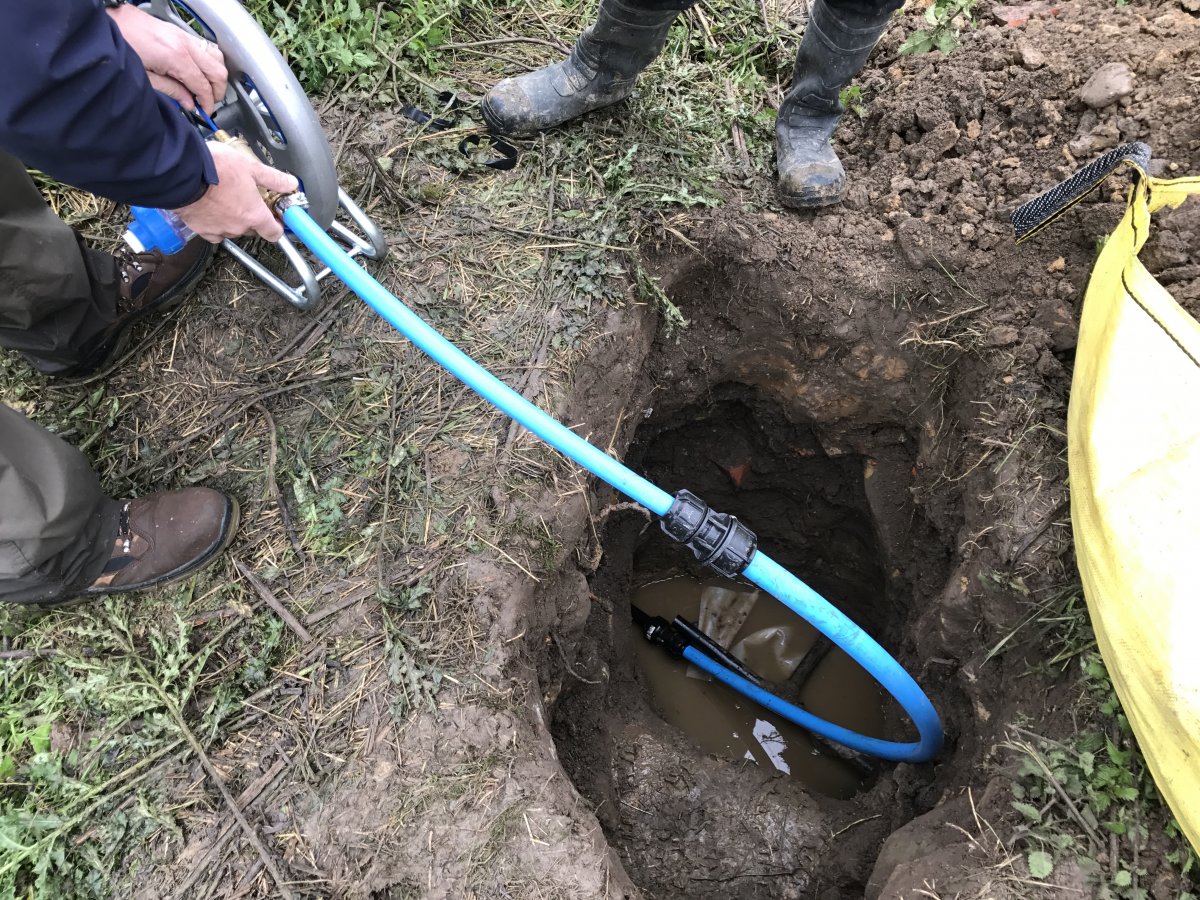

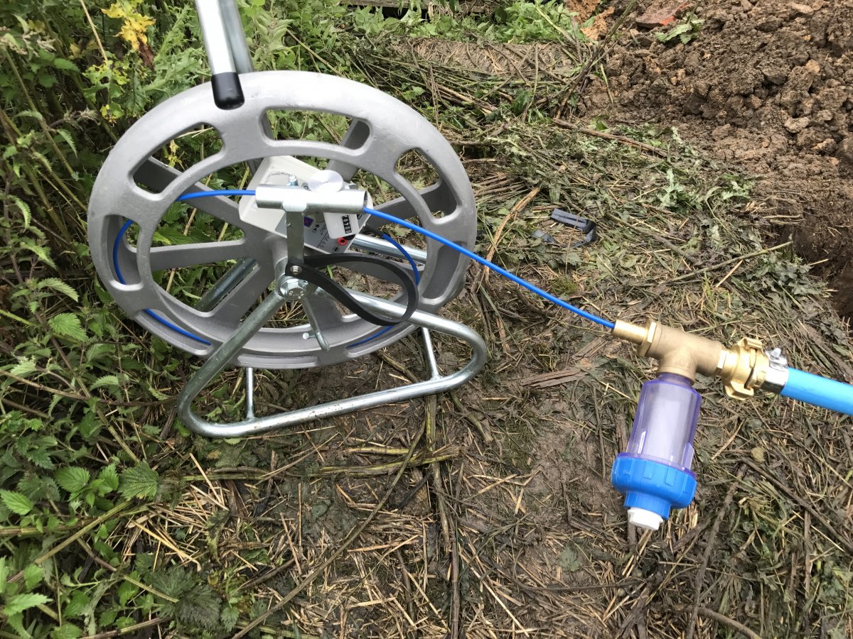

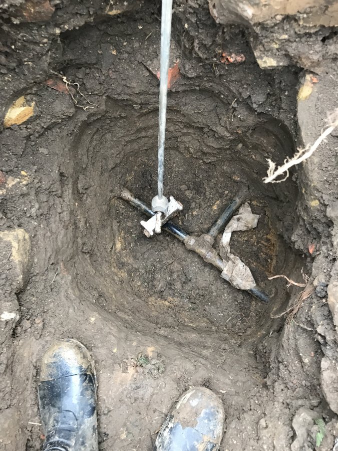

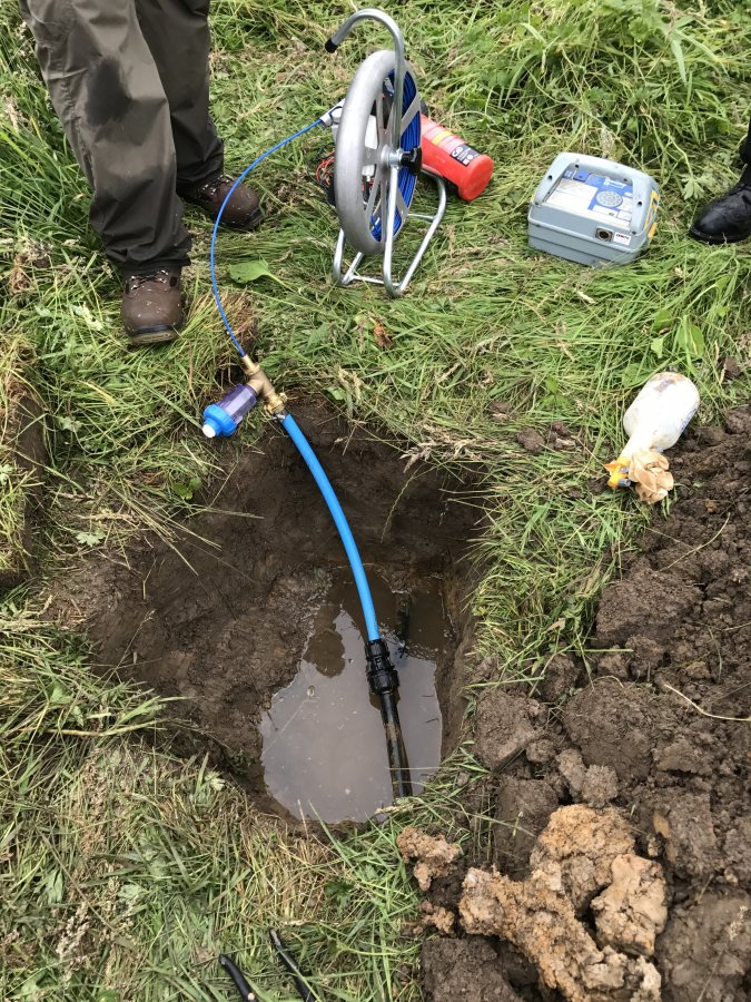

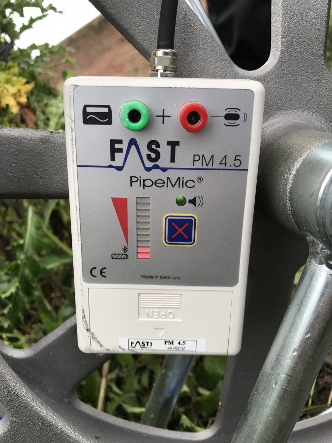

I'm playing with another bit of kit today and so far it's my favourite. It's a pipe microphone that listens for the leaks from inside the pipe.
I'm on a farm with 350mtrs of pipe and no visible sign of the leak. First I put my trace wire down a 32mm pipe in one of the stables because the farmer knew that it tee'd off the main supply.
I found the tee and confirmed the leak was between that and the meter by squeezing off:

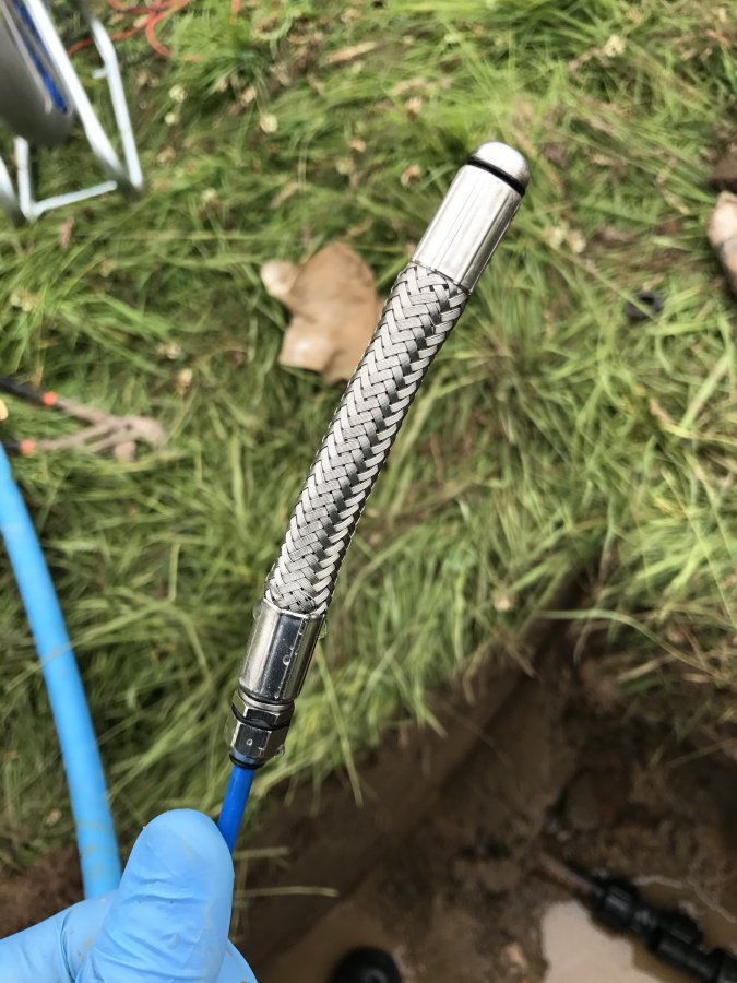

Then we cut the pipe and connected the PipeMic, on such a long run it is trial and error.
We can do 50mtrs at a time and we can trace/probe the Mic head on its own or the entire cable if we are unsure of the line. This is how accurate it is over the 50mtrs:
I'm very confident we will find the leak once we get within 50mtrs of it, on the majority of my jobs that would need a dig for access and a dig for a repair. If a modern meter is fitted I could take that off and listen from there.
Only thing it the pipe needs to be 25mm to fit the PipeMic in.

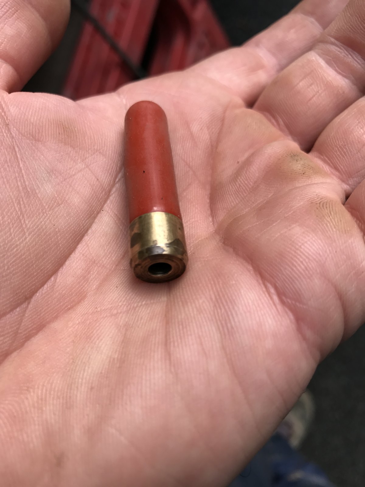

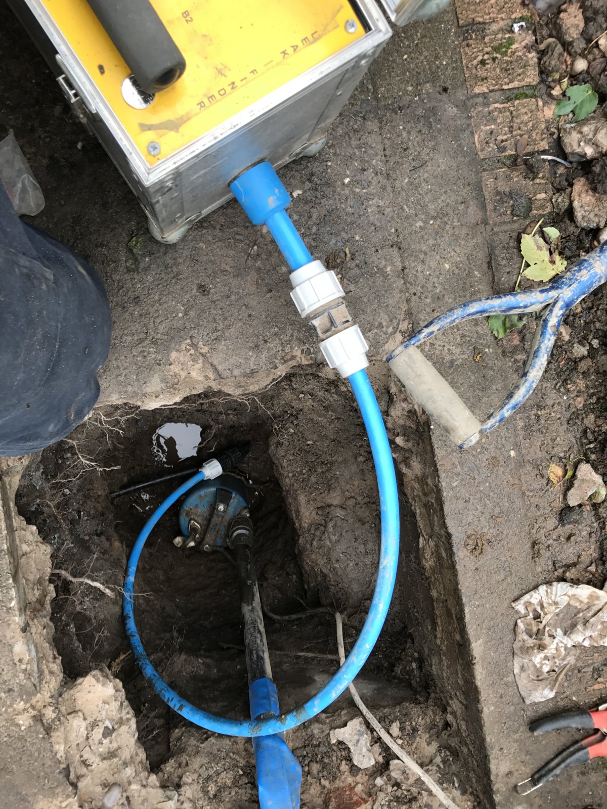

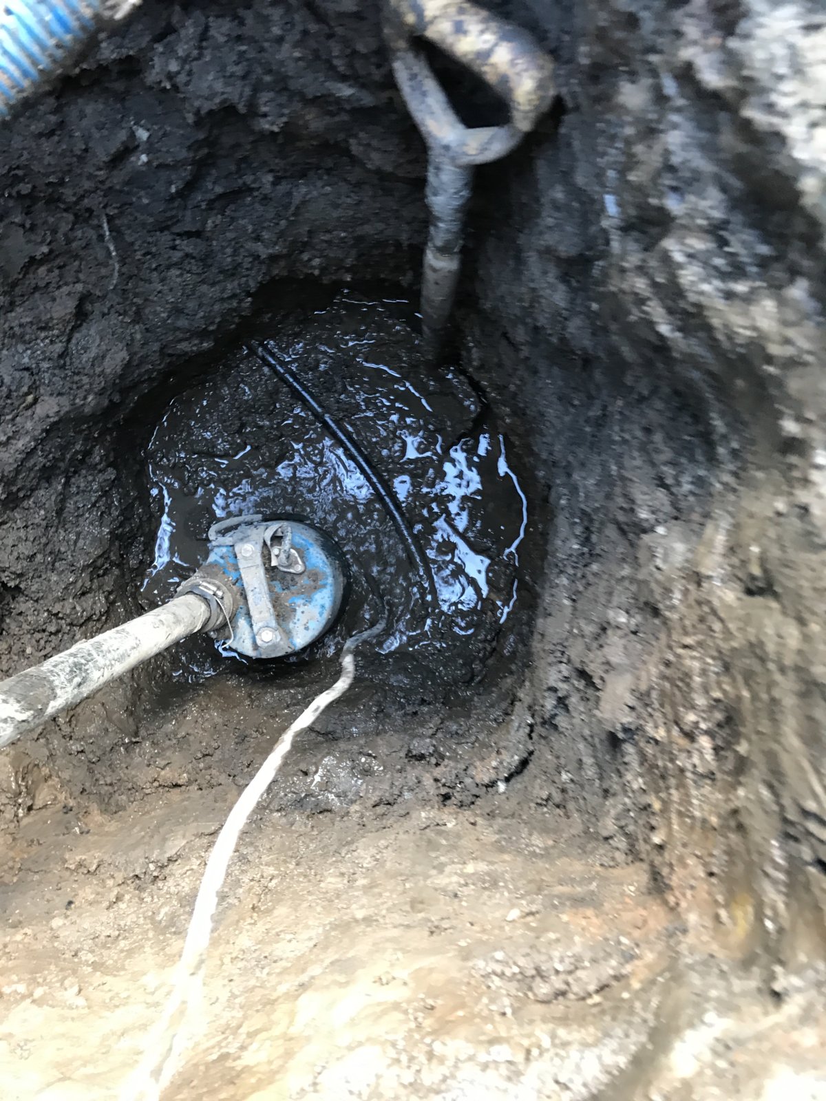

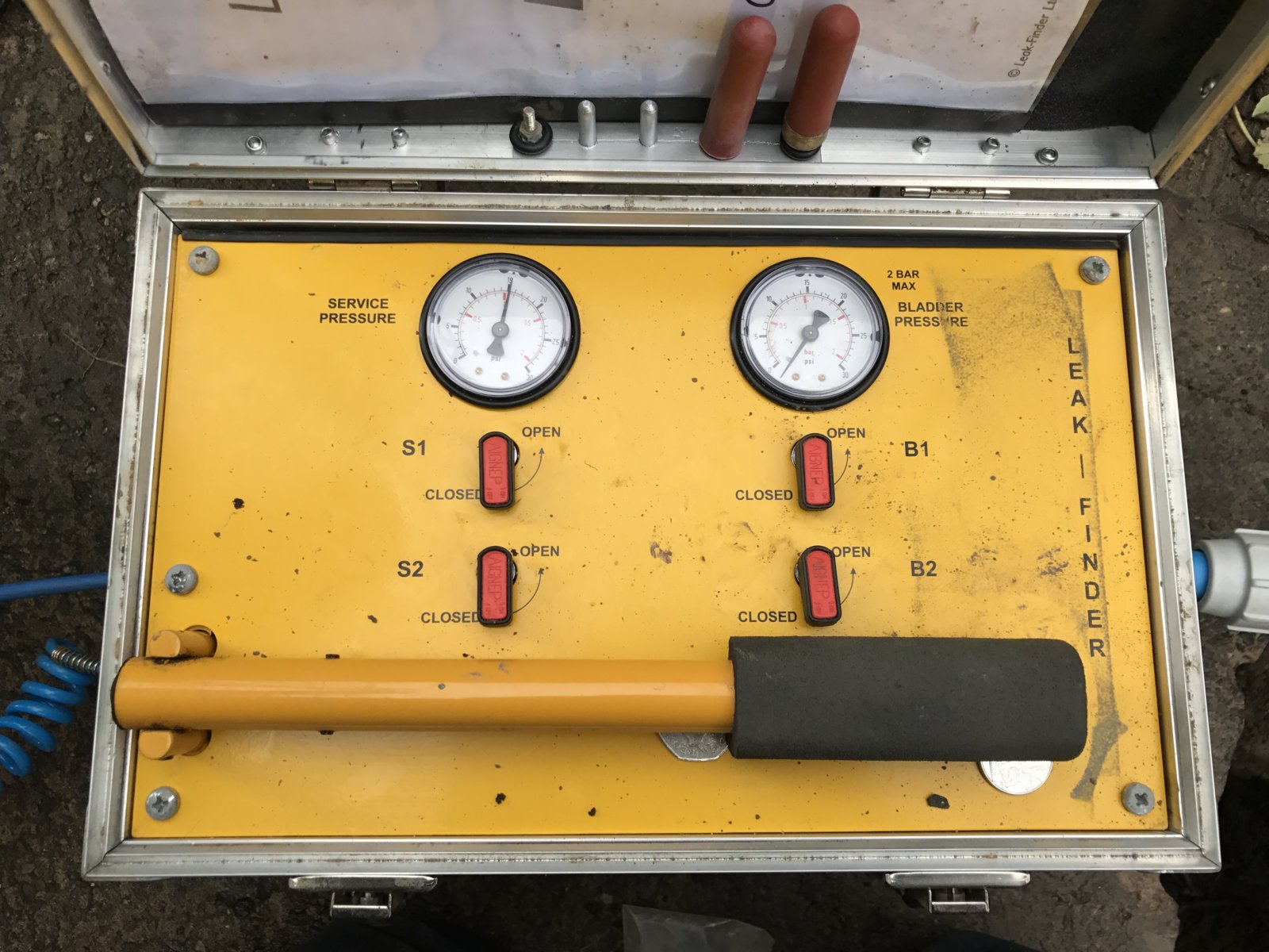

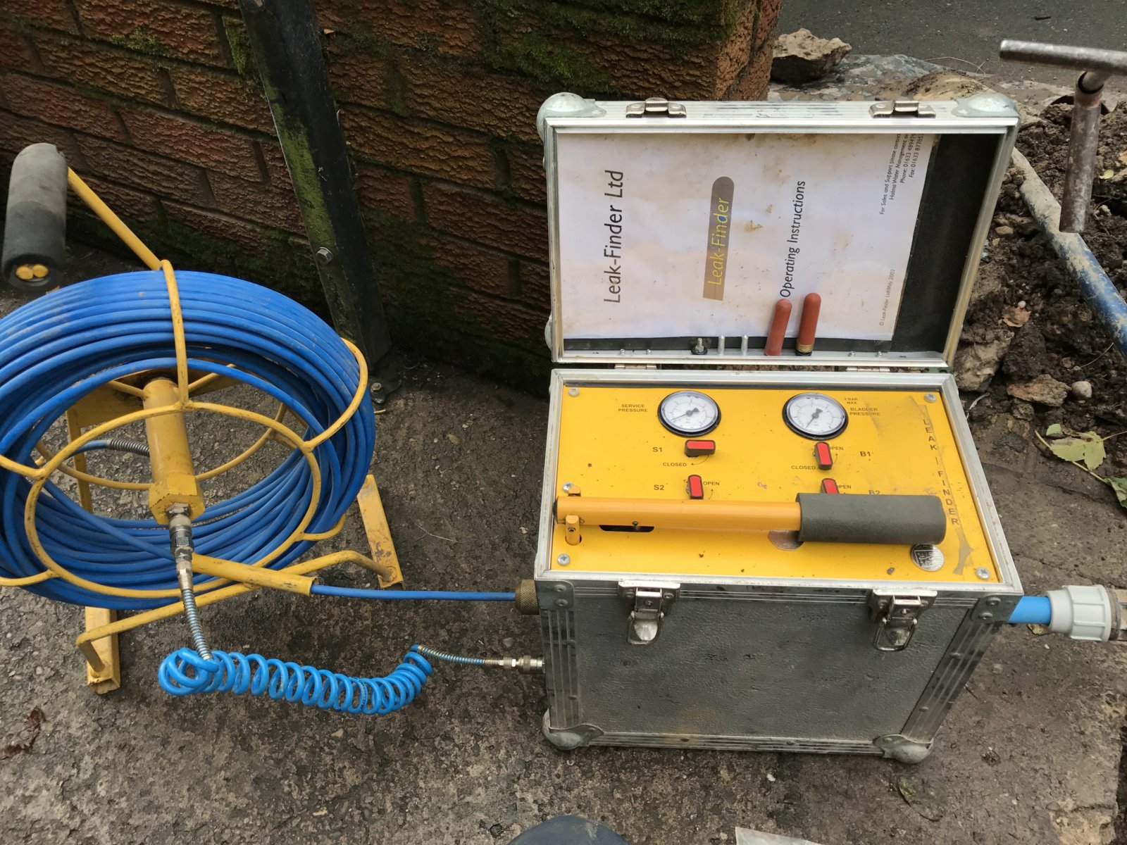

This is the old school pressure tester which I'm using today. The pipe is 1/2" black alkathene so the PipeMic is too big.
We dug onto the pipe near the house and squeezed off which showed the leak was outside.
Then we connect the machine to the supply pipe and push a balloon (called a Bladder) down and inflate it, after twiddling a knob we then put pressure into the supply pipe. If the supply looses pressure you know you have passed the leak. We try and locate it to with 6" then dig and replace 1/2 a meter of pipe to make the repair.
Couple of pics:
Machine connected to the supply
The machine and Bladder hose:
The dials for the Bladder and pipe pressures, with the various valves to direct the air.
The Bladder itself
Now to dig where it says the he leak is, finger crossed.
