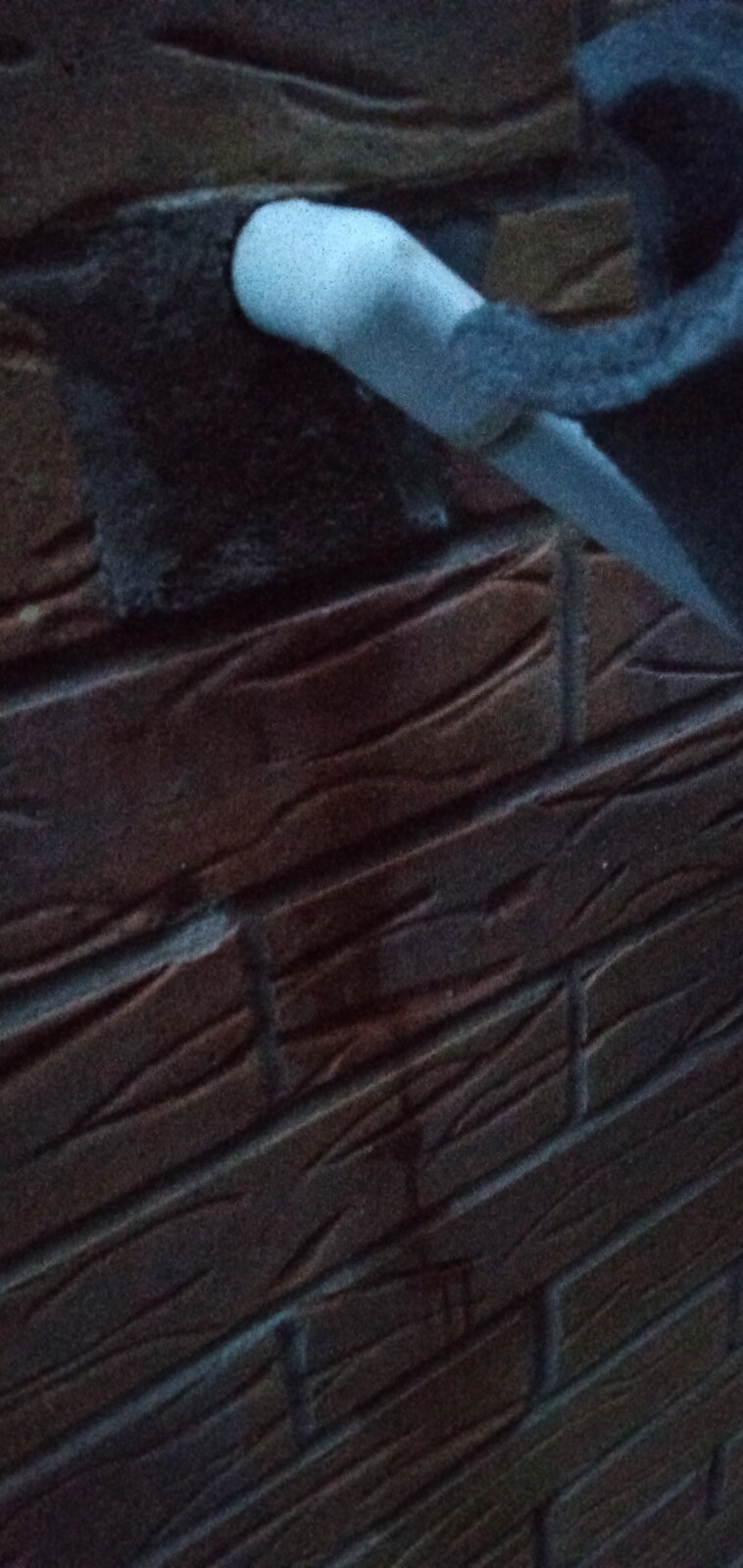

Hi all. I have water dripping down our wall rather bad no water inside just from the hole. I'm guessing I have a split in the pipe?. It's meant to be coming out the pipe. It's coming out the wall... So you think replace/cut it all out and replace plastic weld. etc ? Thanks paul

2 things, yup, the pipe needs to be repaired, probably easier to take the pipe out through the wall and replace. Also the pipe should really be upped to 32mm to reduce the chance of it freezing.

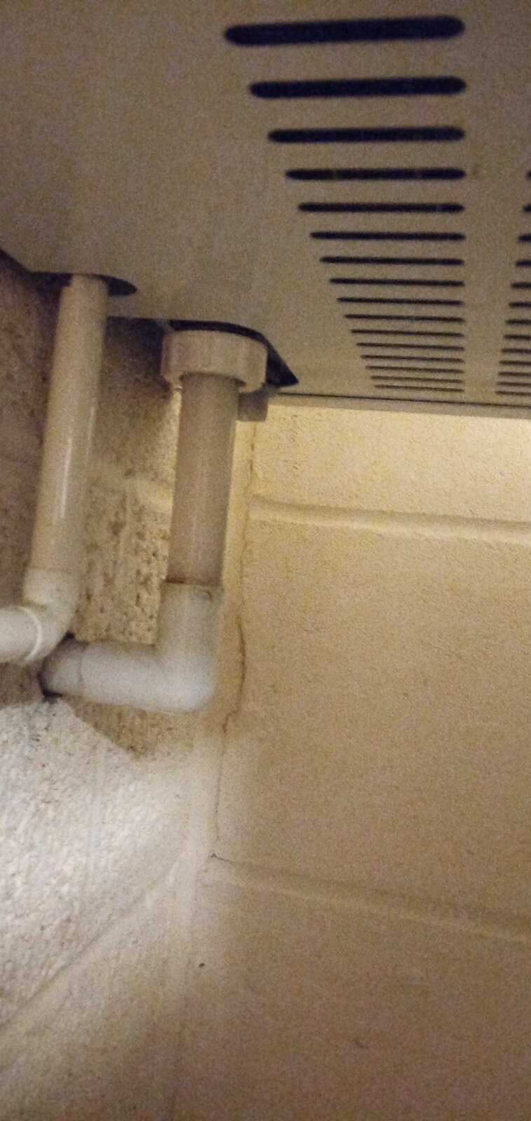

Thanks. Doesn't seem I have much room to use existing connection pipe.. what's is best way to connect new pipe

I can't seem to buy a replacement pipe to fit to boiler if I screw it up..
What's the run like outside? It may be better to drill a new hole outside to get 32mm through the wall. If possible I would keep the run inside as far as possible to reduce the chances of it freezing.
I thought that as first but it's just dripping out the wall hole were the pipe comes from ..
I'd like that and probably needs that in the future. Just rather sort way it has been ok for 10 years. First year we have had problems
Do you think I cut the pipe and re do connections with solvent.
