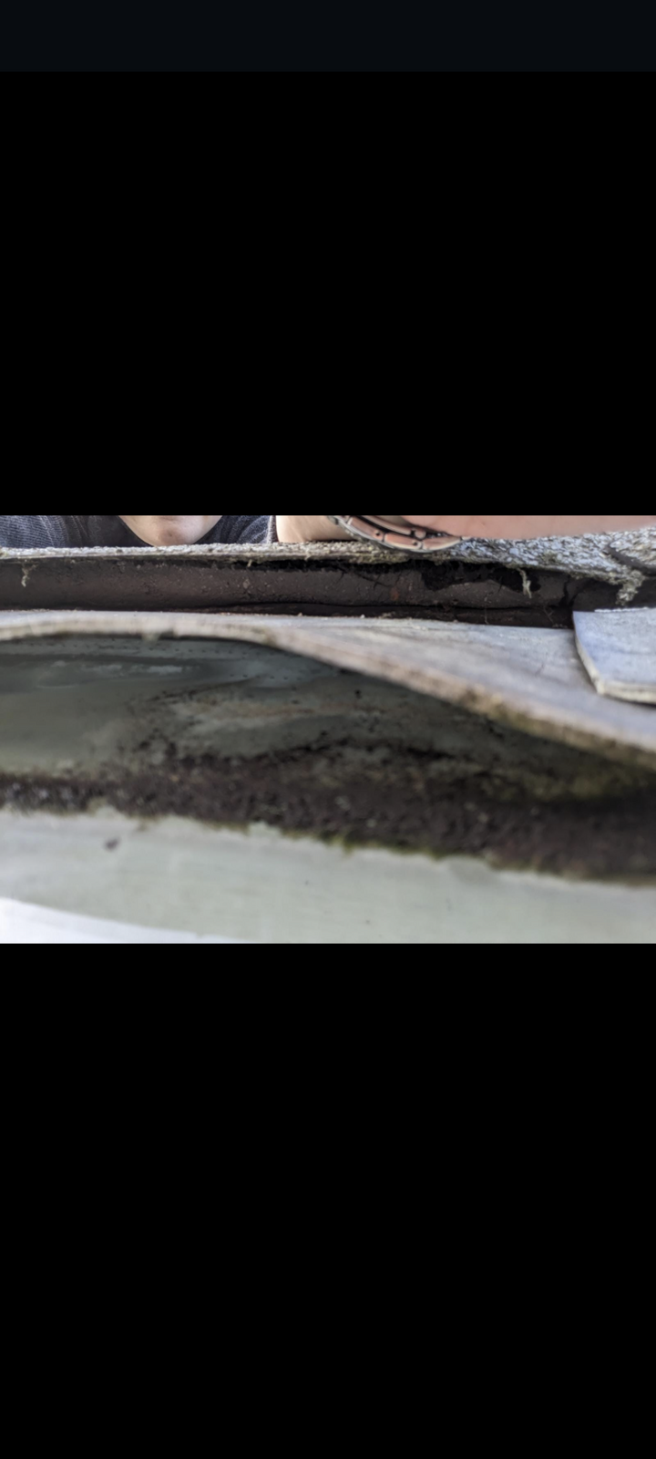

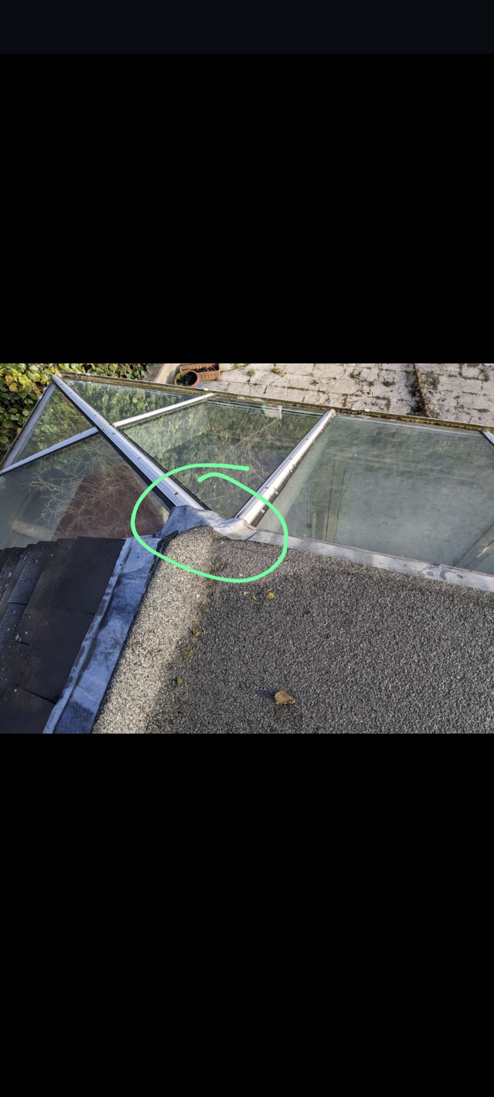

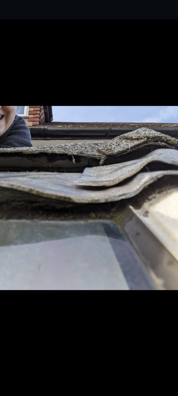

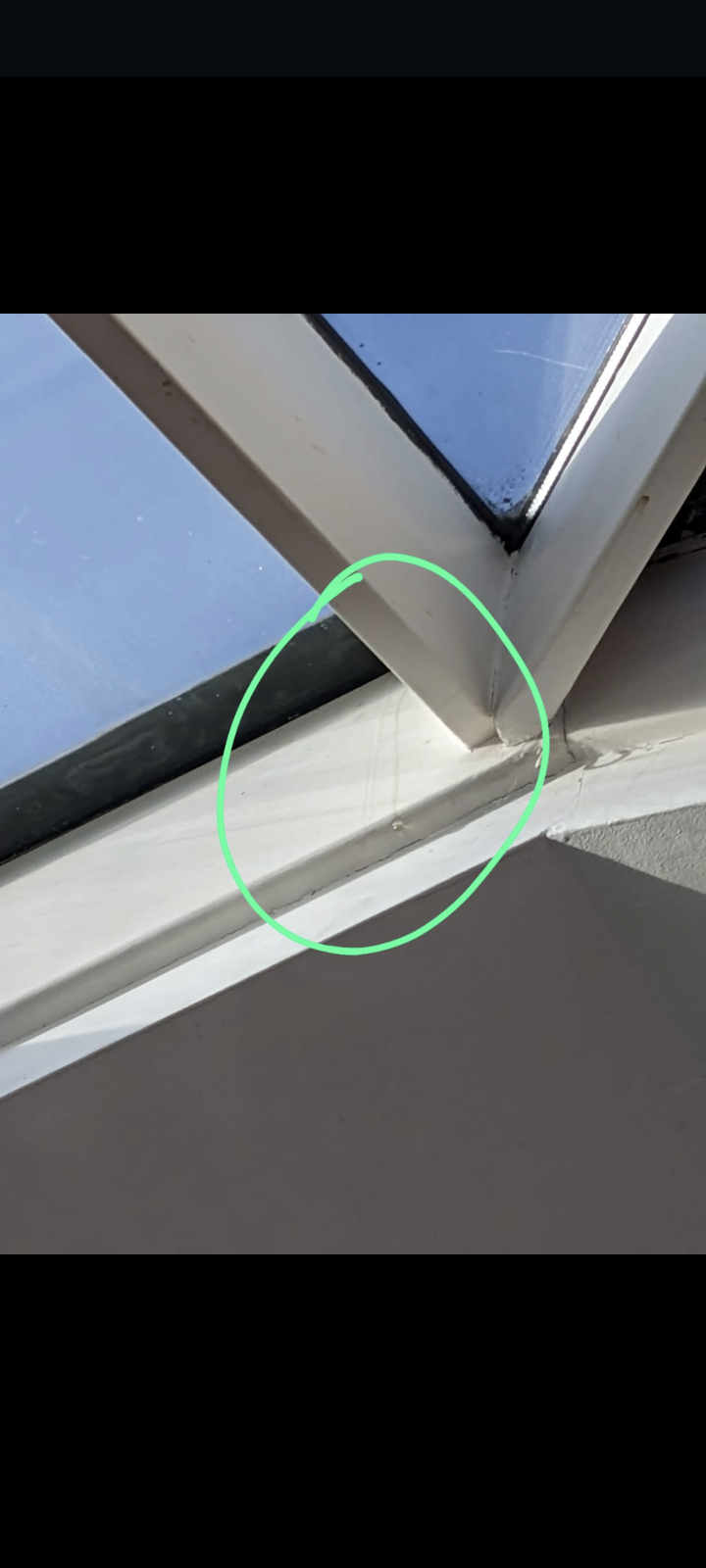

Anyone have an idea why a slow leak (5 drops of water this morning; no rain, but freeze-thaw conditions outside) would appear at the apex of this conservatory roof?
Aside from the flashing and roof surface being slightly 'away' from the window (I've since pushed them back against the window), everything else seems superficially intact.

It doesn't look like internal condensation but presumably you have discounted that. The recent very cold conditions have probably opened up a gap in the roof sealant or flashing. Just be aware the tracking of the drips may originate elsewhere on the roof.
