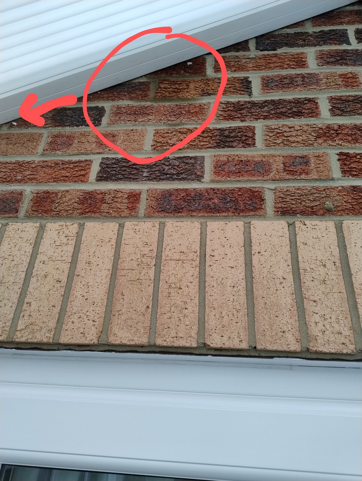

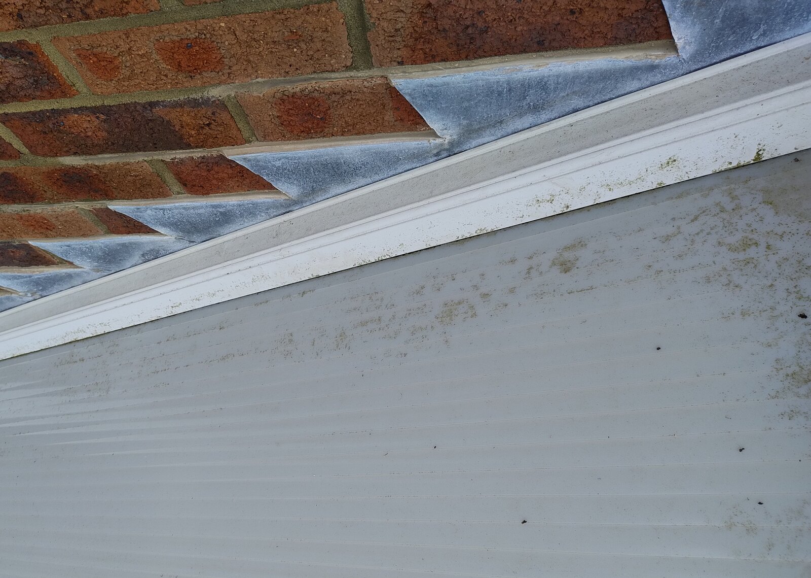

Hi folks, just noticed that my conservatory roof is leaking slightly where the roof bar meets the house bricks. Please see pics.
I noticed that the flashing is actually on the inside of the white roof bar, where as a lot of my neighbours have the flashing folded over the white bar.
Can anyone suggest what is causing this or how I might rectify it?

I'm not sure what that step flashing is doing, unless you can show us what is happening once the roof bar cap is removed. Even then, given the complexities of the roof bar itself, I can't imagine the flashing is lapped on much.
Those issues aside, damp can easily bypass the slender roof section, if rain is beating against the wall.

Thought I'd revive this thread as, up to now, I've been taking the ignorance is bliss approach. But, here we are, and it's still leaking (just a few drops in heavy rain).
From what I can tell, the flashing goes behind the roof capping and into a sort of hidden or internal gutter. This then drains down into a normal gutter on the side of the conservatory roof.
I've removed the end cap and from what I can see, it doesn't appear to be blocked.
Any help or pointers in the right direction is appreciated. I do intend to see if the capping can be removed but as it's quite old, I do worry about snapping it.

It's leaking anyway, so you have nothing to lose by removing the capping.
Or get some rubber flashing and glue it to the wall/lead flashing and overlap the capping.
If you can manage to get to it, run a bead of "Roof and Gutter seal" down corner where the capping and flashing meet.
