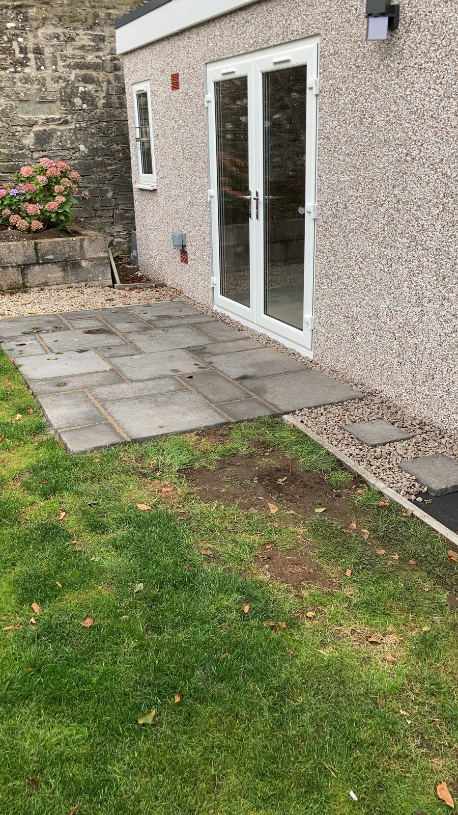

I have a patio door on my recently built garage, and I noticed that the concrete floor inside became wet after the heavy rain last weekend.
The door sits in the single skin blockwork which is rendered but underneath the door was just left as exposed block. I suspect the builders haven’t lapped the DPM up under the door on the inside. Also they roughly filled the gap under the door where it sits on the block with foam which could let water seeping through the block in. They then covered this gap with a strip of plastic.
ive attached picture. Any suggestions to eliminate this problem would be appreciated?
At the moment I am thinking:
Remove plastic strip. Seal gap under door with sealant. Once dry cover this gap over to block with waterproof tape, then replace the the plastics strip with a much deeper plastic board as far down under ground as I can get to in order to divert water as far down from doorframe as possible. Hopefully this would reduce chances of it seeping up through the block.
thanks
