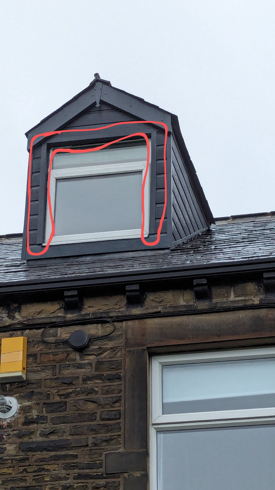

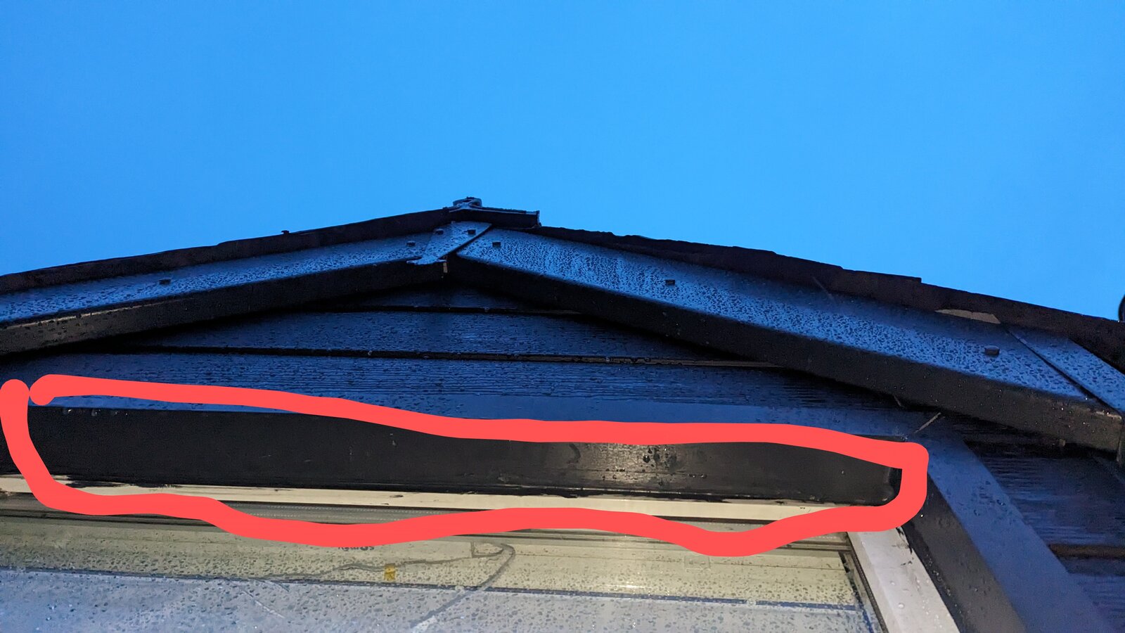

We have just had a roof replacement and the dormer re-cladded, the dormer window itself is original and was not replaced. The roof was finished last week but we have a leak under the dormer window on the right hand side into the loft so water is somehow getting under the cladding, lead and felt. The roofer is coming back tomorrow and has stated that he will be sealing up all the trim as highlighted to hopefully stop any water getting into the trim and down into the loft if this is the culprit. I feel like this is a shortcut but he is saying the cladding is very difficult to remove to look further. The front lead work goes up about half way between the roof and the window sill, no lead window tray, and felt above this and lead soakers on both sides. The window is sealed all the way round into the cladding, including under the window sill, I did the top seal as roofers hadn't done it as I thought they had missed it so wondering if the top of the window should have been left unsealed to let any water that gets into the top trim out again or should all 4 edges be sealed?
Where else could this leak be coming from?

Terrible finishing, the corner beads will trap the water running off the face of the cladding, ditto the dormer cheek. There are many ways of detailing dormer cladding to weather it properly.
I'm sorry, I don't follow as new to all this. Which are the corner beads? And our dormer before has the exact same trim and had no leaks.
The roofers plan tomorrow was the seal up all the trim around the window so water can't enter the trim which sounds like a work around but would it work as then water cannot enter? Or should I ask him to remove the cladding and have a proper look?

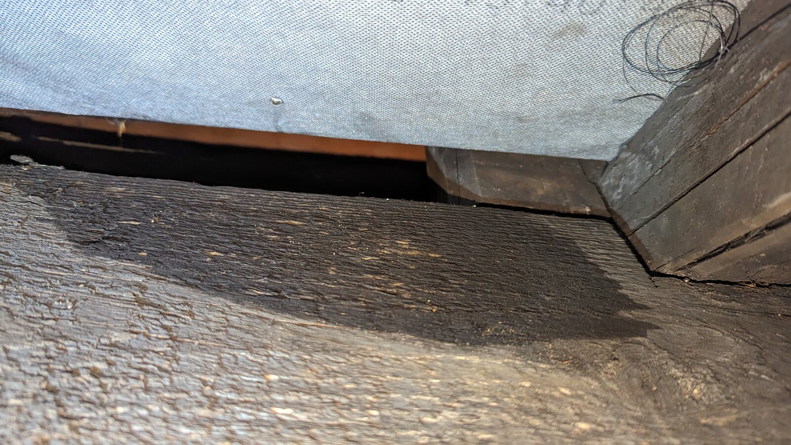

Where is the center of that damp patch relative to the cill?
Also is that a hole in the membrane directly above the damp patch?

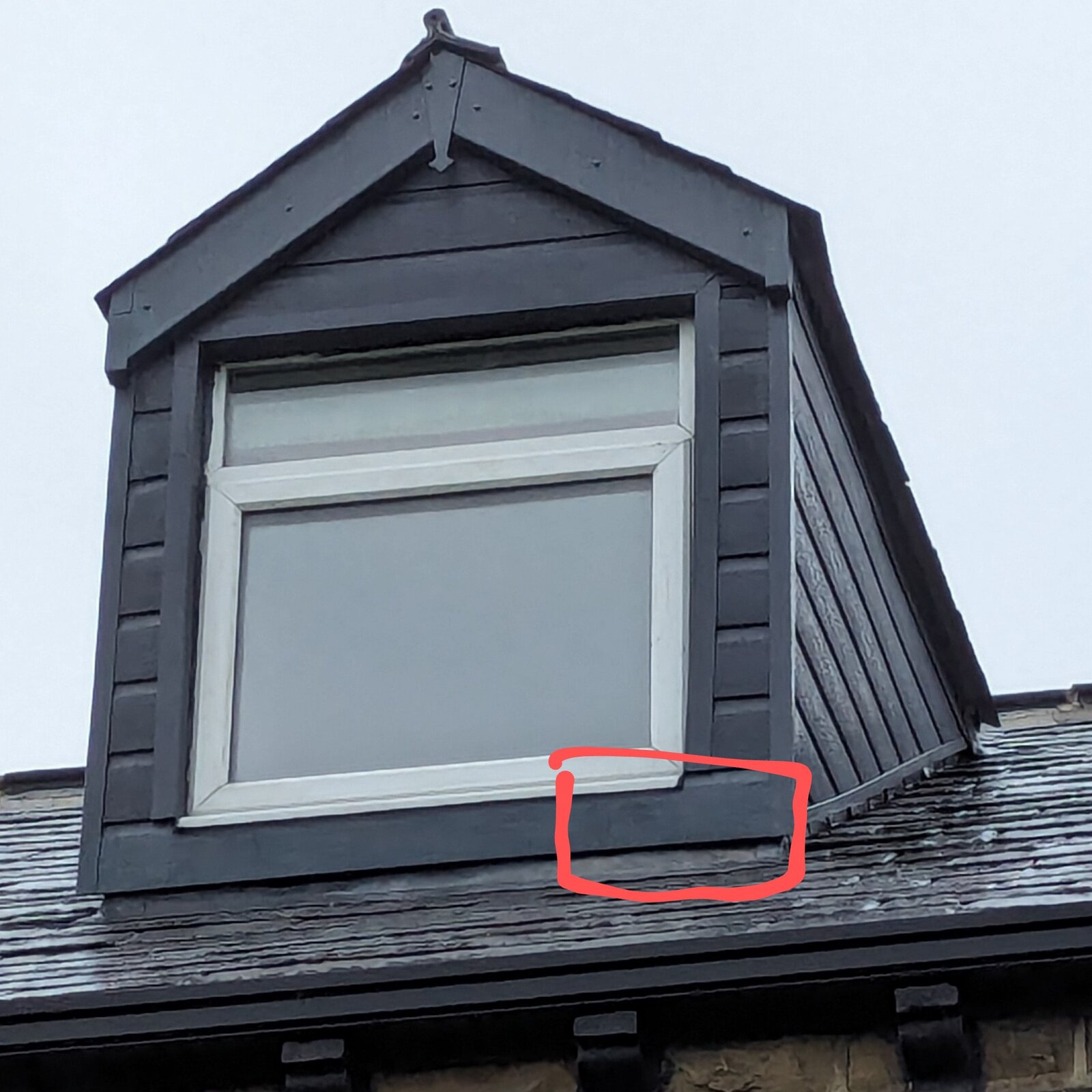

So the damp patch is at the far right side of the cill, I've highlighted it in the pictures on the first post. It's the hole under the dormer window, the membrane carries on up to the top of the cill and lead covering the top of that, then the cladding under the cill.
Our last dormer didn't have any felt under it and never leaked and now this dormer has felt under the cladding and leaks, it's ridiculous. The roofer has sealed a few loose parts of the cladding that had gaps in and will wait till next rain but if it happens again will ask him to take the cladding off and see what's happening at the bottom.
Most likely a problem with the membrane overlap right at that corner under the cill.
Rather than mess about with sealant and what can only be a temporary fix, have that bottom board taken off (plus the two small ones above if need be) and get the membrane sorted out, and flashing/apron fitted below the cill and lapped at the window reveals.
It does not look like there is enough overhang from the window cill, so rain is always going to get under it. Really, that bottom board should not be there, and the whole bottom below the cill flashed with lead.
They have been this morning and sealed round the trim and underneath the window cill but as you said, not convinced that will do much. Will check the leak again when it rains and if still there will get them to remove the bottom board and do as you say with the lead.
I know from feeling under, the bottom lead only goes half way up the cill and then membrane. Also, I know for a fact there is no membrane overlap on the bottom right as when the cladding was off there was about a 10/15cm gap between the membrane where I could see the wooden post exposed but didn't think much of it at the time so water will be getting in from somewhere and behind the bottom membrane easily.

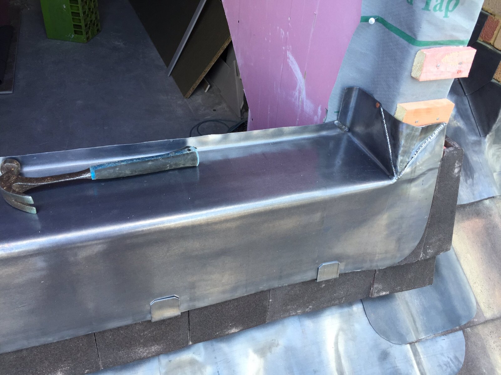

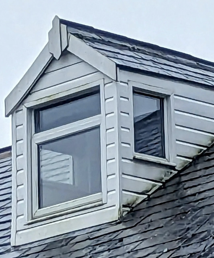

Definitely the bottom board needs to come off to expose the lead tray .
The most important piece of lead on a dormer window .
I doubt there is one .
Don't get confused with the apron .
An apron alone is not enough.
Also take a look at the verge , the overhang varies from some to none .
This will allow water in behind the cladding
