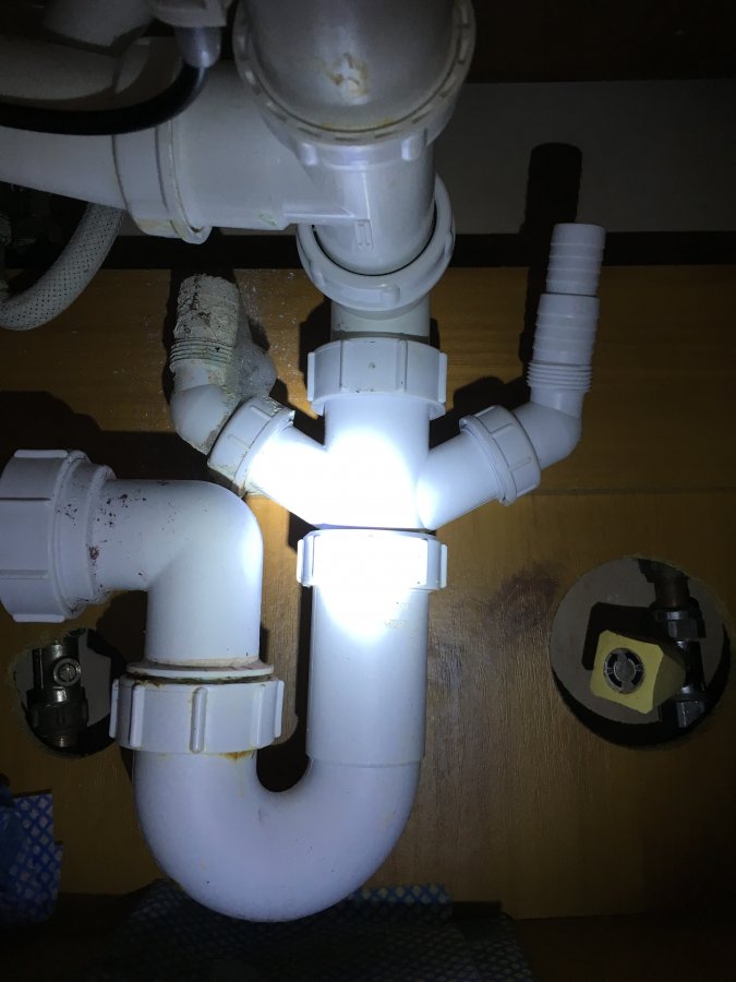

Basically we've had a leak for some time. The water doesn't gush out. It isn't even consistent (it seems), but it does leak.
Anyway, I had another look today after i'd poured the washing up water away & it looks like the leak is coming from that bit that sticks up on the left that looks similar to on the right.
What are these & are you able to tell from the photo what's needed to stop the leak?

Out of interest, does anyone have a clue what that yellow square tap is likely to be?
They are spouts for dishwasher/washing machine wastes. They either need a hose connected which is in use or to be capped off, no wonder they're leaking when left open like that!
Yellow tap could be for topping up pressure on the boiler.

These caps, would they be some universal size? Or do i need to try & get under there with a ruler?
Also what am i searching for when looking for these caps? I don't imagine i'll get too far with "sink caps" :) But i don't suspect they'll have too much of a technical name.
Check out McAlpine plumbing.....MA15 is a machine connection with a blanking plug which should sort you out!

That valve may be the isolator for an outside tap, Is one fitted on the other side of the wall.
Undo the washing machine spigot on the right, it will have a blanking cap in it, that's what you need for the left. Take it to a plumbers merchants and see if they can help
Turn off the yellow tap and see if anything stops working, outside tap etc.
We`ve worked out the Hose connector for a Dish Washer/ Washing Machine, my guess is the Yellow Tap supplies water to the same appliance
