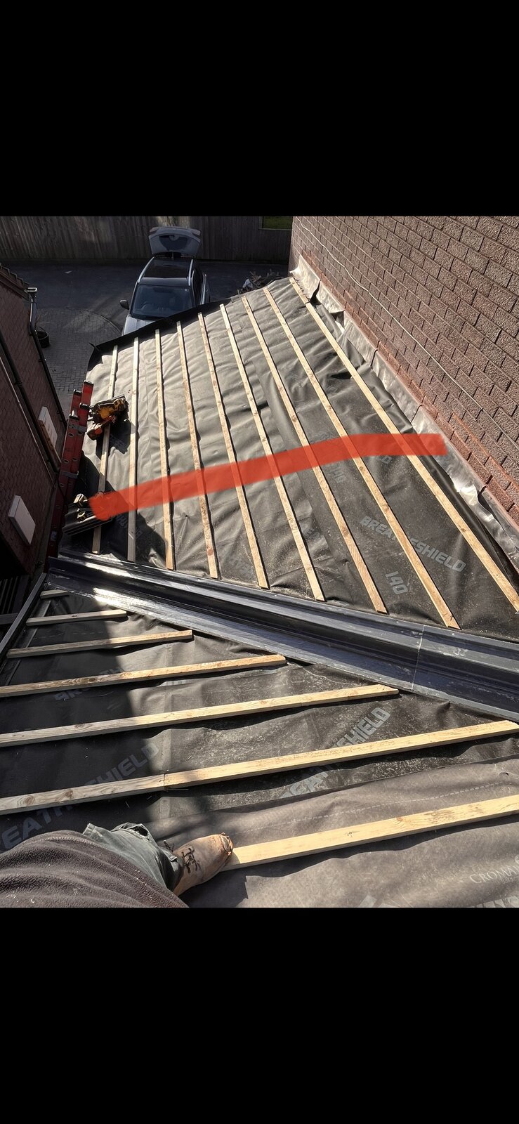

Is that normally the way lead work would be installed? (over to the right)
With it being a single storey extension, is there any way for you to get a hose up there and run water over:
1. the tiled sections without going near the valley or lead work.
2. the valley and run of tiles either side without going near the lead work.
3. the lead work.
A sort of process of elimination, checking for water ingress between each hosing. This 'might' help pinpoint where the water's getting in?
Hi mate! Thanks for the reply. Yes this is a good suggestion which we’ll probably do. Right now the weather is awful so we need it to be dry.
As I said to notch7 - the lead work at the top of The Valley looks like it needs more work, but this part of the roof is in the kitchen. The leak is in the extension so I’m confused as to how it would track that far? Especially over rafters

Hi
Note I'm not a roofer, however if it were me I'd try the water thing. As others have touched on, water can track in weird and wonderful ways inside, so it's outside where you ideally need to pinpoint the issue.
If you do try the water thing, make sure you do the lead work at the wall last, because the water will obviously run down the roof! And leave sufficient time between each water pour so you can hopefully rule each area in/out as the problem.
Need some up to date pics of how it all looks now, it looks like all those photos are during construction? Was a continuous membrane laid beneath the GRP valley?
Hi mate. Yes, The Valley is well felted and all lapped properly. But like I said, The Valley is effectively in the other room. The leak is in the extension? So it’s confusing
Well respectfully if everything had been done correctly it wouldn't be leaking. How about some up to date pics? Might be time to cut an access hole in the ceiling and look inside.
Yes i agree. But our thinking is it’s not The Valley. As I mentioned The Valley is basically in the other room and we are thinking how could water track over 3-4 rafters to get to where it’s dripping from?
