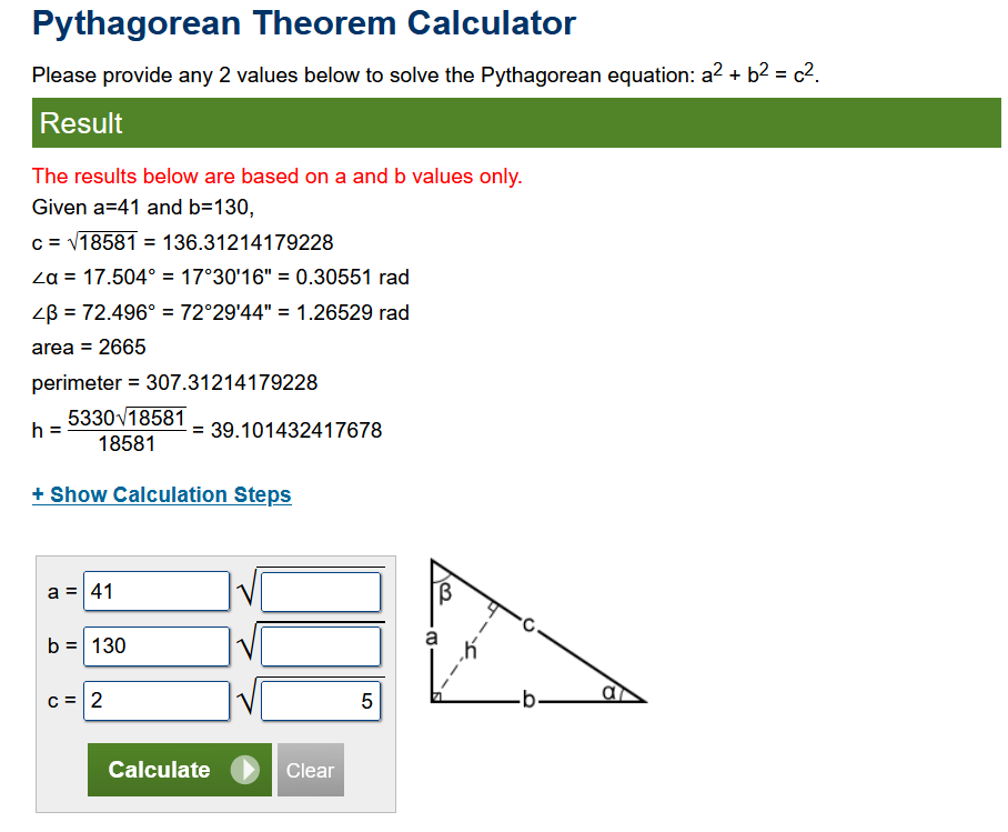

FYI, the pitch is the rafter pitch, not that of the tiles. If the ceiling is vaulted you can measure that.
Thanks!
Taking the above into account and assuming the vaulted ceiling plasterboard is fixed to the rafter above, I have taken a rise measurement of ~41cm and a length of ~130cm. Adding that to a pythogorean calculator gave me approx. 17.5° Allowing for some error then, the roof is borderline under-pitched.
*the figure under "c" was in the calculator by default, not taken into account for calcs above. It results automatically to rafter length of 136cm which I also measured on actual and is about right.
Thanks!
17.5 degrees is the minimum pitch of your tiles provided the headlap is 100mm.
