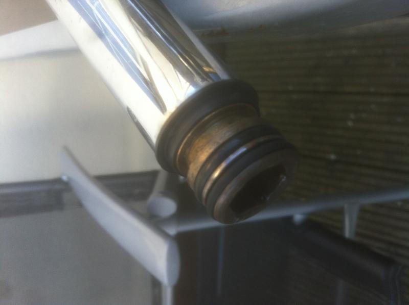

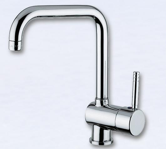

Leaking Mixer tap! help!

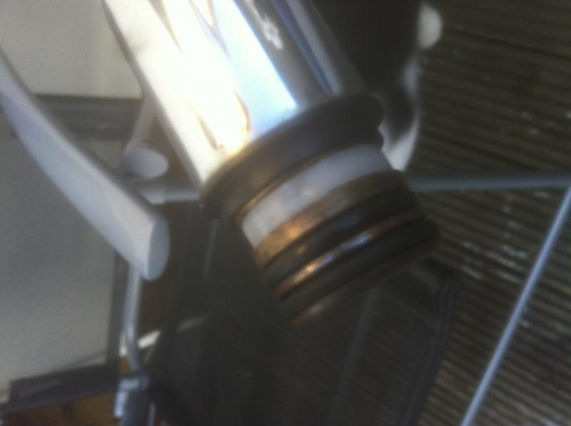

I'd personally give the base a bit of a clean, and fit new rings. It might be dirt stopping a decent seal.

i did clean it and replaced rings but still leaked even worse so put the old rings back on but still leaking
A new cartridge isn't too much so you could always replace it if the cleaning fails.
ok thanks ill have a look at the body....didnt think it was leaking when i took the spout off......ill have a look later cheers
Ah. If it's not leaking at the point where the spout meets the body - you can ignore the o-rings. It'll be the tap cartridges.
So the cartridge goes into the spout?
Theres a big allen key slot at the end of the spout.
