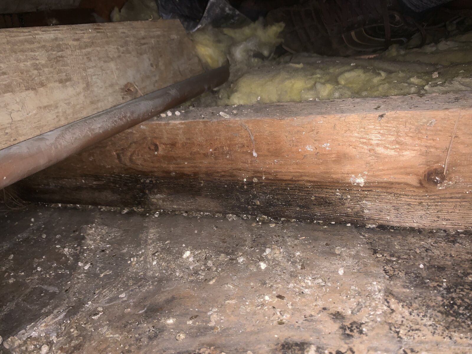

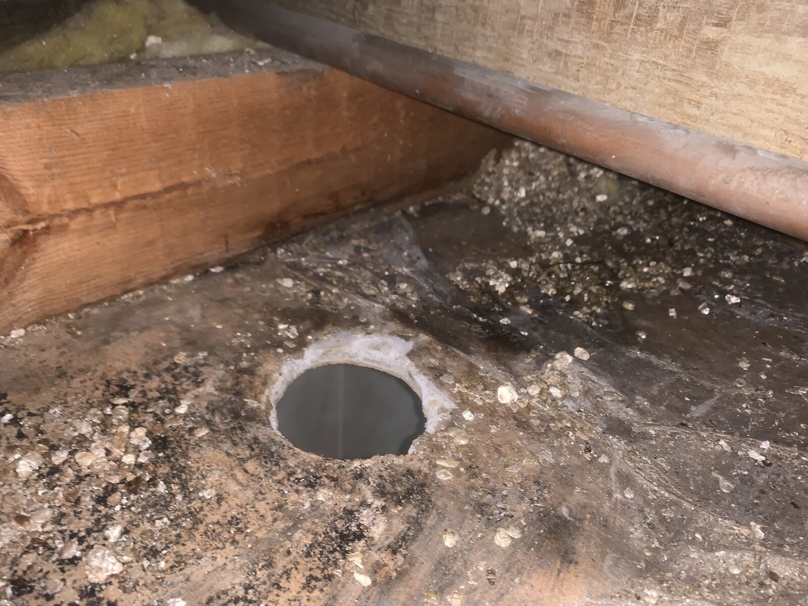

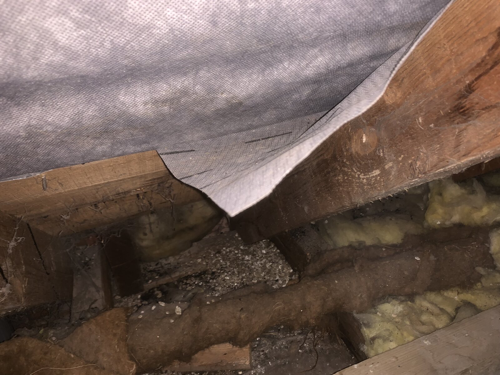

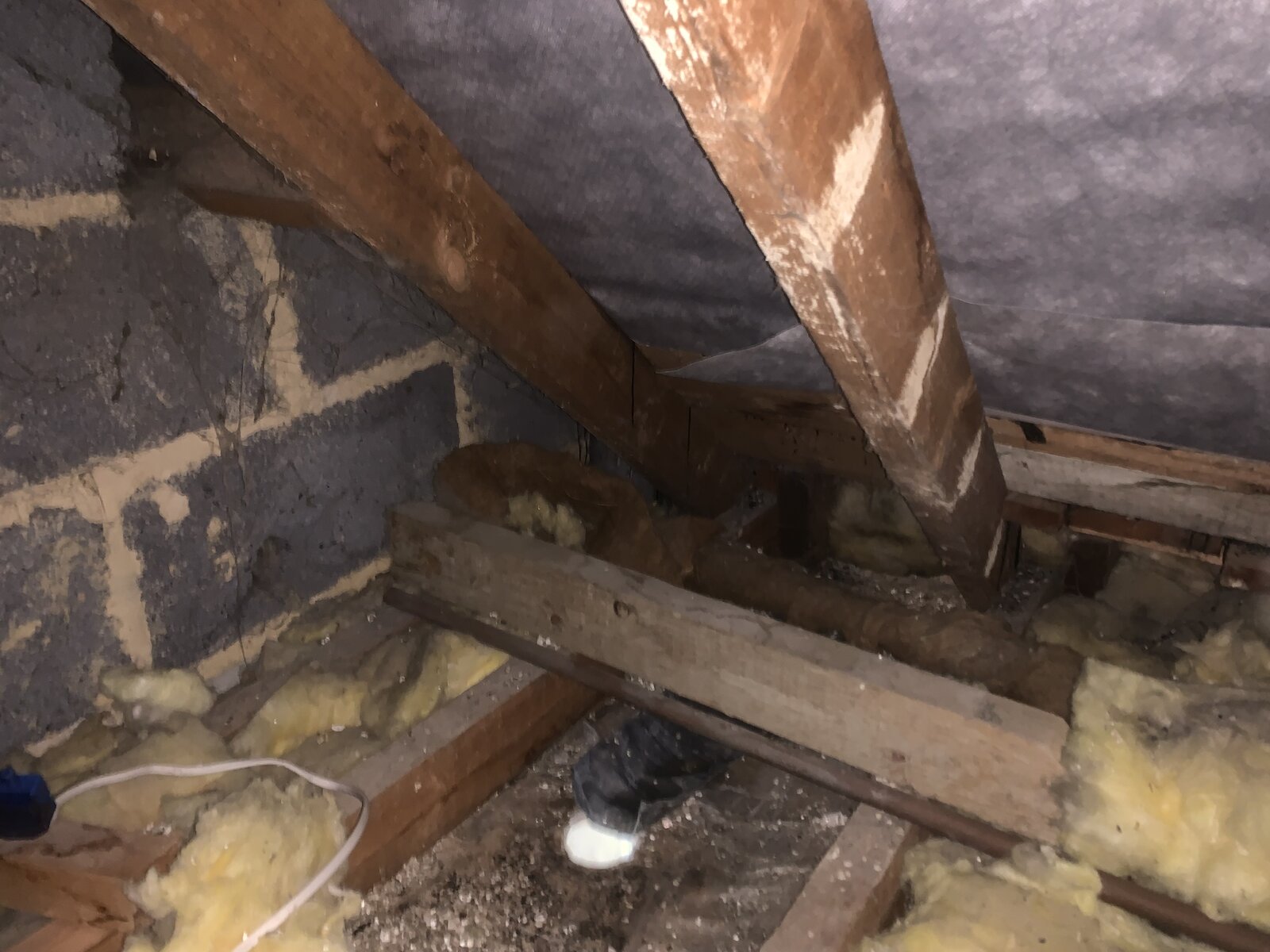

Noticed some water dripping through one of the ceiling lights in our 1st floor bathroom during the last thunderstorm. Have been up in the loft & disconnected that specific light fitting, all the rest continue to work. In the loft above there is a grey papery membrane above the joists & beneath the tiles of the pitched roof; the lower layer of this membrane appears to have been badly fitted; it has a slight sag in it which during dry days seems to contain a tiny residue of water. The sheet of membrane in question is not well attached to the higher layers of membrane at one end & during thunderstorms clearly this sag fills up with water & eventually leaks out of one end down through the insulation onto the plaster board beneath.
Its obviously been going on for some time as when you peel back the insulation & sweep away these odd “shreddies” type lumps that also seem to act as insulation throughout you can see the top of the plasterboard is black from the standing water waiting to drip through the ceiling hole into bathroom below. From the bathroom beneath the plasterboard appears fine & shows no discolouration (yet!).
As a temporary solution I have been able to mould a piece of lead flashing as drip tray in the loft to funnel any leaks from the membrane down through the ceiling hole into a bucket, this works well so far but is only needed during heavy rain, light rain does not seem to drip.

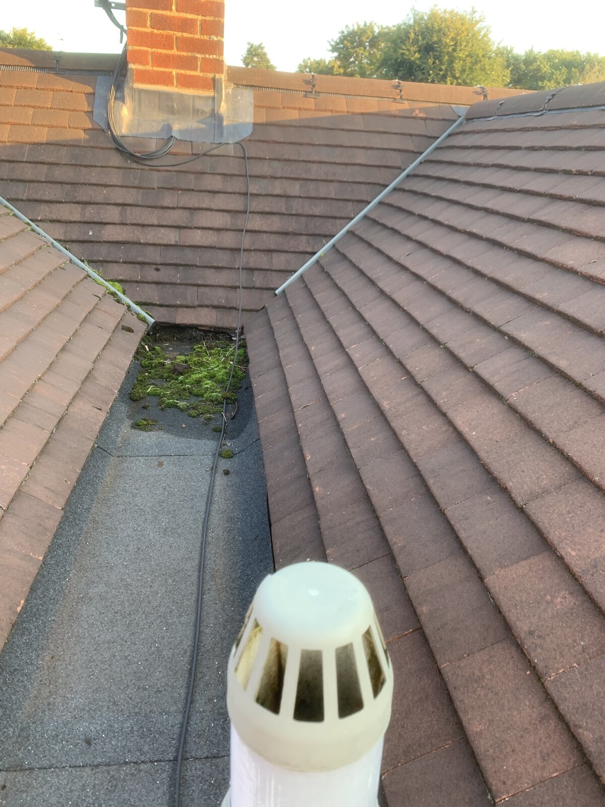

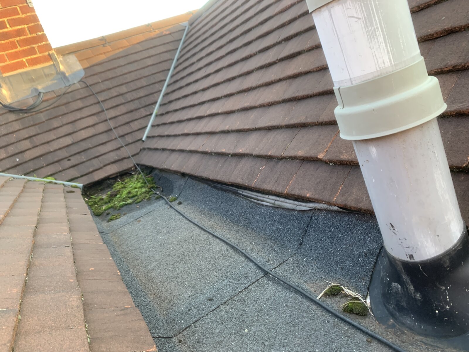

* good idea, @tell80 , went and got myself a ladder standoff today to get a better view. photos of where it is, what i can see on the roof & some grainy polaroids of inside the loft attached. I have plenty more if you need a different angle!
i cant see anything wrong with the tiles from the outside; theyre no better or worse than the other sides of the pitch. the only oddity is the bit of material sticking out from under the tiles & sitting on top of the felt for the small flat roof bit between the two pitches. If that is the same membrane (its badly deteriorated now so hard to tell, but in largely the same space & height on the pitch), then i guess heavy rain could be puddling in it & sinking back under the tiles, pooling in the saggy membrane & eventually leaking onto my ceiling?
Thoughts?
If so, surely trimming that bit of membrane on the outside & tacking the sagging membrane up properly insdie so water cant go uphill should solve it? Or are things never that simple!?!
Thanks again for thoughts / advice
I'd check the weathering slate around the SVP. Press gently around where the felt should be bonded. If water comes out then Likley a leak.. Looks iffy .
Also , bottom of the right hand valley looks to short , take a few tiles out and look for water
