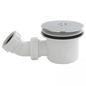

There is the waste under the tray which has the "female" type of thread, it has a rubber ring around the top of it, under the tray, then on the top of the tray there is the drop-in top connector which is threaded and has another rubber ring to go between it and the top of the shower tray
Dad has sealed this part
My hunch is that the part under the tray is not pulling up high enough/tight enough to make a good seal, and as the plughole fills with water, it travels up and over the waste
I'm trying PTFE tape on the thread, and I think I'm getting it right. The whole thing seems to screw quite tight and then pop, it jumps up a thread or two and come loose, so it's a bit of a frig to get it to where you think it's tight enough

this is a similar fitting;
There needs to be a handsome squidge of silicone between the top part of the fitting and the shower tray......if the threads are jumping and the waste isn't fully compressing together, then I'd really go for a new quality waste.

Not trying to be patronising here at all, but these waste fittings are designed to fit all applications rather than your specific one.
Only my opinion here but often any gasket material between the water outlet and shower tray (topside) can get squashed or squeezed, or even let the outlet stand proud of the tray - its something that only can be decided upon on site.
So - a good squidge of silicone it is, so that it squeezes out between the waste and the tray. That is held down whilst you connect the piece underside. Theoretically the ribbed rubber washer is fine (as it shouldn't leak now anyway) but another silicone smear does no harm.
Once you are happy with that, then the two pieces of the waste are fixed together - which should make the first layer of silicone ooze out even more.

I just saw that the silver insert on the top, if you remove the "hair trap", will act as a "key" to tighten the bit below
It seems as though I can get it quite tight with that, perhaps because it's forcing the fitting to stay in place and not jump off the thread?
I'm thinking; bead of mastic around the opening on the underside of the tray (to sort of increase the thickness of the gasket under the shower tray), then thick bead around the opening on the top of the tray, screw it all tight with the silver cover piece, leave it 24 hours then run the shower flat out for 10 minutes and see if I get a leak
