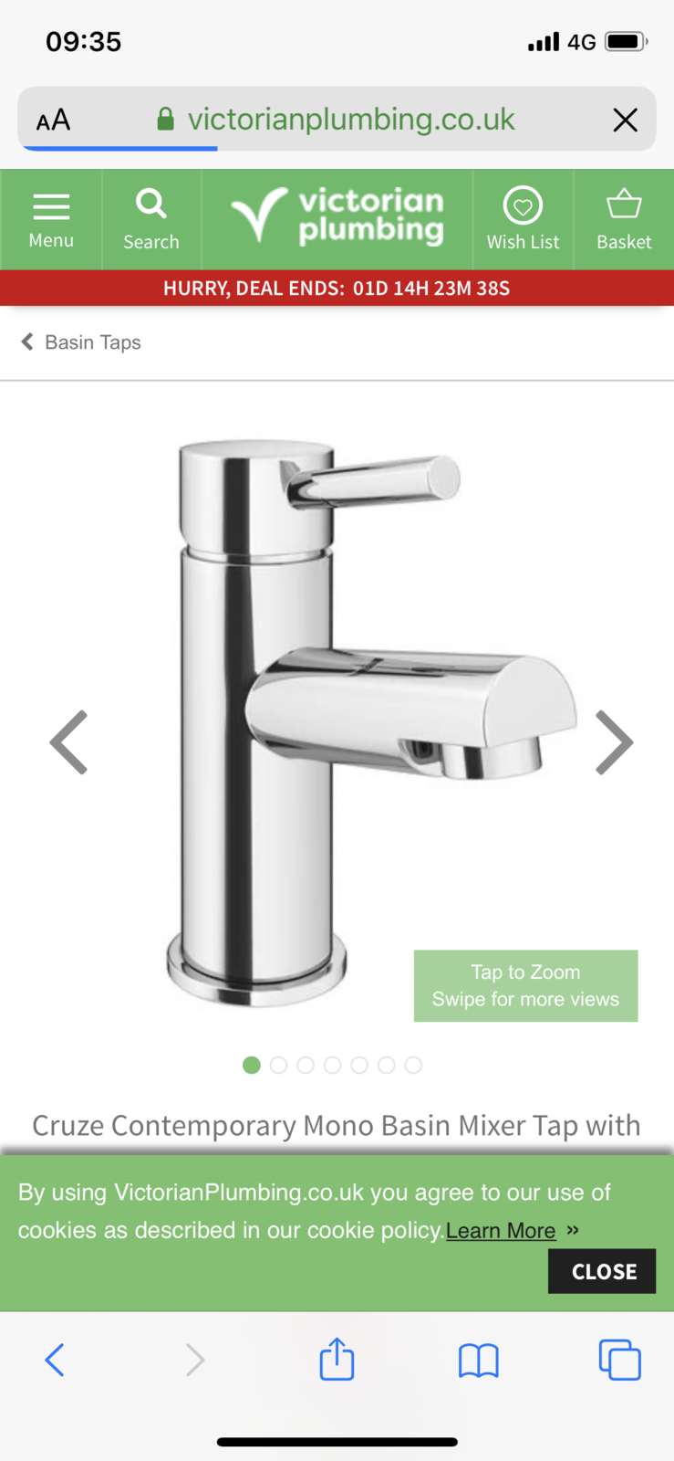

Hi,
Before I fix my leaking bathroom tap as it dribbles.
Do I need to remove the cartridge to replace the washer ?
or would it be best to replace the whole cartridge ( if so is there a standard size?)
There won't be any washers in that, it'll need a complete new cartridge. Don't hold out much hope of actually being able to obtain one though - these unbranded items often have no spares available, and the whole tap usually needs replacing
