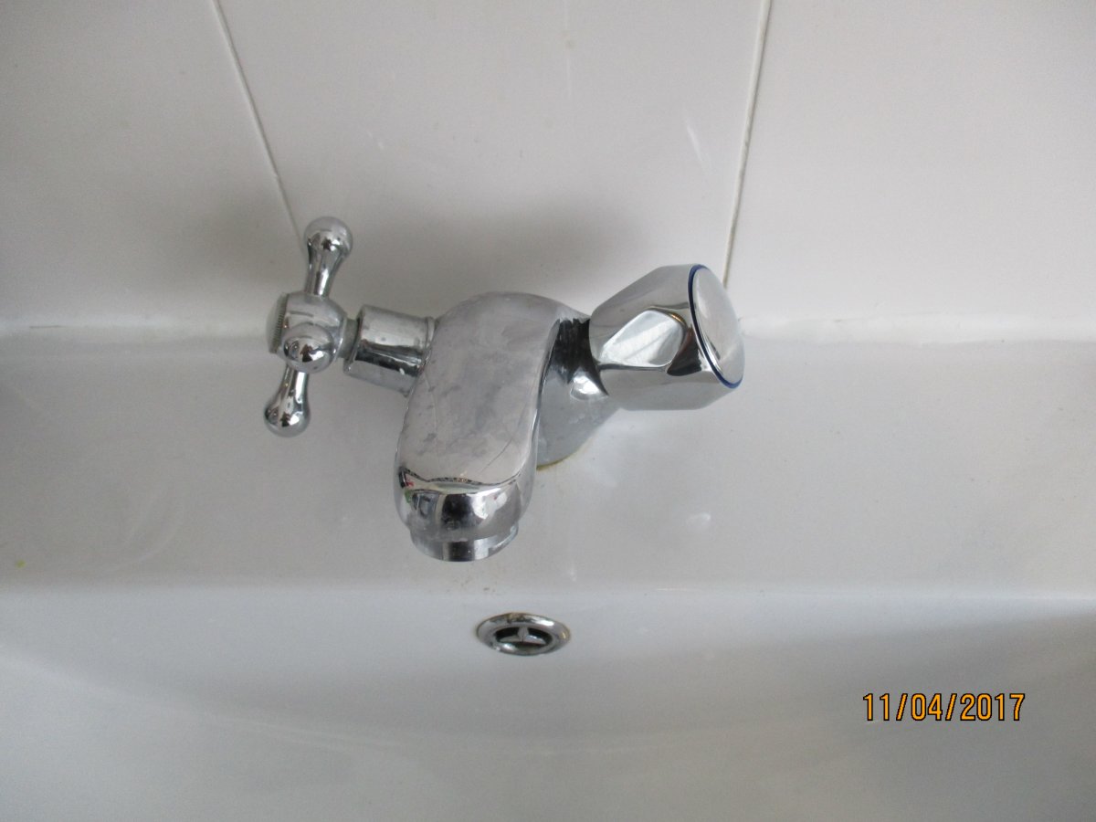

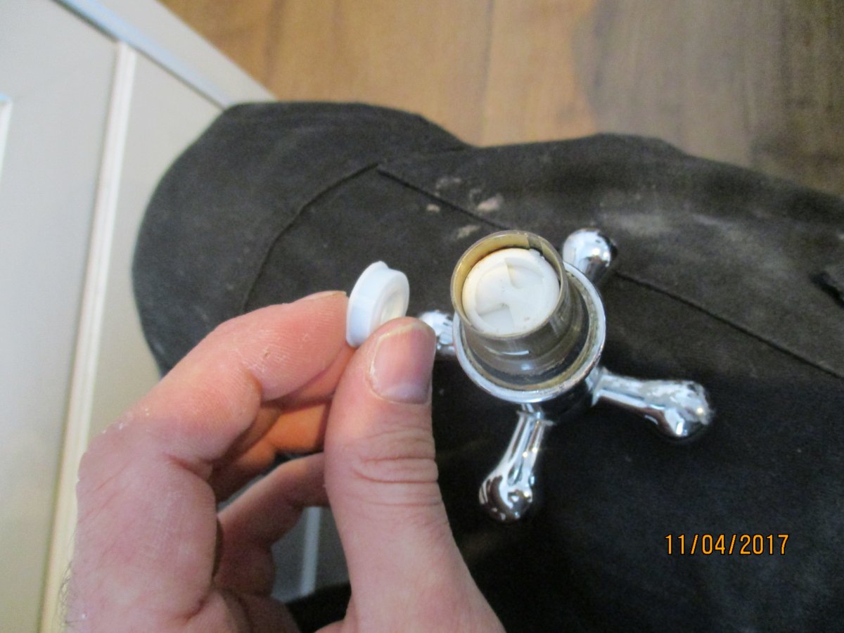

My cold tap is running when shut. I have removed the cartridge from tap but have never replaced this type of cartridge .
Is it just a case of changing that washer ?
Is it called a Delta washer ?

No, that is a quarter turn tap containing ceramic discs instead of washers, you will need a new cartridge.
if you know the manufacturer, then buy the proper thing, you may find spurious ones won't fit.

I was thinking that once I wrote this post. I do not know the manufacturer. I have just put a standard tap cartridge on for now what I had and it fitted on cold and stopped leak.
I have mixer taps matching on my bath and its tiled in. Is there a way to get a match without having to order tap heads for the lot ?

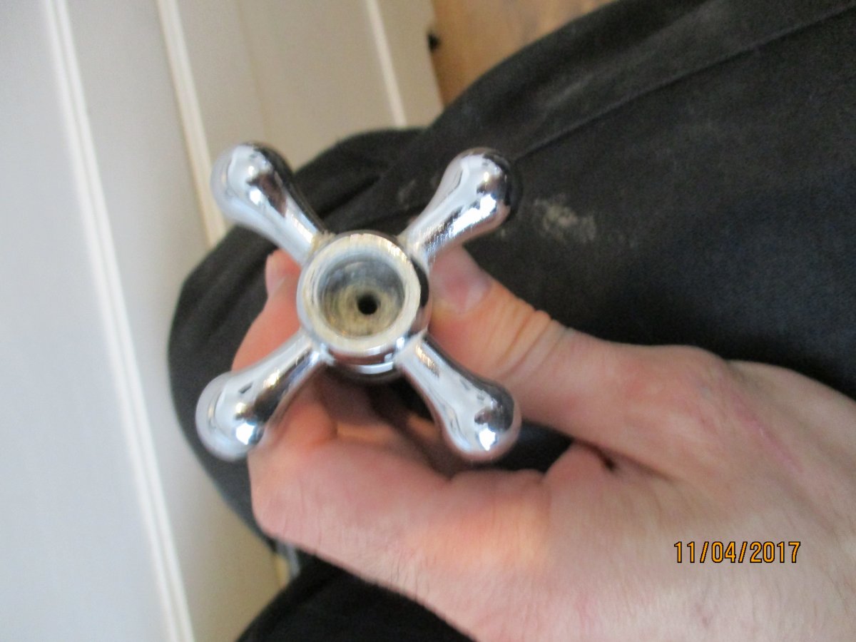

I have also took the screw out the top but cannot release the tap head from the cartridge ?

Fit new taps, it will save time and money in the hope you can find the correct cartridge.
Andy
As above ^^^^^^, its cheaper in the long run just to replace the taps, they come with a years guarantee
