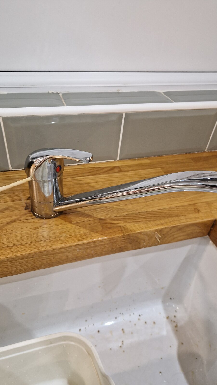

I bought a new kitchen from Howdens about 4 years ago. The tap has started to leak. I’ve pointed to where it leaks in the photo.
How do I get it apart to find the problem?
It is behind a Belfast sink so removing the whole tap would not be easy. I wondered if there is any easy fix for this.
Pull out the red/blue plastic cover. Beneath is a grub screw that a small Allen key ( hexagonal wrench) is used to remove it. The handle will then pull upward and off.
Then show us another pic. Replacing the valve may be needed ,or possible tightening the large nut that retains the valve.

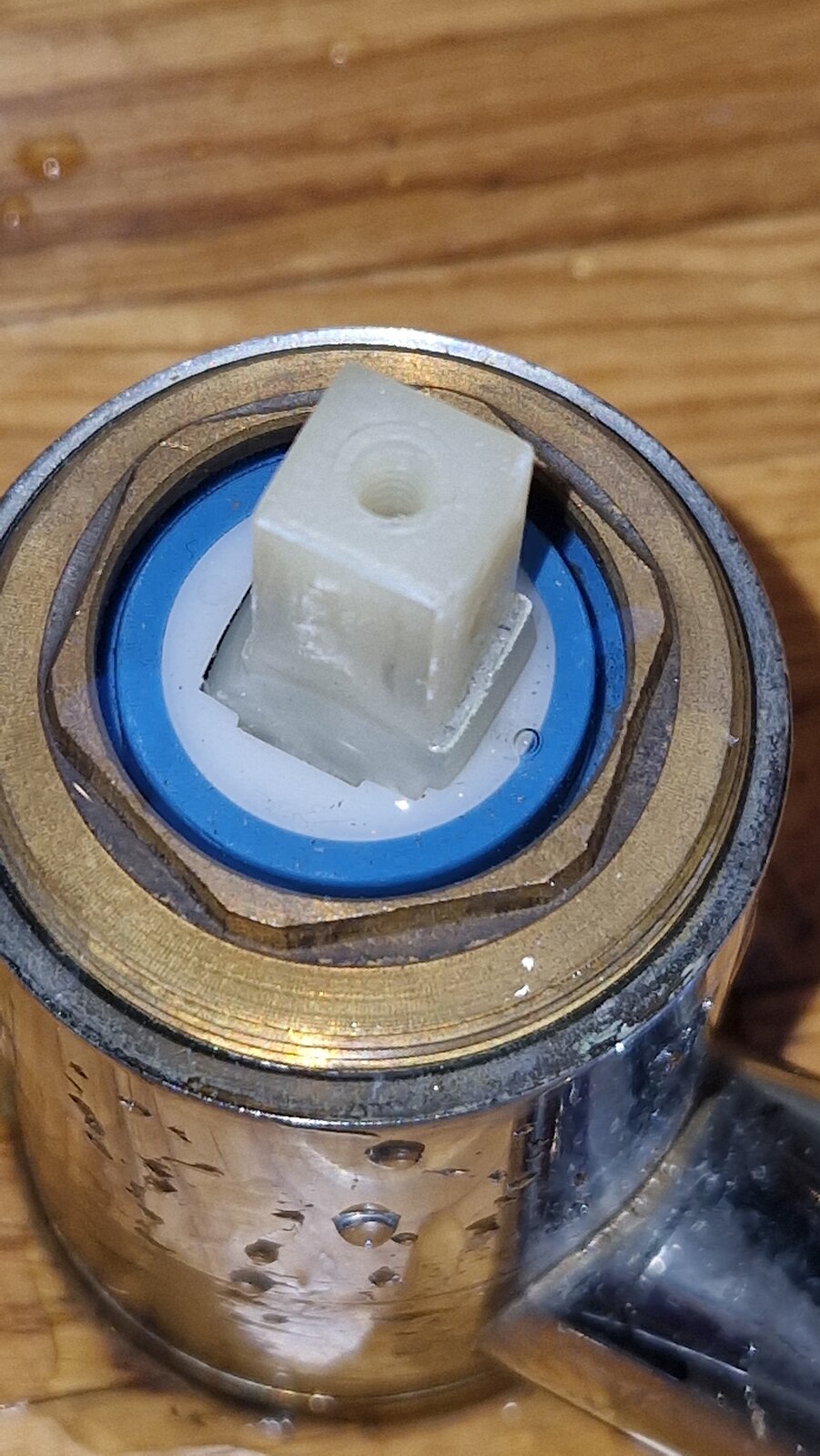

I thought I should update this. I removed the red/blue cover and the grub screw and found it difficult to get the top off as it was really firmly stuck. I eventually managed and found a large nut underneath, I've tightened up that nut and no more leaks.
Thank you very much terryplumb
Another update.
It leaked again so I removed the nut and the plastic unit underneath it. I cleaned the base of the unit and inside the metal tap. It now seems to be sealed properly.
1. If it leaks when both hot and cold are turned off, the leak is from the works you have already tightened.
2. If it only leaks when hot and / or cold are turned on, it is leaking from the point where the spout swivels. Fixing this requires the tap to be removed from the work top. If left, it is likely to rot the work top.
