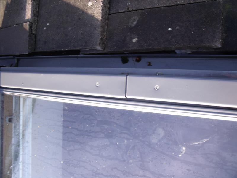

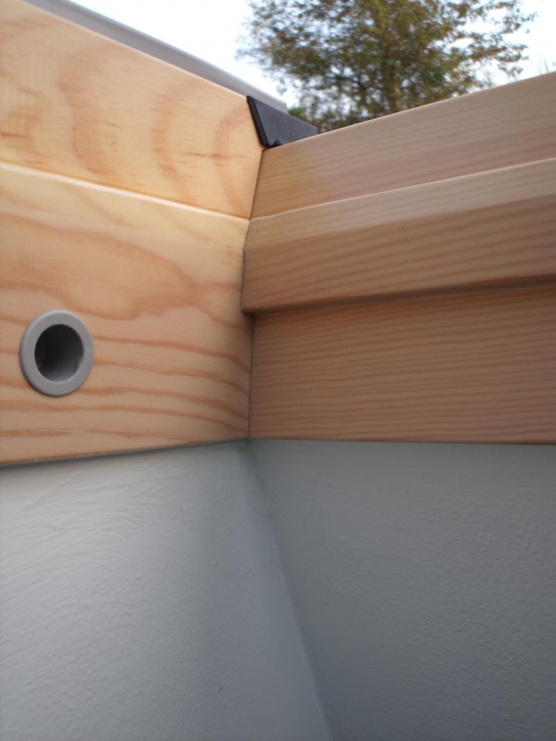

I have a 4 year old centre pivot velux window and has started to rain in .It only happens when it is heavy driving rain .It is leaking in from the bottom left hand corner,When checked further it appears that the left hand side inside framework had water on it,but cannot find how it is getting onto it and making its way down to the bottom corner.
might be easier to give you an answer if you can post a pic of the outside.
The wndow is leaking in the left hand corner
It appear water is somehow getting onto the inside frame and making its way to the corner

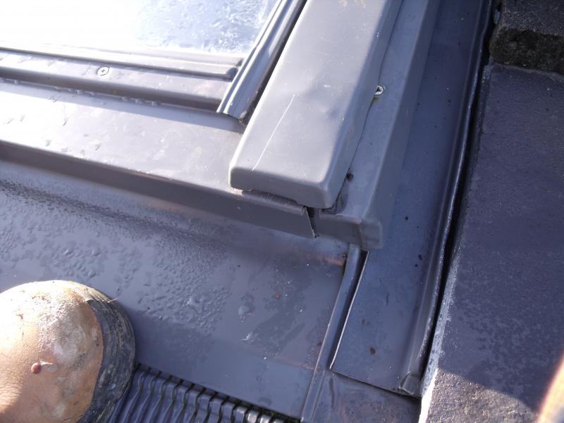

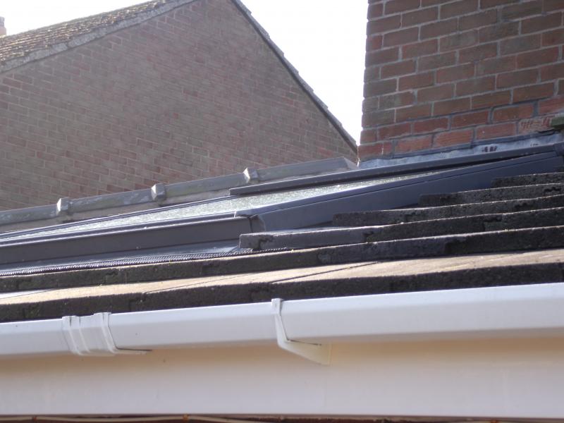

looks like you have rosemary tiles on the roof !it could be the flashing kit for the velux is incorect and has been modified to fit and this has failed you need a roofer to do some digging around up there but get some 1 you trust or a recomend so your not ripped off by a new velux it shouldnt be too expensive but could be trial and error
Marley modern interlocking tiles!

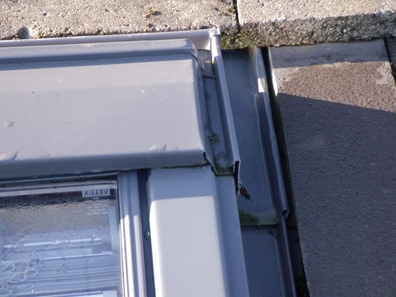

need a pic of the external bottom corner.
Nothing obvious there! i would be inclined to remove the flashing around the problem area to see whats going on.
The water may be tracking down from higher up as well.
It couldn't be the flashing as their is 4 tiles between the top of
The velux and the wall it only rains in
When the rain is driving up onto it

from the looks of the picture the pitch is too shallow for tile. i could be wrong but thats what it looks like.
do you know the pitch?
