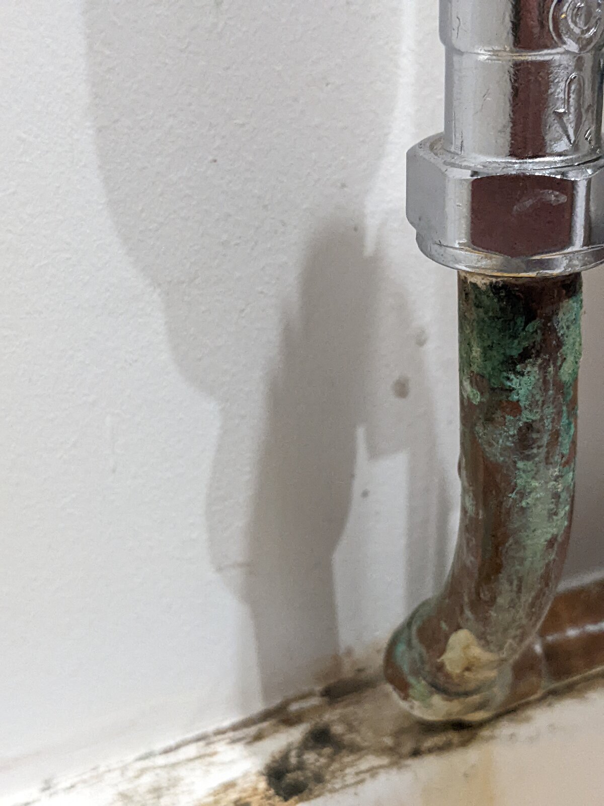

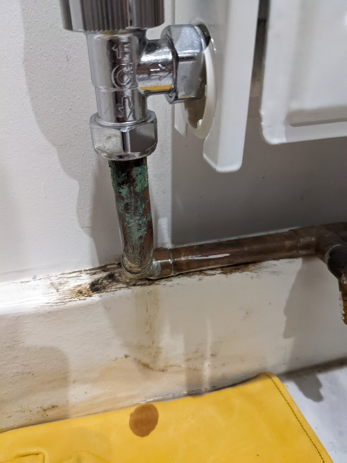

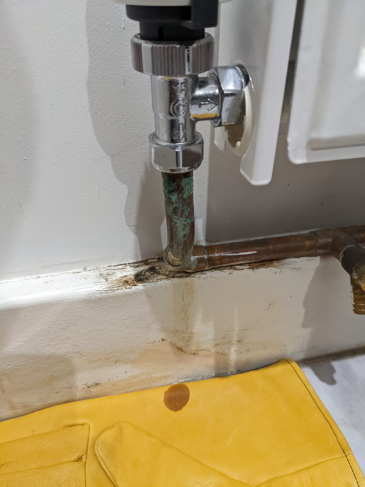

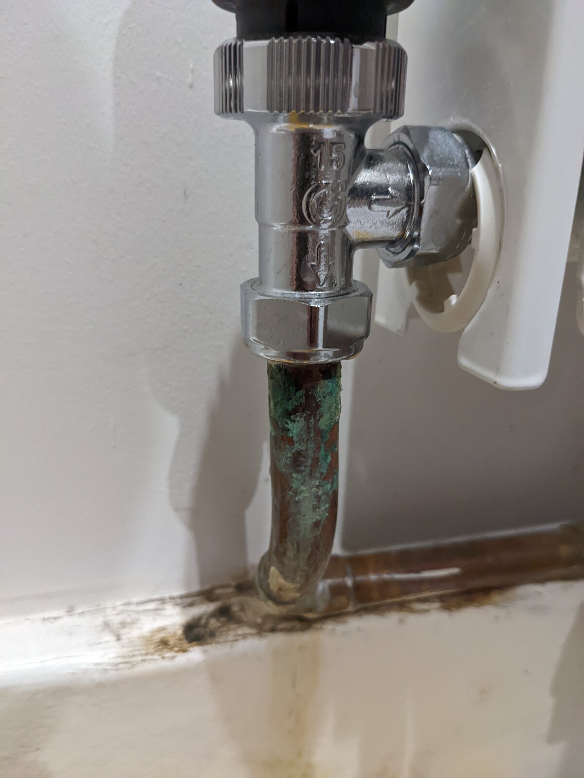

Hi in a new house, seem to have a very small leak looks chronic. Have homeserve but any ideas if can be fixed easily!? Thanks

Looks like it’s coming from the radiator valve (trv) nut, so easily tightened up, no real need for home serve if you can do it yourself.
It can be over tightened, which would make it worse, but a nip up until it stops should be ok.
Tried to nip it up but feels very tight worried I might cause more harm then good, wonder if it's overtight already,?. Any products that I can put on it?
Easy joint for a plumber, see if homeserve will come out tonight or will it be next week?
