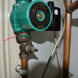

I would be grateful if anyone could offer any assistance.
I have just discovered that my pump is leaking.

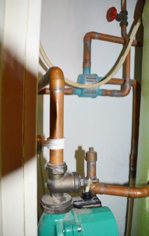

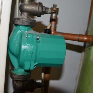

I have included a few image sin the hope that this might make more sense to a person wiser then myself. If you look at image 2 it contains an arrow to show where the pump is leaking from. It is where the curved part meets the body. There is no visible damage, there is a slight recess where one part meets the other which is where the water is coming from.
The heating and hot water are still operational.
Any ideas on how to remedy the issue would be appreciated.
Oops, forgot to mention that the pump is very hot to touch (has been for some time) and the cylinder in the loft has been discharging some water from the overflow pipe.
Not sure if either of these points are relevant but thought I would mention just in case.
Thanks.
You could try tightening the 2 allen key bolts on the pump head otherwise its new pump time. The pumps do get really hot in use anyway. Cylinder in the loft?? I think you'll find it will be a cold water storage tank or a feed and expansion tank, if its overflowing you need to get it looked at..
Close the gate valves to the pump.
Undo the allen nuts from the pump and give the pump
a few taps to break the seal and pump will withdraw.
Apply a reasonable amount of hawk white or similar thread sealer.
To the pump housing seal.
Reseat the pump and tighten down evenly and hope for the best.
Otherwise new pump time.
