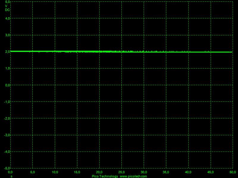

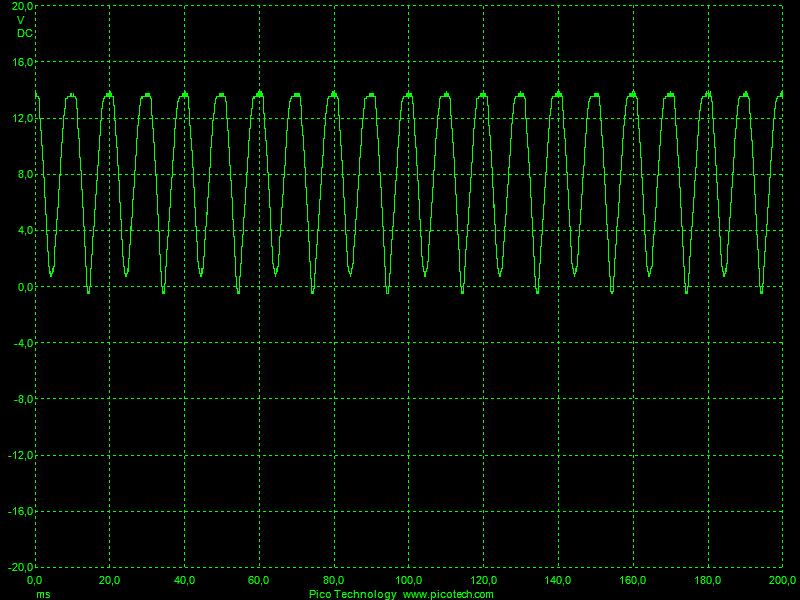

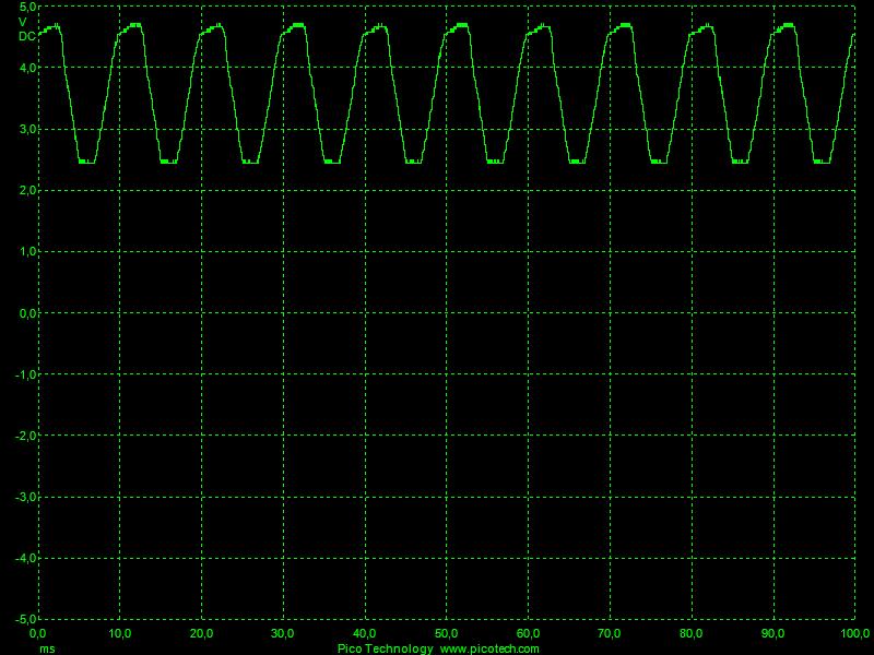

R – It is not easy to interpret the results. Anyway I send you pictures of the data obtained with the oscilloscope.
1.gif – Shows the output voltage from the power supply, disconnected from the anodes&catode. It’s a typical full wave rectified voltage (with some 50Hz hum superimposed). 2.png - Voltage between anode and cathode with the system connected. 3.gif – Voltage on the wall when anodes and cathode are disconnected from power supply.
Q - Regarding possible current variations in the readings due to an unsmoothed DC supply. I did wonder about the effect of an unsmoothed output when I saw it on the oscilloscope. I would expect the output to change once the system was installed but quite how it would I'm not sure, again if I can, at some point I will scope the output with it connected to the system.
R – See curves.

1.gif Shows the output voltage from the power supply
I see very similar on the power supplies I have dealt with. Off load the 100hz rectified sine wave would peak at about the 17volt mark I mentioned.
