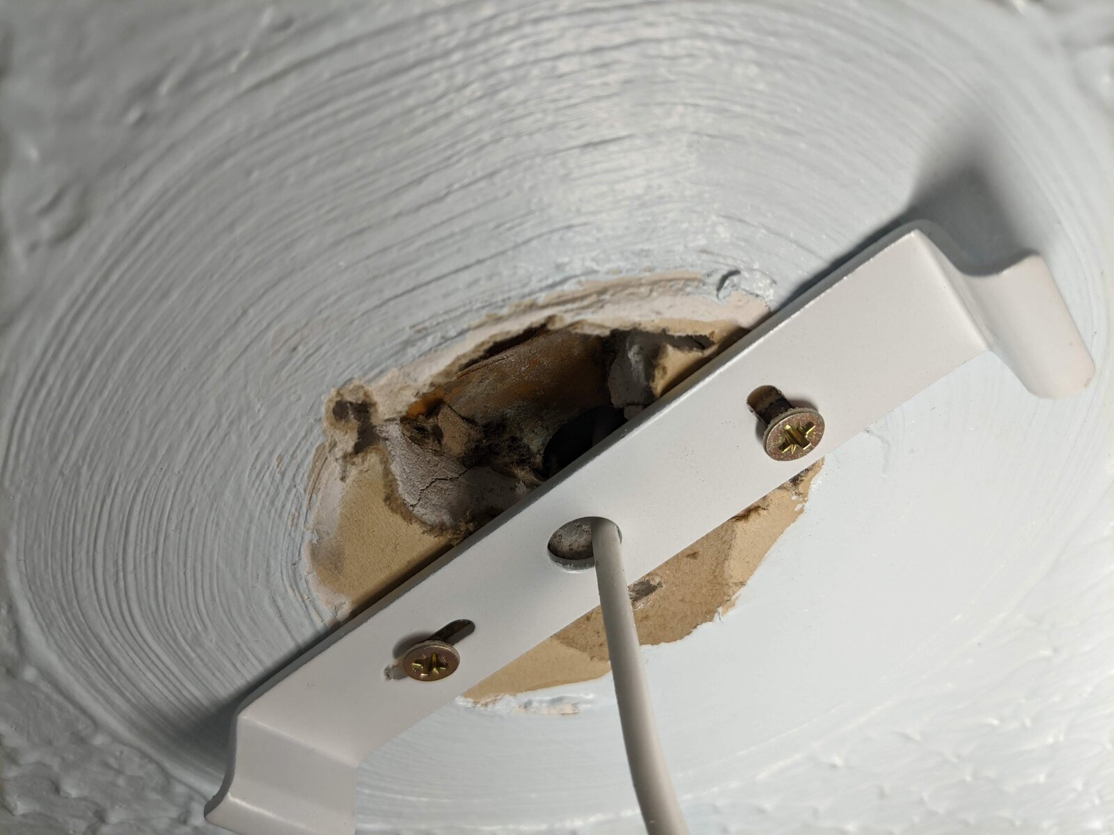

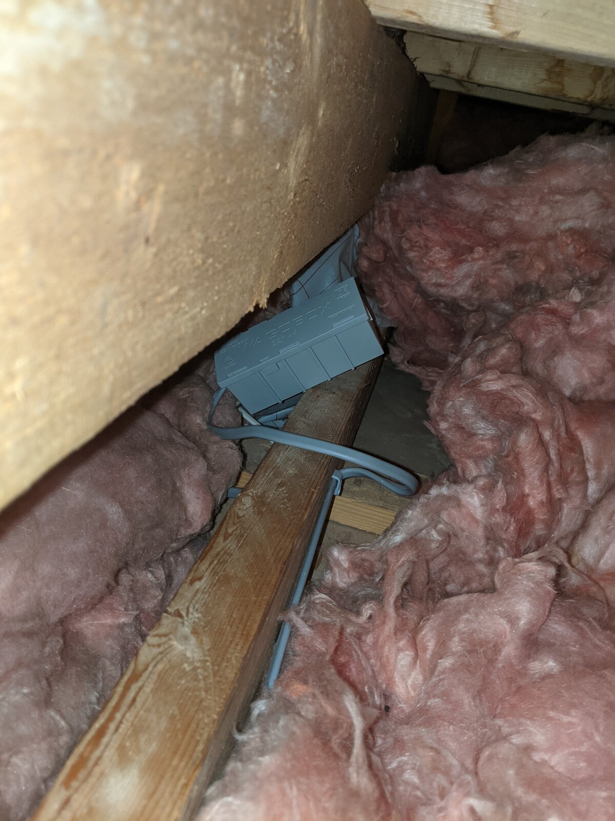

I think You currently have 4 bare wires all bunched together in one sleeve in your rose. They will need to be seperated to go into the wago. So a few inches of sleeving needed.
Cheers. I'll go to my local hardware store and get some in that case.I think You currently have 4 bare wires all bunched together in one sleeve in your rose. They will need to be seperated to go into the wago. So a few inches of sleeving needed.
Read the OP's last post again Risteard. Pics of wiring are the work in progress,prior to fitting the connectors into a wago box.Terrible job. You have unenclosed connections, no strain relief and also no mechanical protection for the cables as the sheath has been removed outside of an enclosure.
