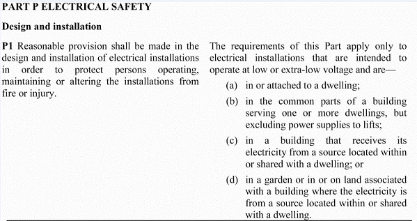

I just need the plinth lights to wire in to my existing bathroom circuit and pass part P.
Not sure what that means, but -
The Building Regulation Part P merely states:
upload_2018-5-15_12-17-20-png.141805
That's it. That's all it states. There is no more.
It applies to ALL electrical work where it applies.

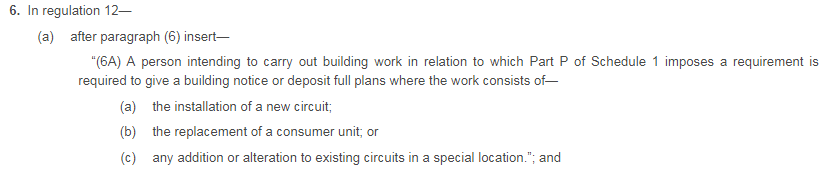

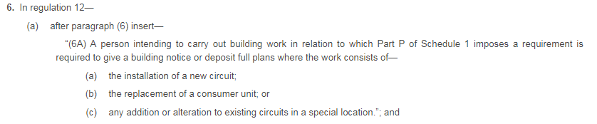

A different Building Regulation - 12, 6 - states that some electrical work (different in Wales) is notifiable to the Local authority.
http://www.legislation.gov.uk/uksi/2012/3119/regulation/6/made
The work you are contemplating falls under one of those rules - 6A(c) - so you must do as Flameport has told you.
Either notify before you start or employ a registered electrician.
