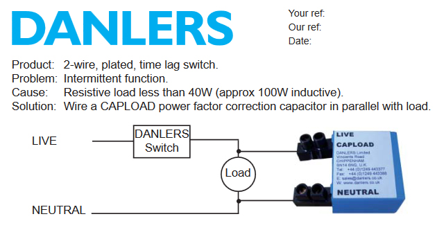

Alternative is this device
Capacitor 0.047uF micro Farads 250 volts AC in series with Resistor 100 ohms
Which come pre-packaged as a contact suppressor from RS Components.
As a contact suppressor it would be fitted between Live and Switched Live at the switch BUT as a snubber it has to be fitted between Switched Live and Neutral at the lamp..
( If there is a Neutral at the switch it may be more convenient ( space wise ) to fit it in the back box of the switch )
RS Stock No.: 206-7869
Mfr. Part No.: PMR209ME6470M100R30
Brand: KEMET
There are other sources

Thanks for your replies guy’s, it’s not practical to re-run the cables to the fitting so will look at putting a capacitor across the light fitting
You will need to research the correct part to fit. It fits at the ceiling rose connection.
