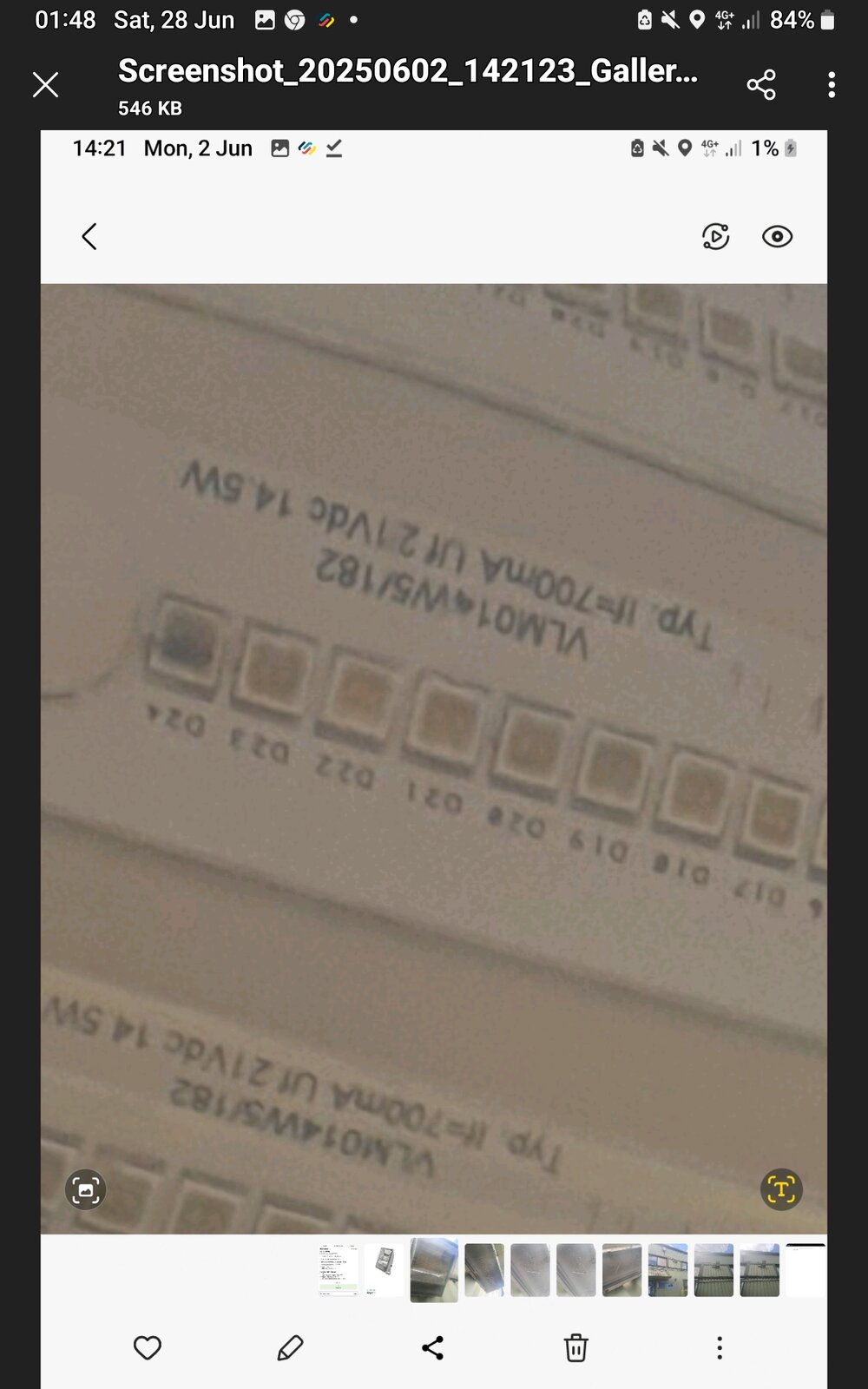

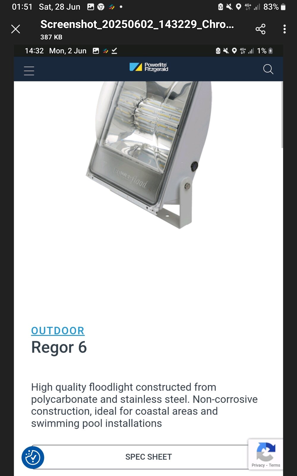

Apart from contacting manufacturer is there a way of telling colour from the attached codes, thanks.
It's a regor 6 fitting

Reading data it's 22K, 27K, 3K, 4K, 5K, 65K .
K = Kelvin
65k is white light
3 and 4k is yellow light.
That light should be adjustable so you can pick the colour you want
Those numbers listed by Wayners (I can't easily read the screenshots) are randomly completely 'wrong' (by the makers not W) but can be interpreted...
65K = 6500 Kelvin and daylight clear blue sky.
5K= 5000K is more overcast daylight.
4K= 4000 k is a 'neutral' white, warmer tones than the above.
3K= 3000K is a warm white and similar to tungsten halogen incandescent lamps
27K = 2700 K is warm white and the colour temperature TV studio lighting is set to to balance the cameras (in days of old). Roughly what a non-halogen tungsten lamp would give.
22K= 2200 K would be almost candle-light warm.
So that fitting covers pretty much the whole range of colour temperatures lamps are available in.
Whether the one fitting can be set to give any CT or if they need ordered in for a specific one might need checking - if important.
Thanks, yes them figures are on the website and it seems you order the colour you require, they are not colour selectable as far i know, because we have had a quote for the 6500k. version
To me it seems 5000k or 6500k but due to access there currently to hard to take one down, the main labels worn out..
I dont understand why they cannot print it on the tape, i assune they make the tape bare and then fit the relevant colour leds on it..
There round a building so matching is important
