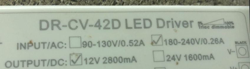

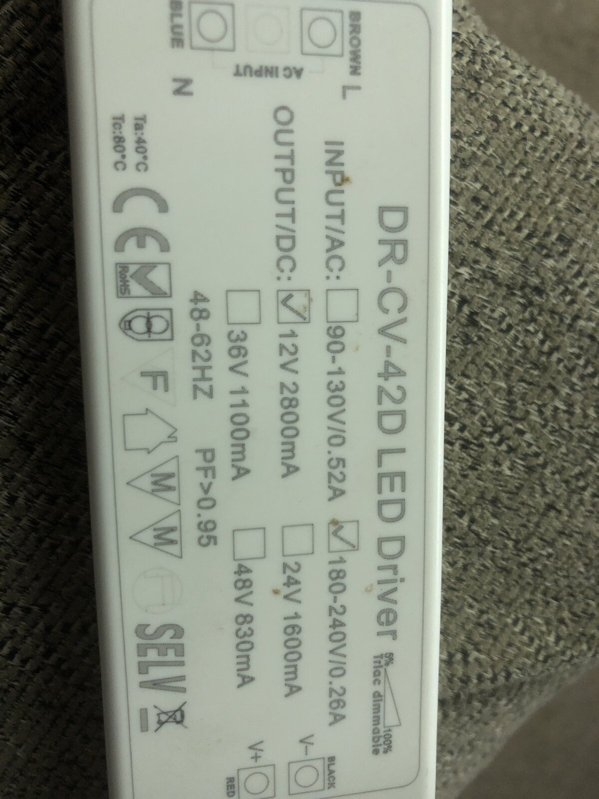

How do I determine the wattage this driver will support at 12v?
Doesn’t seem to give a plausible result ?
34W (max) is quite reasonable.
Although I would want to run it at a bit less than that if used for an extended length of time.
...and typically used to supply LED tapes for example - with a power usage of around 6 to 24W/m for an RGBW tape
Thanks need it to run 24w of led tape so looks ok .

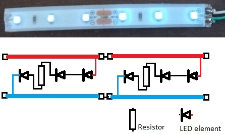

I am being pedantic but this is one place where the correct terminology is necessary
The unit provides a constant 12 volt DC supply. It is not strictly speaking an LED driver
An LED driver supplies a constant current to the LED elements.
Apply a constant ( fixed ) voltage to an LED element without any form of current control will destroy the LED element,
The LED tape has resistors built into the tape to control the current so can be supplied with a controlled voltage.
