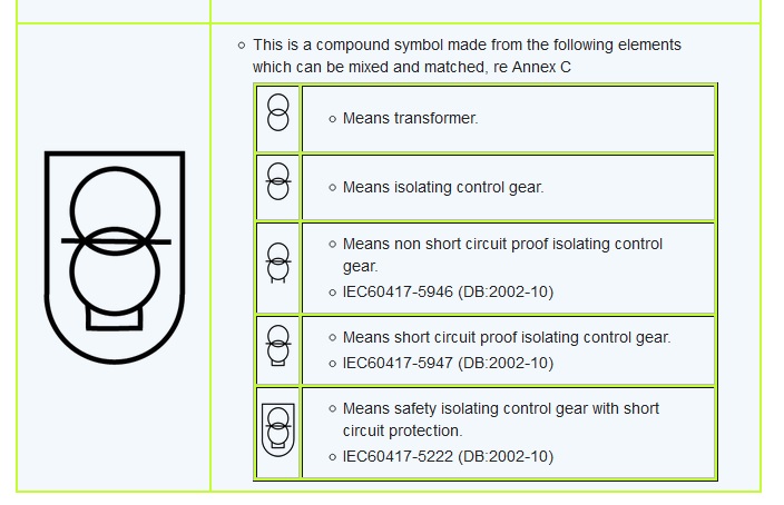

This sign
aMtTLPBtRwkJbjXEOwT5I49qfwoLT5Z22o7wkLU2WprsMkawxleCho3zhtCL4FxFSkc5M0WI2V_256AVoO3Tbw.jpg
means the device isolates and has overload protection so there is not chance of getting 230 volt on the 12 volt output. The are three types of extra low voltage, separated this must not be earthed, protective this must have one leg earthed, and functional this is up to you if earthed or not all know by the letters, SELV, PELV and FELV for SELV you should see the sign shown on the transformer or other device to get power from the mains.
There is also AC and DC with AC standard transformer with give 50 Hz and electronic transformer could me MHz many LED lamps are marked 50 Hz or 50/60 Hz so can't be used with electronic transformers. DC also has rough and smoothed, in general most LED lamps don't need a smoothed supply, there is a tendency to call the units giving non smoothed supplies drivers, although technically drivers are current regulated devices and the 12 volt power supplies are voltage regulated so should not really be called drivers, however they often are.
Strip lights are normally 12 volt RMS DC they can use non smoothed supplies, because not ripple free, there is a problem using them if over 12 volt in some areas, if ripple free you can go to 30 volt in same areas. To use 12 volt when a white LED is 3 volt approx they use 3 LED's and a resistor and that resistor is the real driver, it limits the current, it is often marked so you can cut every 3 LED's and resistor.
Using a 3 ~ 50 volt driver and up to 16 LED's in series with a current limit to match LED's likely 320 mA would use a lot less power, but not as easy to set up. There are 0 ~ 12 volt at 320 mA true drivers, so you really do need to read the spec.
I think the LED strips can decorate well, but I would not select them for general lighting. I look at them in the same light as Christmas tree lights.
Sign as bottom right on the transformer you have. Two circles overlapping, little box shows overload protection.
