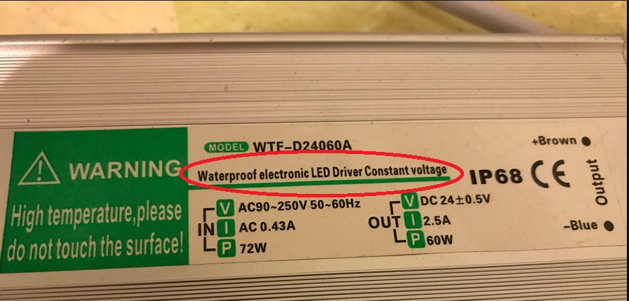

Hi,
I have a double pole light switch which is wired to a twin and earth 2.5mm cable. I want to connect an led driver to this cable.
The driver is a dimmable driver, so at some point I may change the switch to a dimming switch but not to start off with.
What would be a sensible way to connect the cable and driver together?
Would something like this be ok...
https://www.saving-light-bulbs.co.uk/led-ceiling-lights/junction-box/3-pin-push-fit
The cable and driver will be kept above my kitchen cabinets.
You're sure that that is how dimming is controlled?
BTW - ignore any tw@s who pop up banging on about what a driver is, or is not.
It was purchased as such, but now i'm wondering about that.
Here's a picture of it:

That type of driver tends to use a further box between the output and the leds to do the dimming, that extra box is not usually something that can be controlled by a standard mains voltage dimmer
