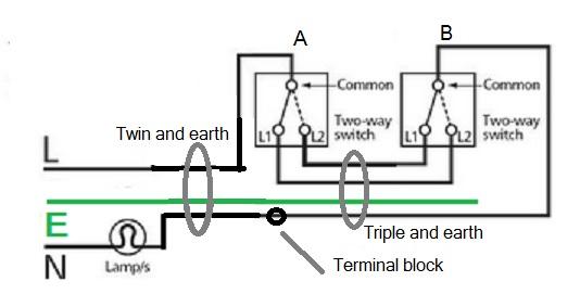

I was looking at this problem myself and realised the grey is separated from the brown and black by the earth wire in standard twin and earth. So with two way lighting there is less likely hood of transfer in the grey is permanent line and the brown and black are switched line.
Clearly it will not be possible to arrange this if any intermediate switched are used.
Unfortunately I have intermediate switches so have been unable to test the theroy. I would be interested to know if the theroy works.
That's true - but, with the 'modern' way of doing 2-way switching, it will only be true in one of the two possible 'off configurations' of the switches. With the other 'off configuration' the brown or black (as well as grey) will be 'permanently line', hence there would be a 'permanent line' adjacent to the conductor feeding the lamp (with no intervening CPC/earth conductor).
This may well, of course, explain the OP's observation that he only got the LED glow (when switched off) if they were switched off with one of the switches, but not when switched off by the other switch.
Kind Regards, John
The capacity between Live and Switched Live determines how much current flows when the light is OFF
Which ever way the switches are set to OFF ( both to L1 or both to L2 ) the Live and Switched Live run side by side in the two strappers so that capacity is the same for both OFF states
This capacity has to be added to the capacity between the returning Switched Live ( below the Earth in the diagram ) and the two strappers
The difference in capacity between the two OFF states depends on whether the strapper closest to the returning Switched Live is connected to the Live or the Switched Live.
When switch A is on L2 the live strapper is closer to the returning Switched Live than the other strapper which is live when switch A is on L1
