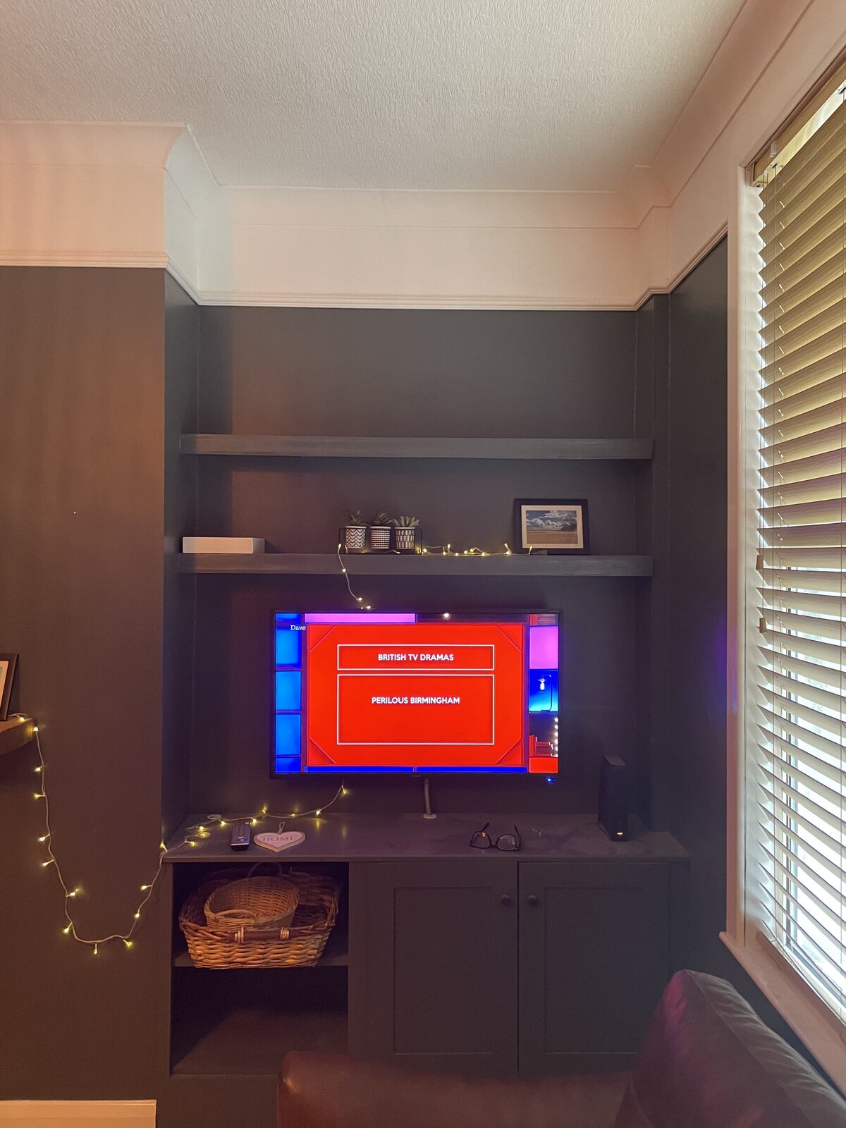

Hello. I am planning on installing strip led lights under each of these shelves. I am purchasing this:
https://tinyurl.com/3nw5f4z9

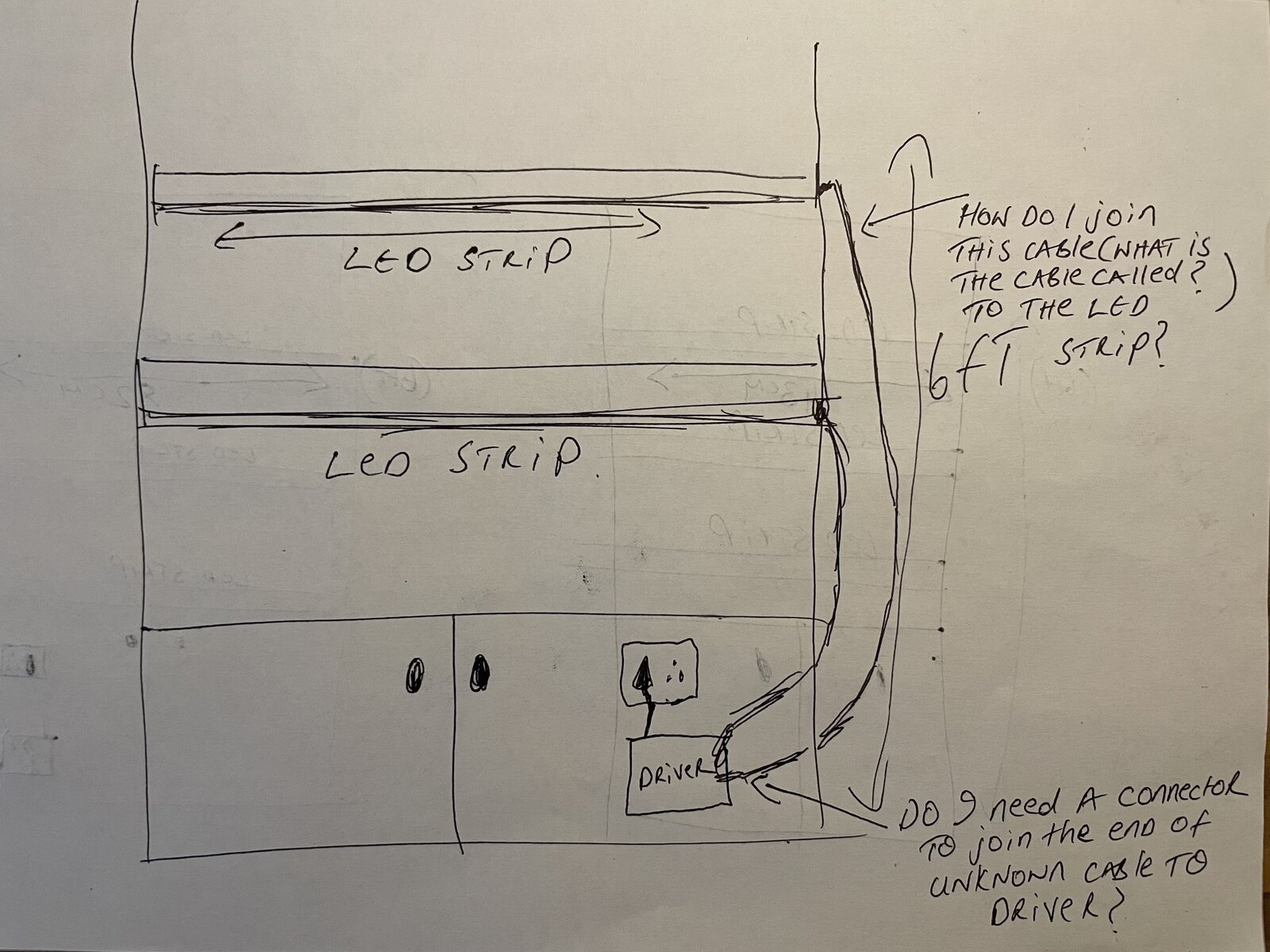

Problem is I have no idea how to connect the end bits of the strip in order to run it down the wall and connect it to a driver (I think it’s called a driver). I have attached 2 photos. One of the actual shelves and a bad drawing I did with arrows pointing to what I mean. Any help would be great. Thanks in advance.

The usual method is to cut the led strip to length (can be cut every 3 LED's), and then solder on wires to the end.
However, if you haven't got the tools to solder, there are connection kits available:
https://www.amazon.co.uk/3528-Pin-LED-Strip-Connector/dp/B07TB6G816
Or look up led strip connectors (2 pins for same colour LEDs and 4 pins for multicolours)
Normal caveats, check size and type before buying!

Thanks and will that kit have the connection to connect to a driver?
It really depends on the driver!
Many have screw terminals and you just strip the wire and screw them in (minding polarity of course!)

Personally I would use the connectors as mentioned above.
Regards the transformer the wires usually screw in.
I wouldn't bother trying to solder the strip lights, most are of poor quality and the solder either doesn't stick very well or the strip melts etc etc.
Use 0.5mm twin core flex and use the colour system brown for live and blue for neutral/negative
For the transformer use the same colours and get a 3 pin plug to connect the 230v side of the transformer.
No need to worry about an earth in this application in the 3 pin plug

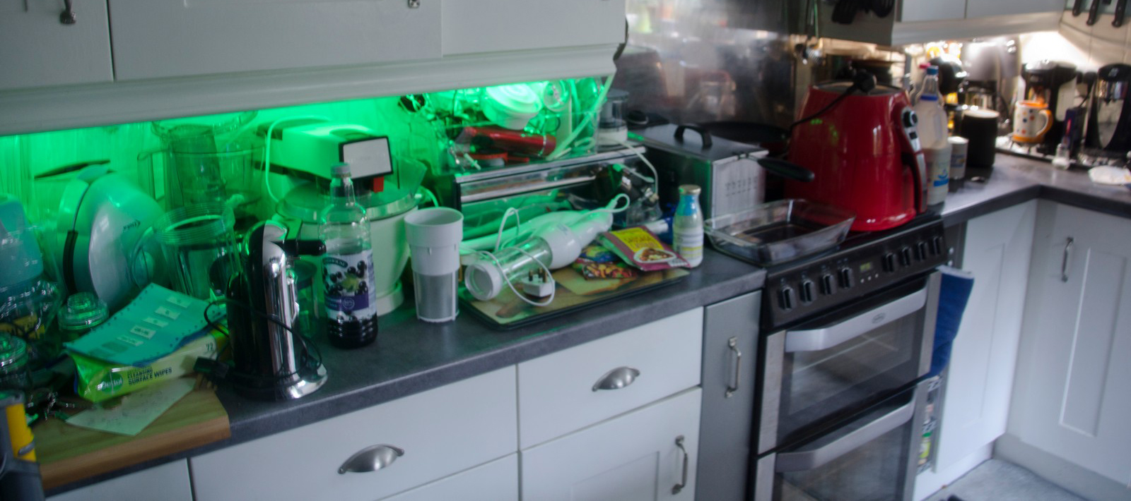

The warm and cool white settings on the Lidi unit are two independent LED's, and the control allows you to vary the output of the LED's but in a way that the total power does not exceed 2 amp, (22 watt) there are 6 connections I would assume return, cool, warm, red, green, blue but I simply plugged it in and used it, in the kitchen it goes around in a circle under the cupboards to light the counter top, DSC_5238.jpg there was enough space to hide the power supply and controller.

The kitchen strip is held with large cable clips which were pushed in rather than hammered using a pair of water pump pliers. Sticky back does not last I have found.

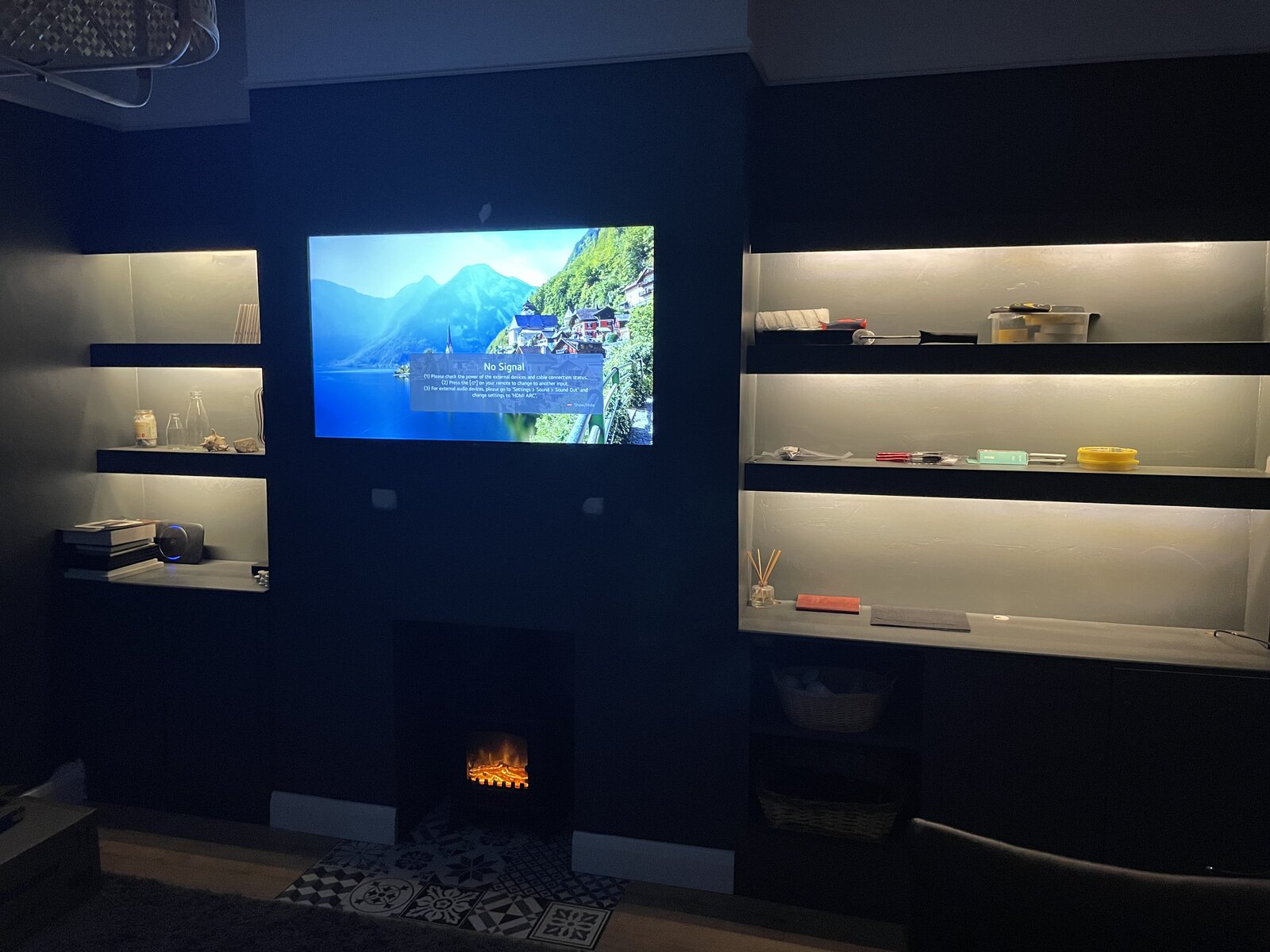

Cheers. I got some new bits of MDF cut for the front so there is a slight overhang and used This stuff to fix the light strips behind. The strips I got are backed with plastic and they are bonded extremely well with the adhesive. Room is still a work in progress but happy with it.
